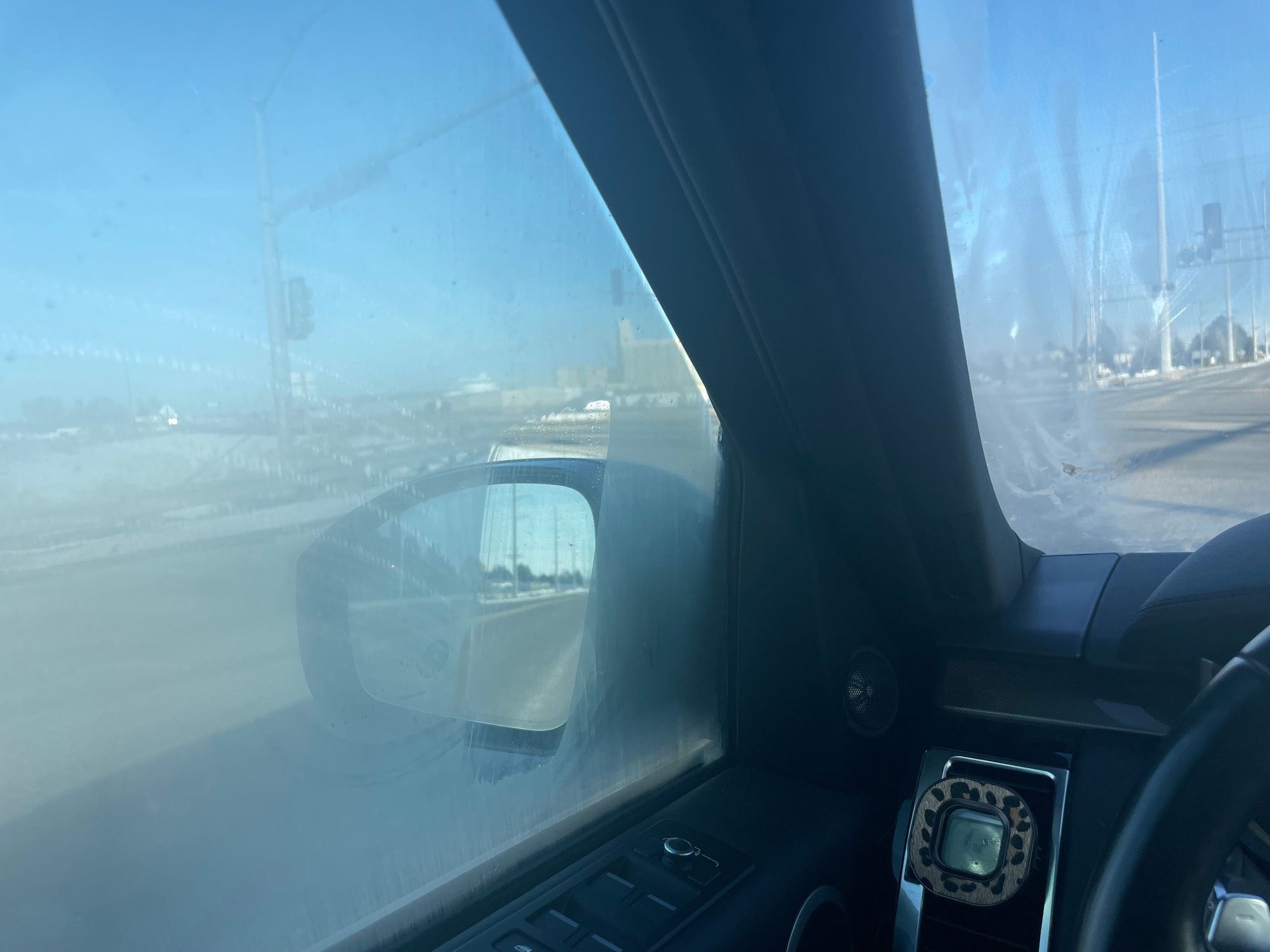

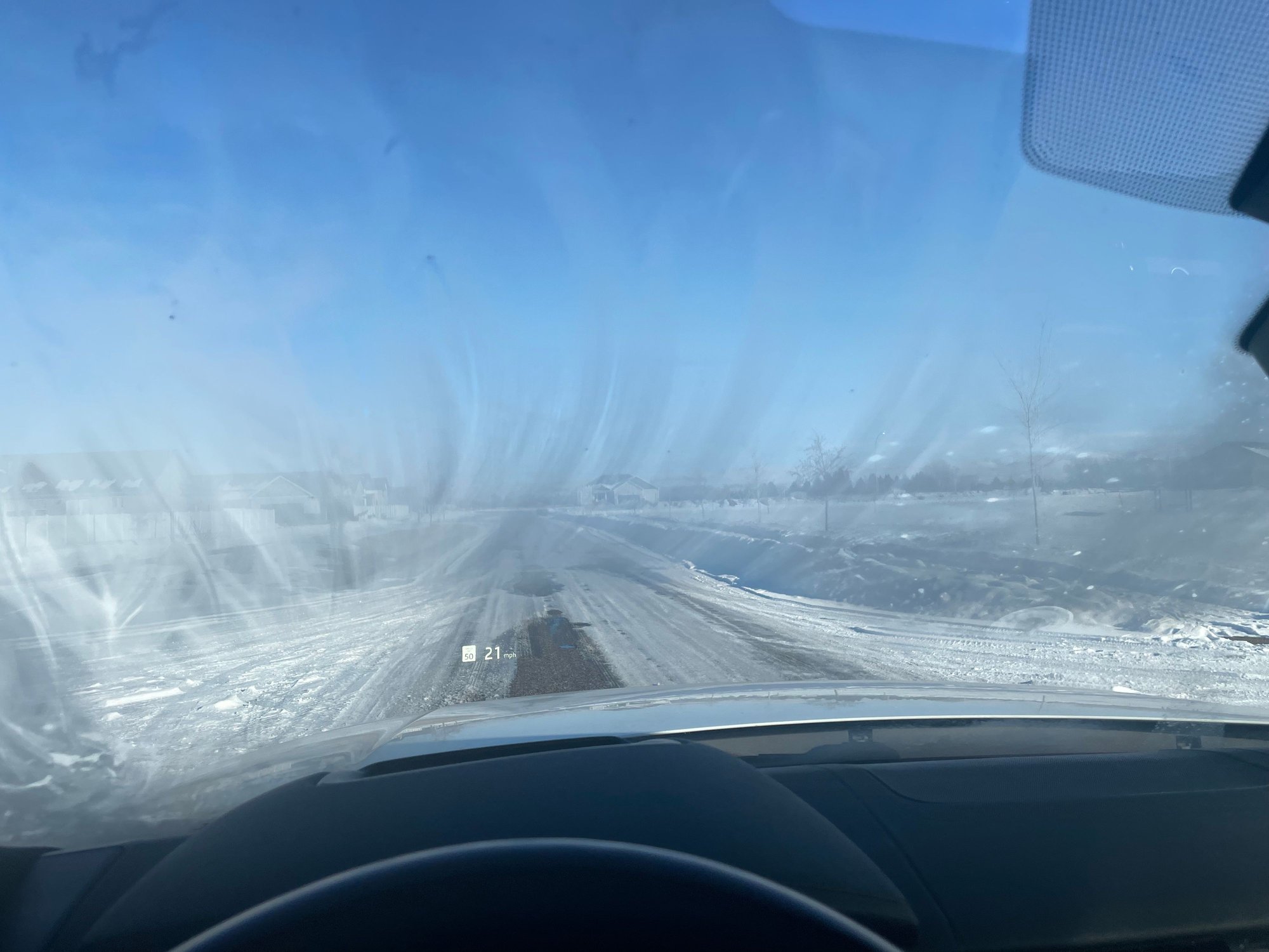

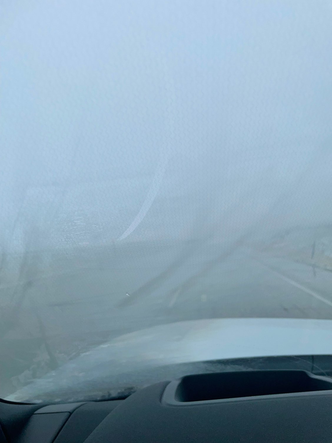

There was a recall due to the front windshield not being properly sealed. so Land rover covered the cost of a new windshield and labor.
we had issues where the entire inside was fogging up and then freezing in the winter. These pictures show how bad it was. Since that fix, zero issues. my uneducated understanding is that the blowers reach everywhere enough and move the air accordingly - but with the additional moisture getting inside from the car from the windshield, the system couldn't keep up.

Thanks Idahoman! Appreciate you shared pictures, that is what my screens look like everyday. I don`t know how you got the info from Landrover - i have certainly not received it. But bought the car second hand and guarantees is surpassed. Being a brit and all...i will trade the ****ty Coventry in :-)
