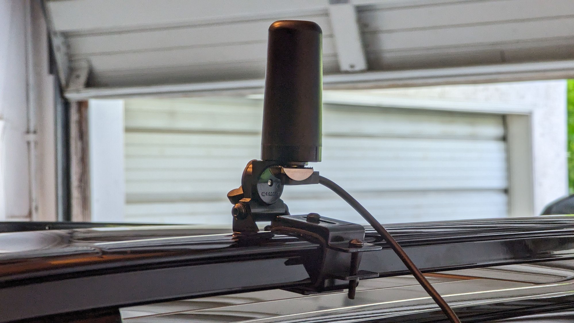

Old Jun 29, 2023 | 08:32 PM
TDD's Avatar
TDD
Joined: Apr 2023
Posts: 15
Well. Worked out ok. That DX engineering mount feels plenty sturdy with MXTA25.
Old Jul 1, 2023 | 12:55 PM
Donc98's Avatar
Joined: Dec 2021
Posts: 121
Likes: 61
From: Texas
Looks good. I ran a similar type of mount for a CB antenna on the back of my LR4 for a number of years. Worked well except at highway speeds. It would always start falling backwards and would need to be tighten again at the end of the trip. You are running a ghost antenna that is close to the roof line so hopefully you wont see the same issue.

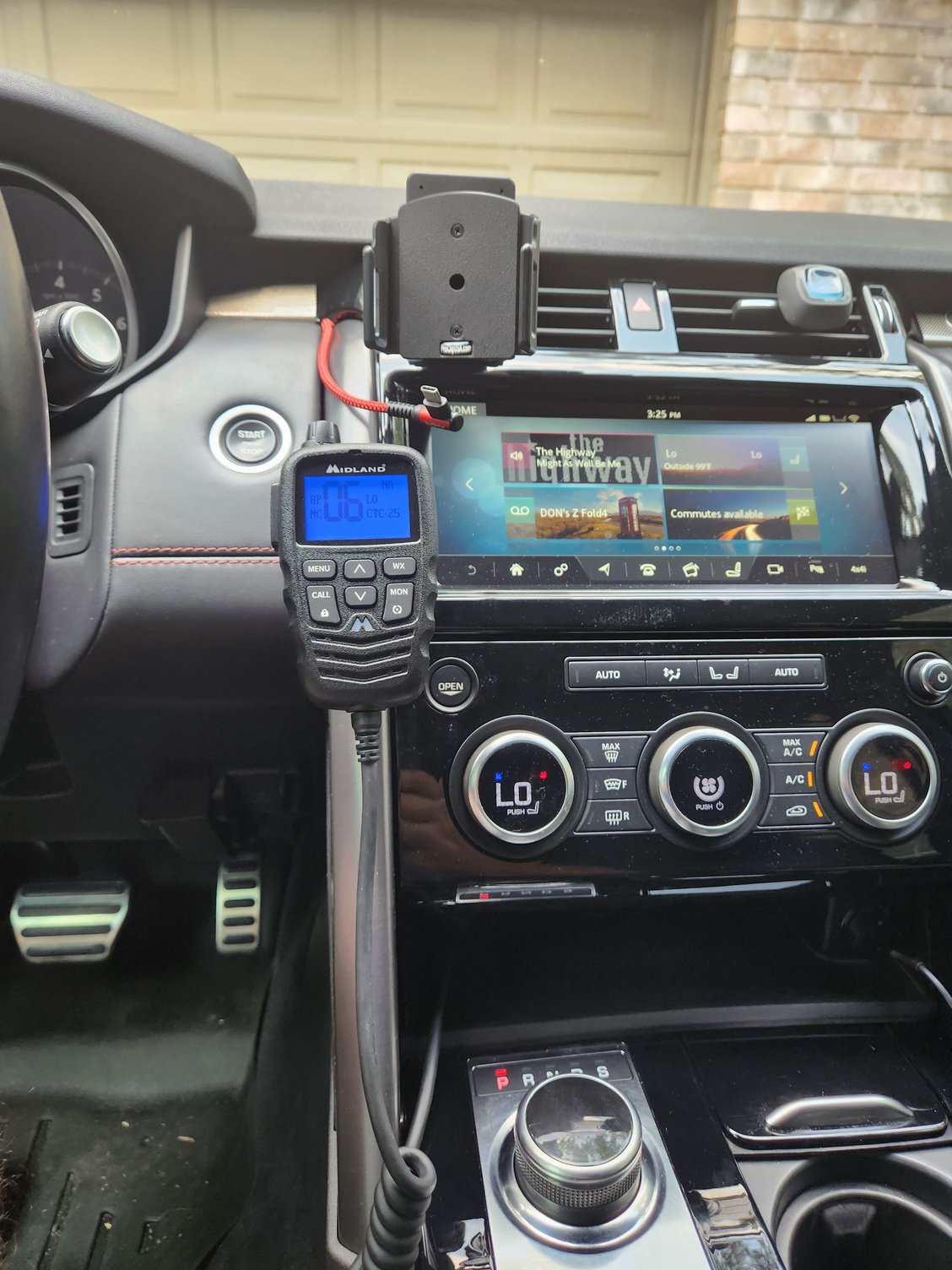

Old Jul 3, 2023 | 07:21 PM
Donc98's Avatar
Joined: Dec 2021
Posts: 121
Likes: 61
From: Texas
Originally Posted by ar077
Thanks! Any chance you can upload some pictures, and did you hit any snags after deciding where to install the MXT575? I also have the Midland Extension Speaker (Model #21-406) that needs to go somewhere.
Sure here is the completed install with the upgrade mic that is available for the 275/575 units.
IN the center cubie if you pull back the rubber lining there are some openings you can use to pull the extension cable through and pass out to the side of the center consol.
Finally under the bottom kick panel for the transmission on the left side of the tunnel if you pull that panel out you can see where the wires can be pass down to the unit if mounted under the carper there. I ran the wires for power over to the fuse box directly (Yes i know midland says to hard wire to the battery but this was a bit easier to the fuse box and other mentioned no issues on the midland forums. I might change in the future but for 1 year now it has worked) the antenna wire goes in from the back hatch and then across the headline to the A pillar and then down across the bottom of the dashboard to the location where the radio is located. Now i did not use the hard mount for the radio as the carpet holds it in place. The unit is placed with the speaker outwards so I run both mic and unit speakers and feel it is enough with no need for an additional speaker. The updated MXMC01 mic has a better speaker on it anyways.
