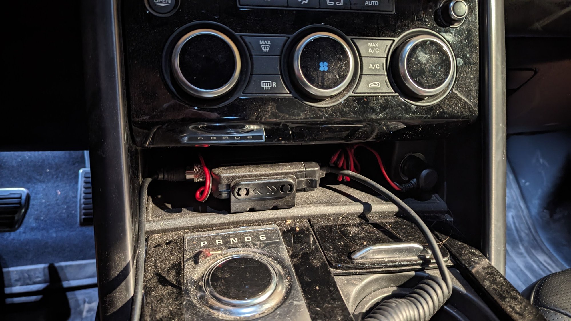

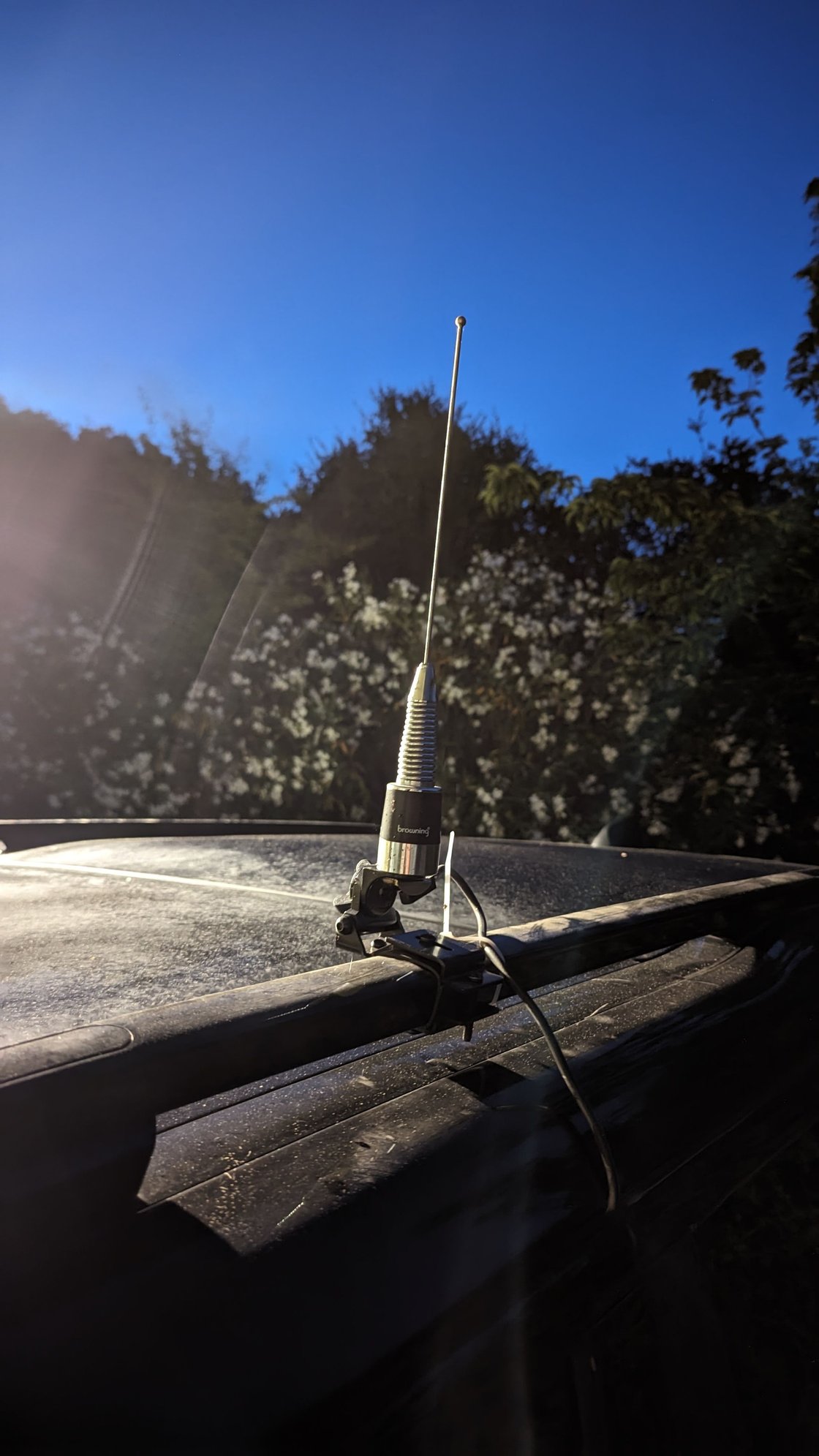

I placed my 275 in a cubby by shifter. Fits splendidly. MXTA25 is a bit of disappointment. Works of course, looks nice small profile but doesn't match performance of my well tuned Browning. SWR 1.9 (10 watts max output) v 1.01 (full 15 watts) for "same" 3dbi stick. Less scientific test during 800mile wheeling trip this weekend. My buddy was few miles away flat rural townscape coming in garbly over MXTA25, loud and clear over properly tuned Browning. Similar experience on the other end. Again it will work and provide better clearance , etc. For me it was n ot best $50 spent. FYI. Browning 450MHz-470MHz UHF 3dBd Land Mobile NMO Antenna https://a.co/d/4yoTqJ8
