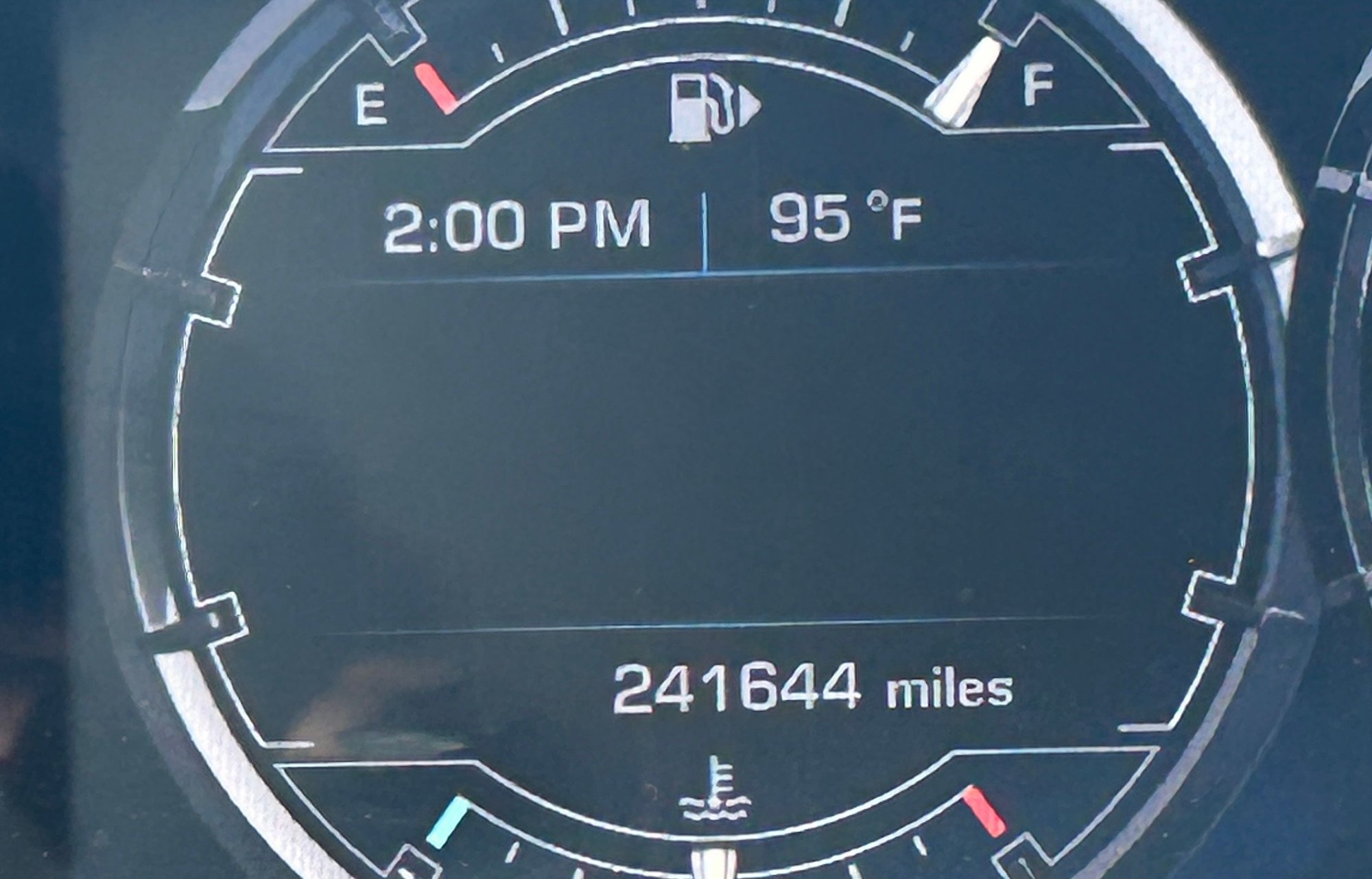

Maybe you’re right, but maybe I drove a 2012 Jaguar XJL with a 5.0L NA V-8 ‘til it almost had one quarter million miles and I mostly I just changed the oil every 15,000 miles. (Plus recommended maintenance.) I’d still be driving it today it if the brakes didn’t fail (w/o warning.). Perhaps JLR didn’t think that car would last that long, but on the Land Rover side they recommend getting that inspected and/or swapped out at a 150K. Maybe there’s a chance I know what I’m talking about since that was the seventh Jaguar I owned in three and a half decades!
Couple thousand miles before the brakes failed.
000 to 200,000 miles.
Perhaps what you’re failing to realize is that most everyone recommending that you change your oil at higher intervals than what JLR recommends, is either selling product or service. Now JLR even says: (From “Passport to Service”) “NOTE: The maintenance intervals listed are for vehicles operating under normal driving, road, and climatic conditions. More frequent attention may be necessary if the vehicle is subject to routine stop & go driving, extreme temperatures, dusty conditions, off-road driving, or frequent trailer towing. Consult your Land Rover Retailer for more information.”
