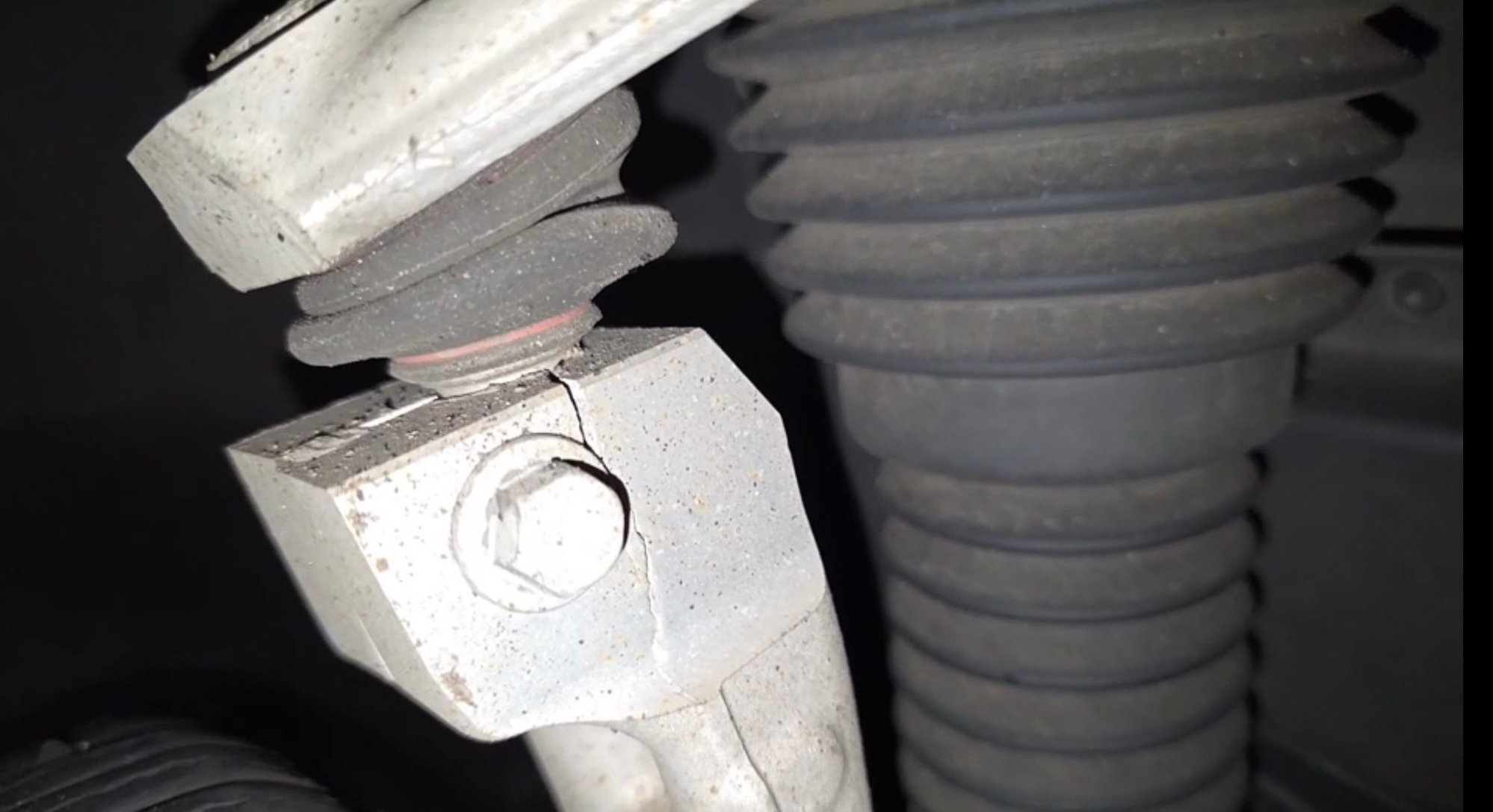

Update: They've diagnosed the hum as failed front wheel bearing/hub. warranty will cover that, however, unfortunately they also see a crack in the suspension knuckle behind that same front wheel which warranty will not cover. They don't want to press a new hub/bearing into a cracked knuckle otherwise i would have had an indy shop handle the knuckle and not pay dealership prices to do it.
Warranty will pay around $1K for the bearing and i'm stuck paying around $2K for the knuckle. Trying to see if they'll help me a bit on my portion or do I take it to my indy shop and do the whole knuckle + hub together for less..

Contact Land Rover. They should replace that knuckle for free - demand it. In fact, both are probably failing. In the UK this has been an issue that I believe now is under a recall. LR Time has this happen and got LR Germany to do the replacements for free, but it took some calm complaining for them to acknowledge the issue even though in the UK it is a recall.
edit: I will add that if anyone other than LR has touched that knuckle bolt, they will do all they can to avoid repairing at their cost it seems.

https://www.dsautomotive.co.uk/blog-...ckles-cracking
