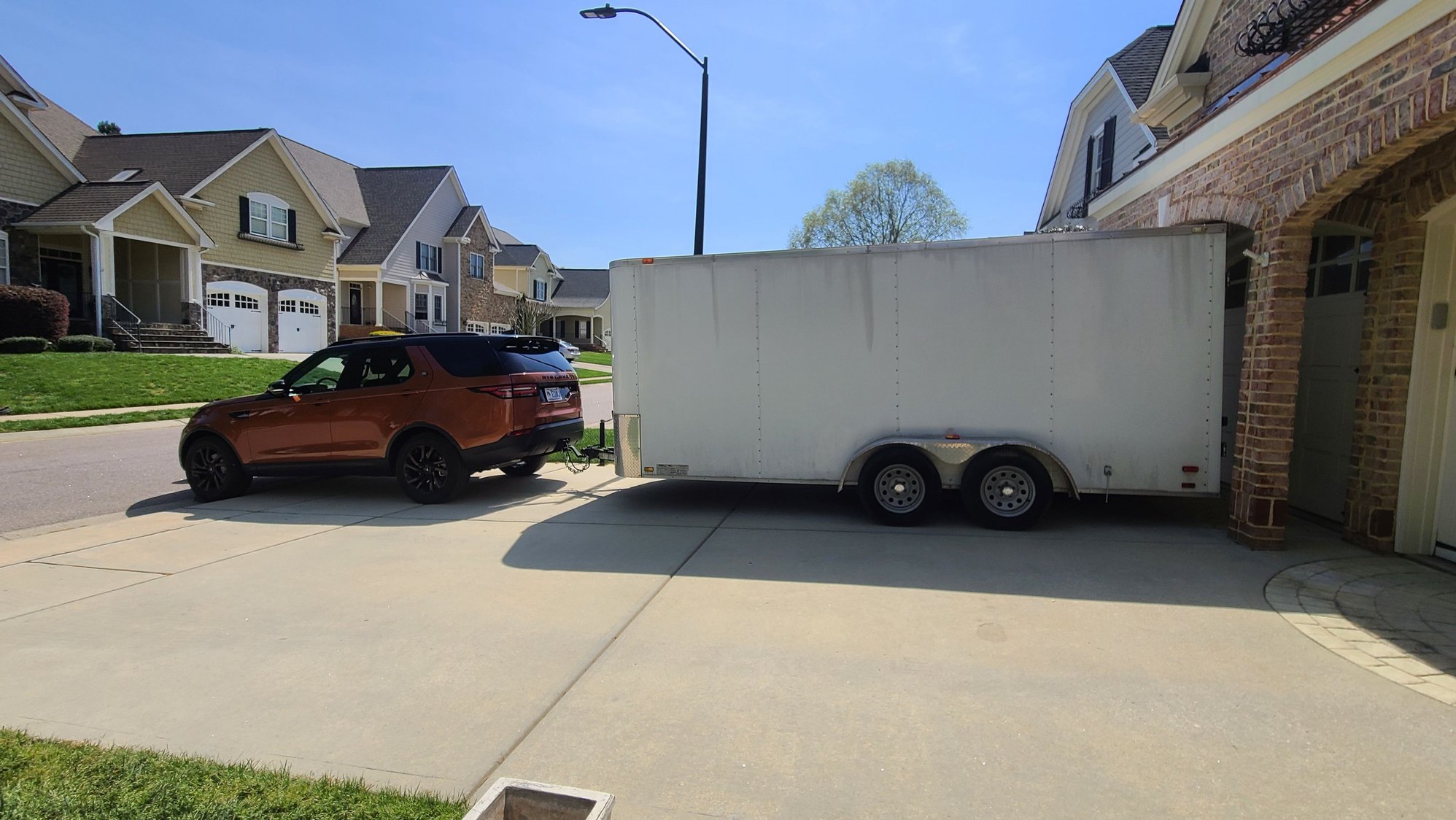

I tow this all over NC... Mountains to the beach. Zero issues moving and stopping. I did add an electronic trailer brake using the pre-wire that came with my Disco. Many boat trailers have brakes (hydraulic surge) and most states require depending on the trailer weight.

I would highly advise a trailer brake of some kind with that weight... You do not want your boat to beat you to the stop sign on a hard stop! That said, a boat that size may have a trailer with the hydraulic/surge type brake built into the trailer. Best to speak to the seller and look up the laws of your area, state laws differ in the USA. In NC I believe the weight is 4,000 lbs for a brake requirement.
