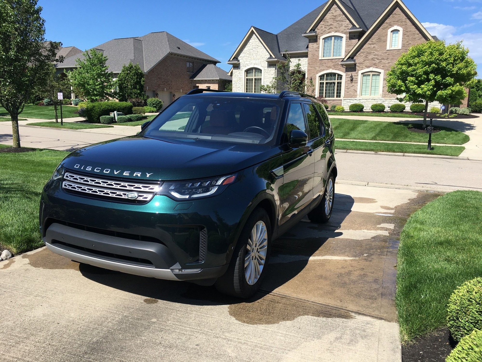

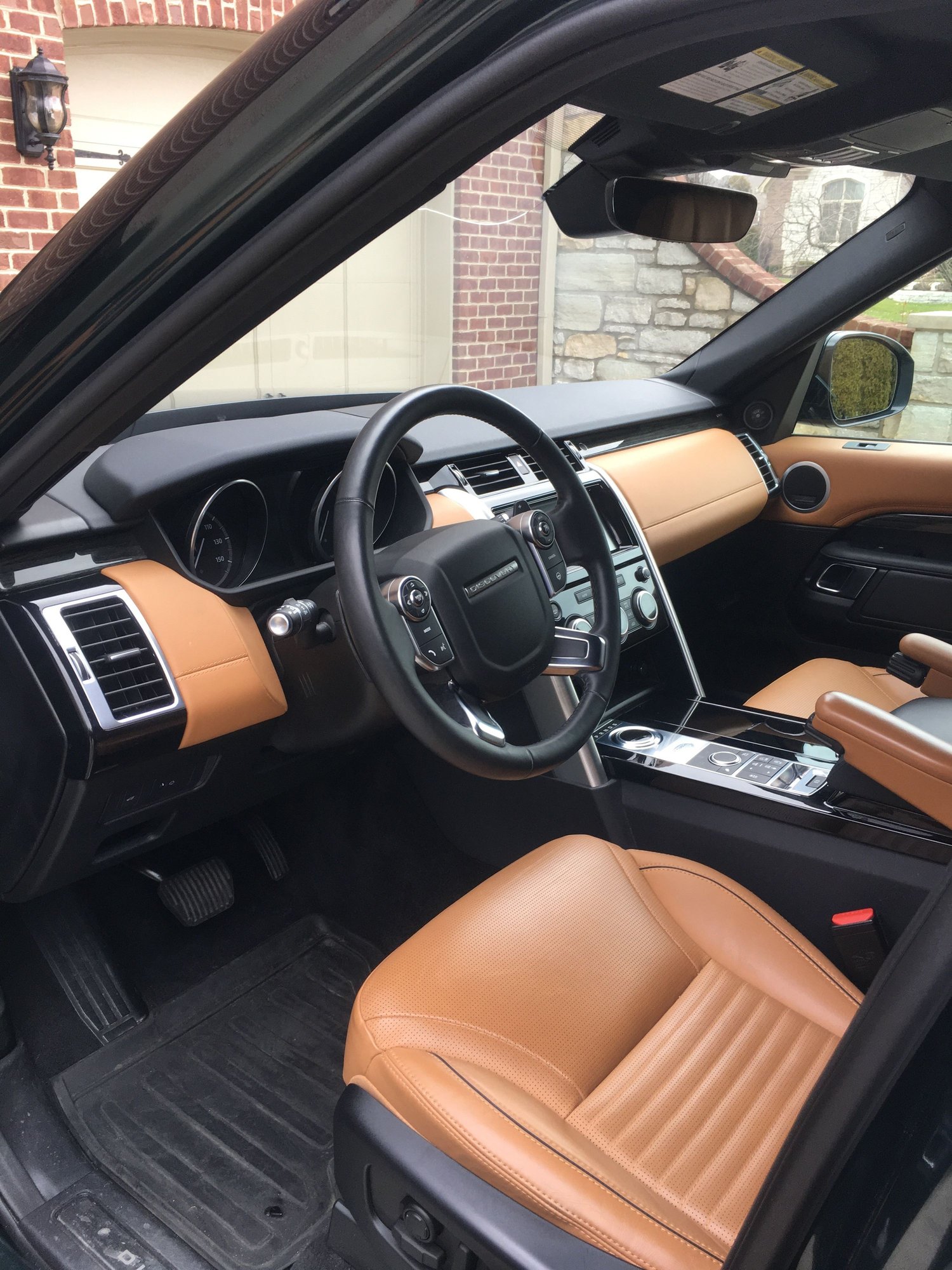

I had a 2011 LR4 V8 and I replaced it with a 2021 P300 I4 Defender 110, and I was worried that I would be giving up a lot of power, but honestly, the four cylinder is more than adequate. 0-60 takes 7 seconds, only 3/10ths slower than the LR4. I originally intended to get the P400 I6, but the early cars had weird throttle programming that I couldn't get used to, despite having an electric supercharger and little electric motor to mitigate turbo lag, it was completely dead under 2500 rpm. The I4 has some turbo lag at wide open throttle under 3500 rpm when coming from a stop, but in normal driving, it is linear and responsive, and peak torque comes it at 1500 rpm. I also had a 2017 D5 HSE Luxury Si6 (supercharged V6) from 2017-2022 and I really miss it. Mine was Aintree Green over Vintage Tan/Ebony. The color was only available for the 2017 model year and less than 100 were brought over to the US in this color. The Discovery is a better value, more luxurious, and a much better family car. The Defender looks better, is more capable off-road, and has better driving dynamics with noticeably less body roll than the D5.

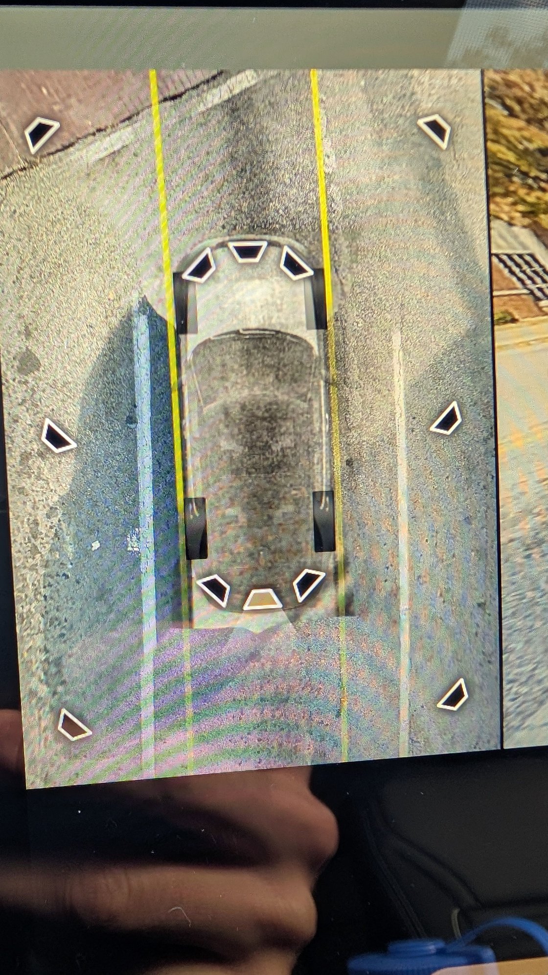

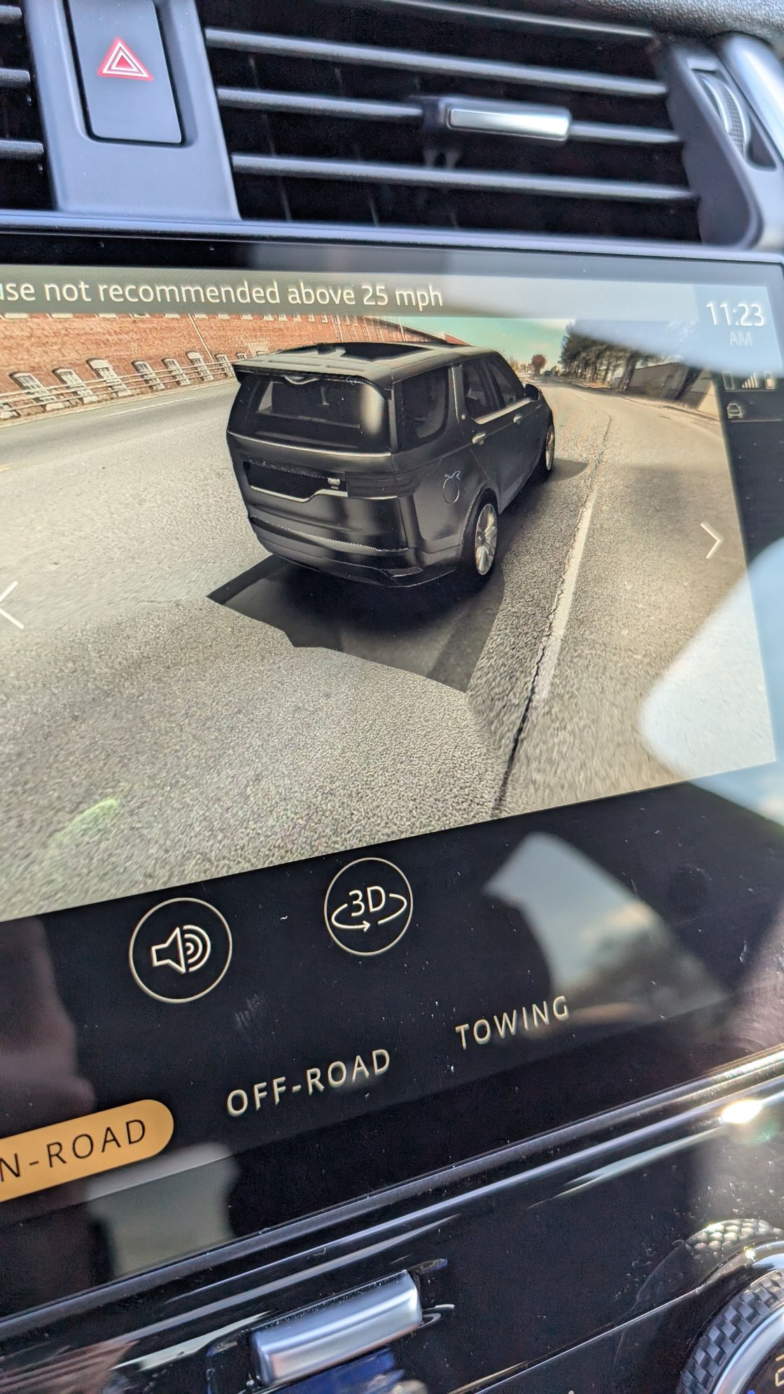

I am back in the 2024 Discovery loaner. I think the biggest random improvement is the camera system. It is so much better than the 2018. I was shocked at how high quality the views were and how you could actually look at it and see what you were driving into at speed, even up to 65 mph plus and you can get a 360 view with guidelines that is incredibly detailed and easy for your eyes to understand. Understand. It's much better than the 2018 which is still rather rudimentary and not even useful going 10 miles an hour looking straight on. I think that would be really helpful off-road.
That accurate side view would have been fantastic when my vehicle was up against a drop off on one side and a tree on the other side this weekend 😎
It accurately captures what is under the vehicle
