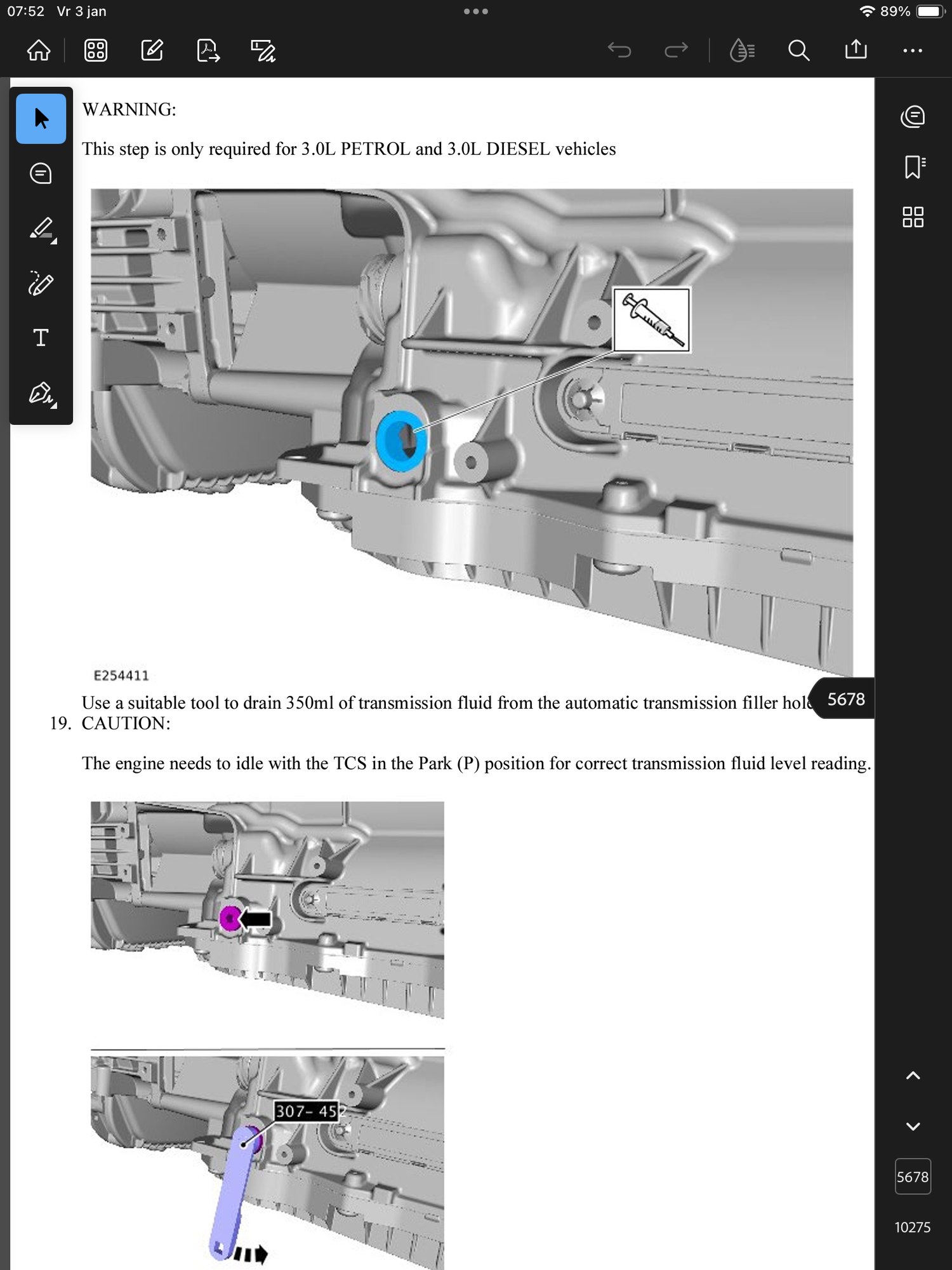

I wanted to do a oil service on the ZF8HP45 gearbox in my
Disco 3.0 SCv6 3.0 Si (petrol)
The WM say, after topping up with the engine running and the
dripping out the level plug stopped, remove a 350ml of oil ????
then refit the plug. Job done.
Ive never heard of suck out a amount of oil, also not for the LR’s
with automatics, I had before .
Can you guys tell me …..have I reed the manual correct?

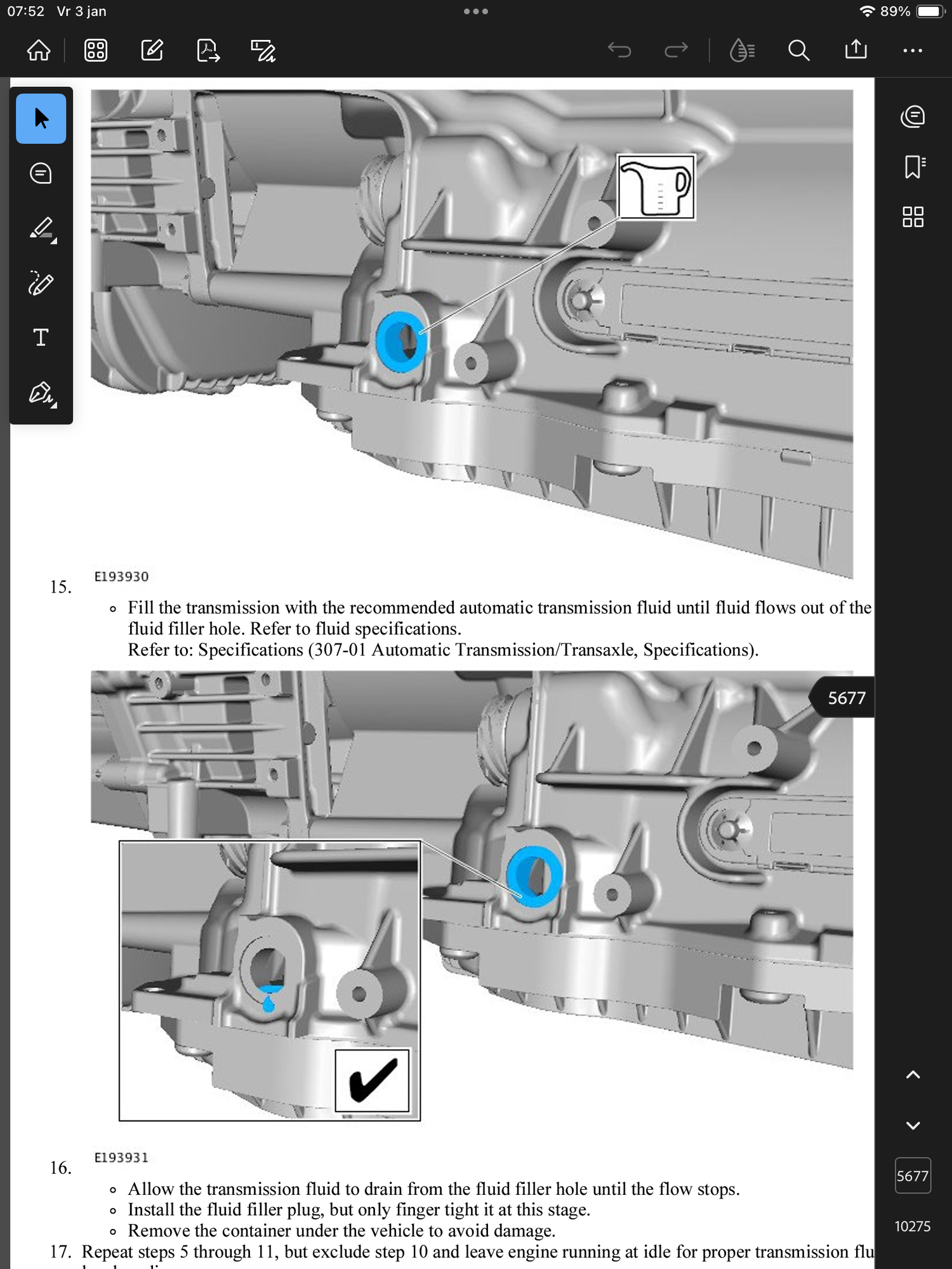

Gentlemen, I really don't want to be stubborn. I have never done it differently with my Disco3 and RR4.2SC. I completely agree with you. However, I came across this in the WM for a 2018 Disco5 3.0 petrol. Sooooo strange, could it just be a mistake in the WM?

pic’s I showed are from the workshop manual for the Disco5 3.0V6

I must be lost. I've read the manual, no where in the transmission section does is say suck anything out.
