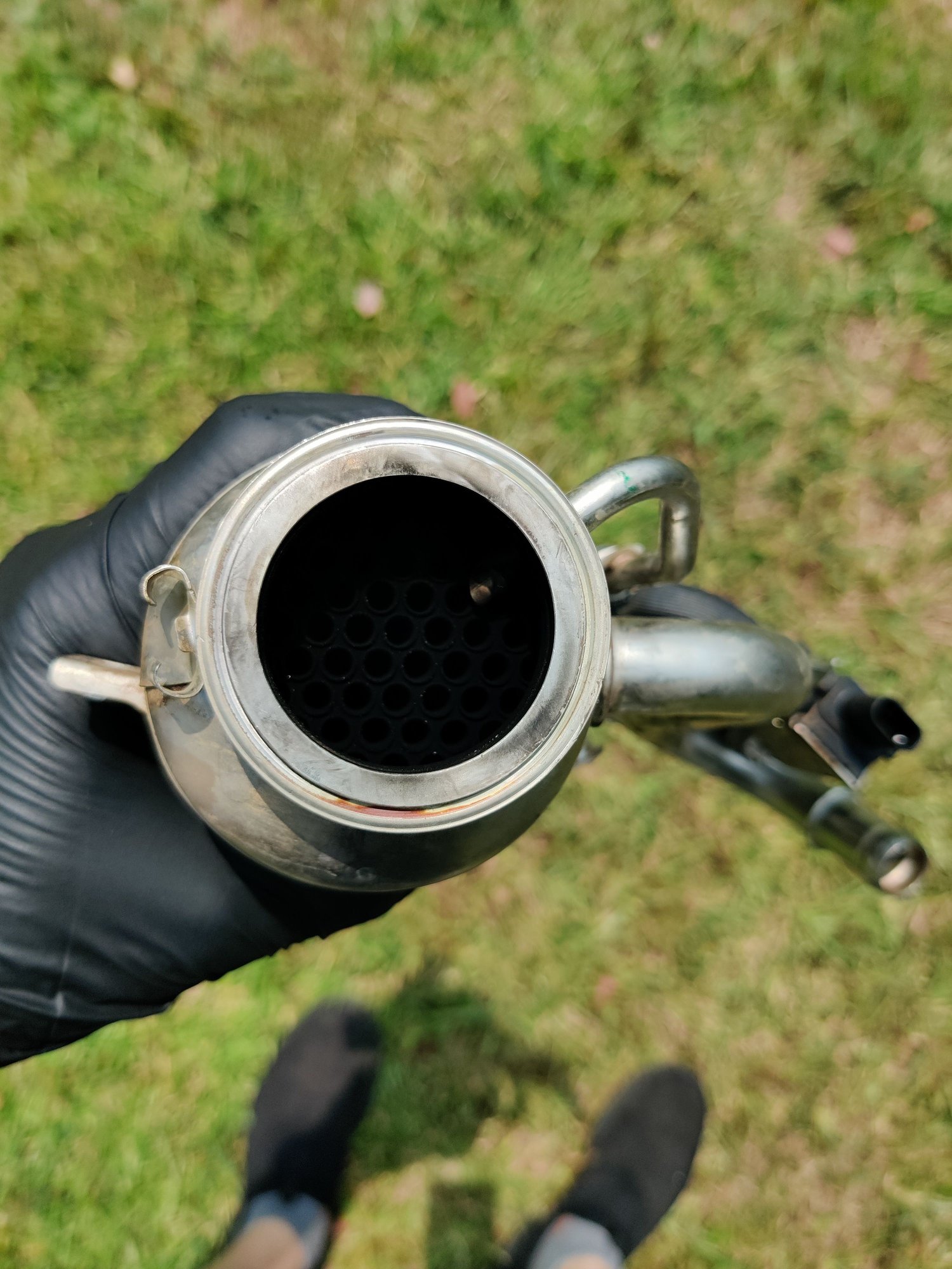

Old Jun 17, 2023 | 08:47 PM
gmfain's Avatar
Joined: Feb 2015
Posts: 936
Likes: 545
From: Calhoun, GA. USA
I picked my D5 up today.
Here is the pics of the EGR.
When I have time to clean it, I will post those pics too.
Part # LR069681
