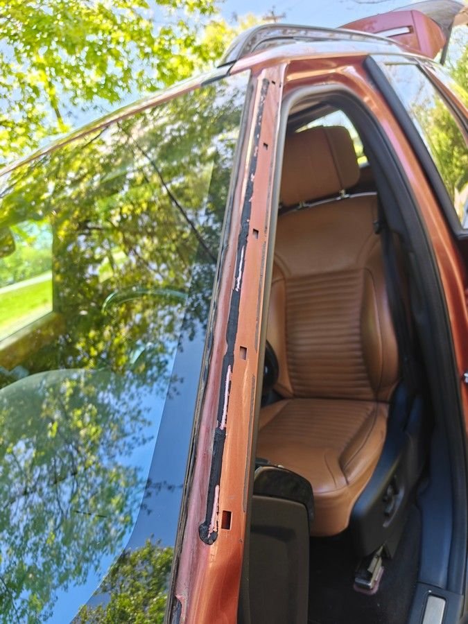

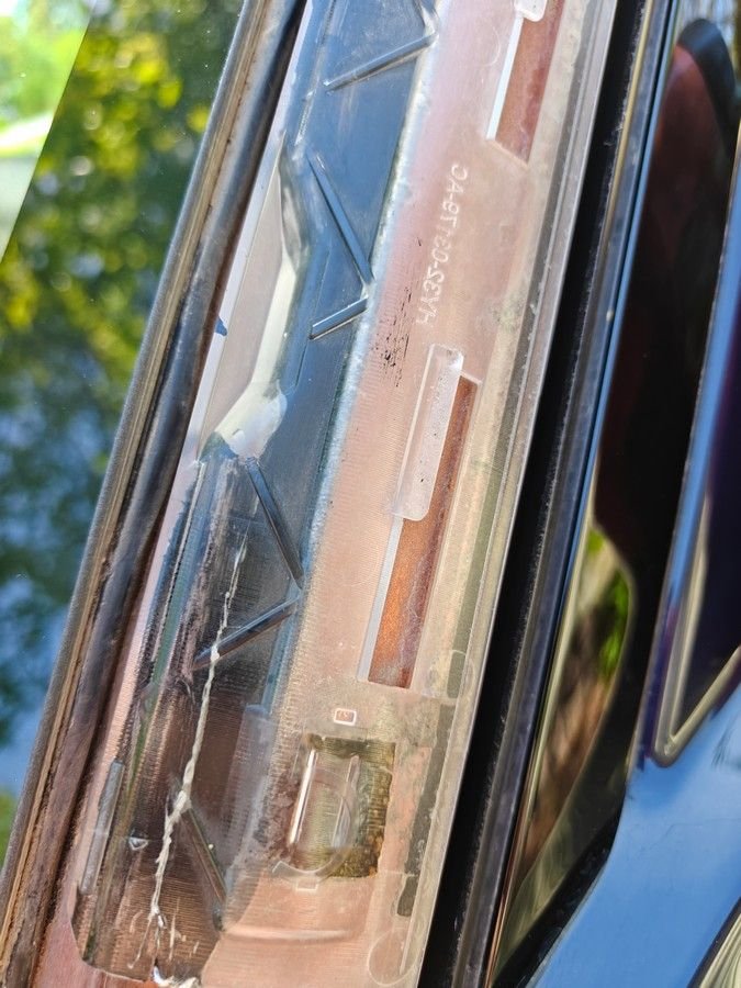

Note the windshield glue on the leading edge

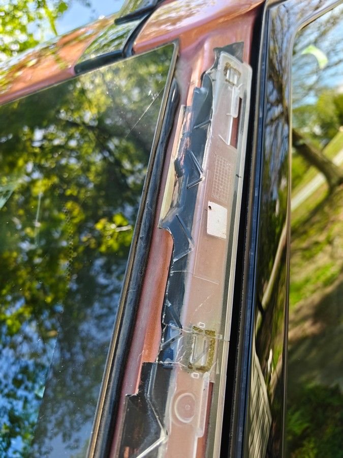

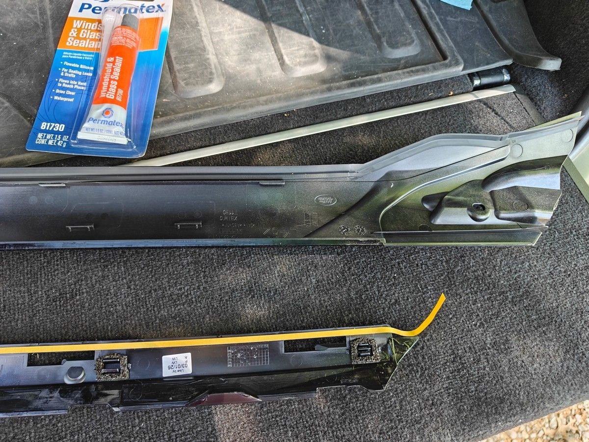

I had to heat up the windshield glue and use a puddy knife to carefully peel off

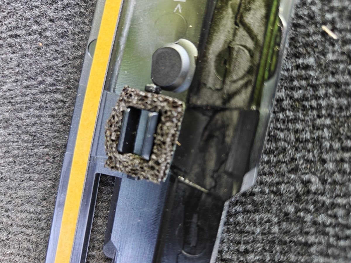

comes with a so called sealer.

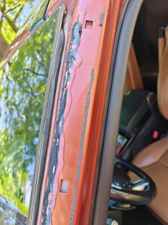

clean it well
clean it well

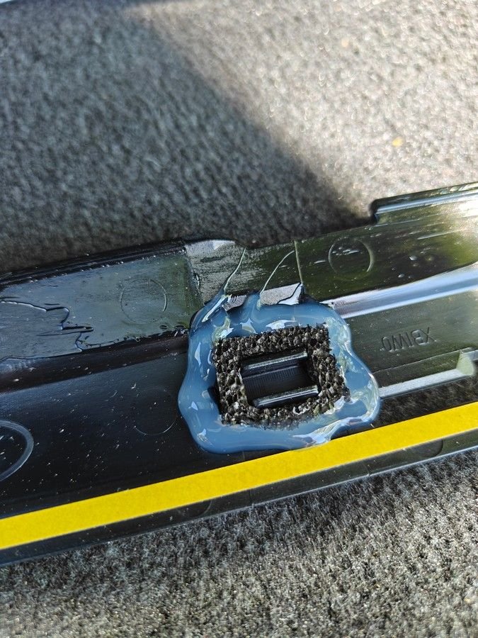

add windshield glue all spots
Add a new line of windshield glue

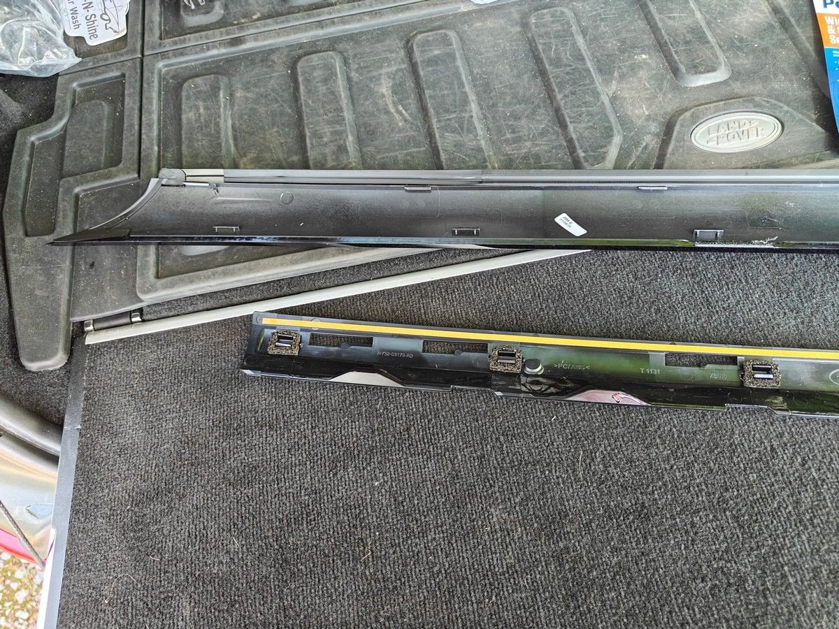

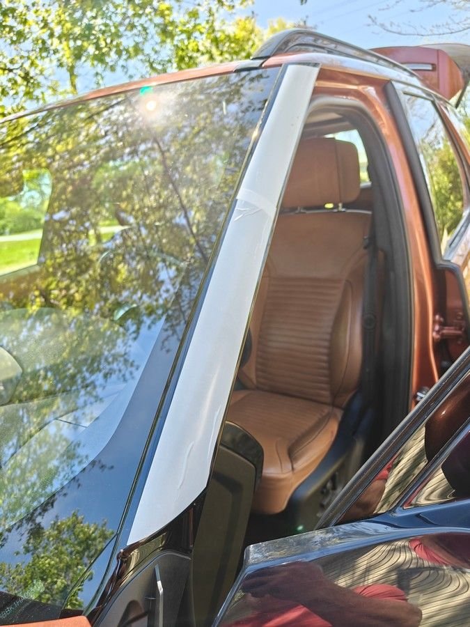

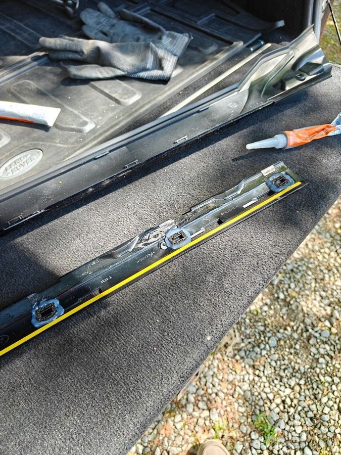

new base installed
new base installed

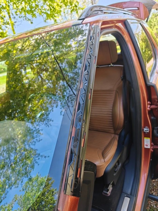

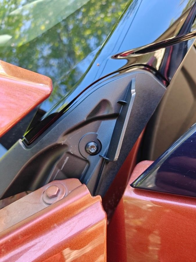

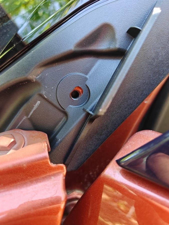

screw hole
screw hole
installed
installed
don't forget the screw

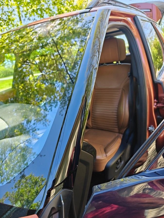

finished
finished
Fairly easy job. Be patient with peeling of the windshield glue, if yours has it applied.
