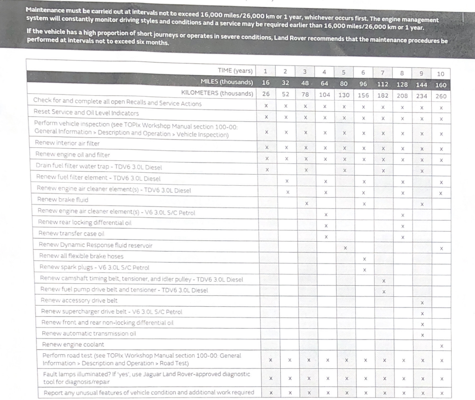

Hey all, Just picked up a 2017 HSE TD6 over the weekend with 96,000 miles. I had a pre-purchase inspection completed and the truck is in terrific shape! 3/4 life remaining on the brake pads, 3/4 life on the tires, oil change recently completed as well as DEF service. Just drove it 11 hours home, this thing is tight and seems to match up to the maintenance records. Very clean for mileage.
Is there anything I should be doing now or at the 100,000 mark to stay up-to-date on the maintenance? Planning to cut the oil change intervals in half. When does the transmission need to be serviced? How frequently should I be swapping the differential fluid? This one does have the center and rear locking differentials. Are there any diesel additives I should be using that will help with longevity?
To be fair, I'm not familiar at all with the diesel platform, but super excited to learn more about it. I love working on our vehicles and plan to do as much maintenance as I can, but also have access to a good independent shop.

Timing belt and fuel pump belt at 112k but I would do it at 100k.
This is for a 2017 Discovery, L462.

Thanks for uploading this! Will definitely download for my own records. Appreciate the help on the timing belt as well.
