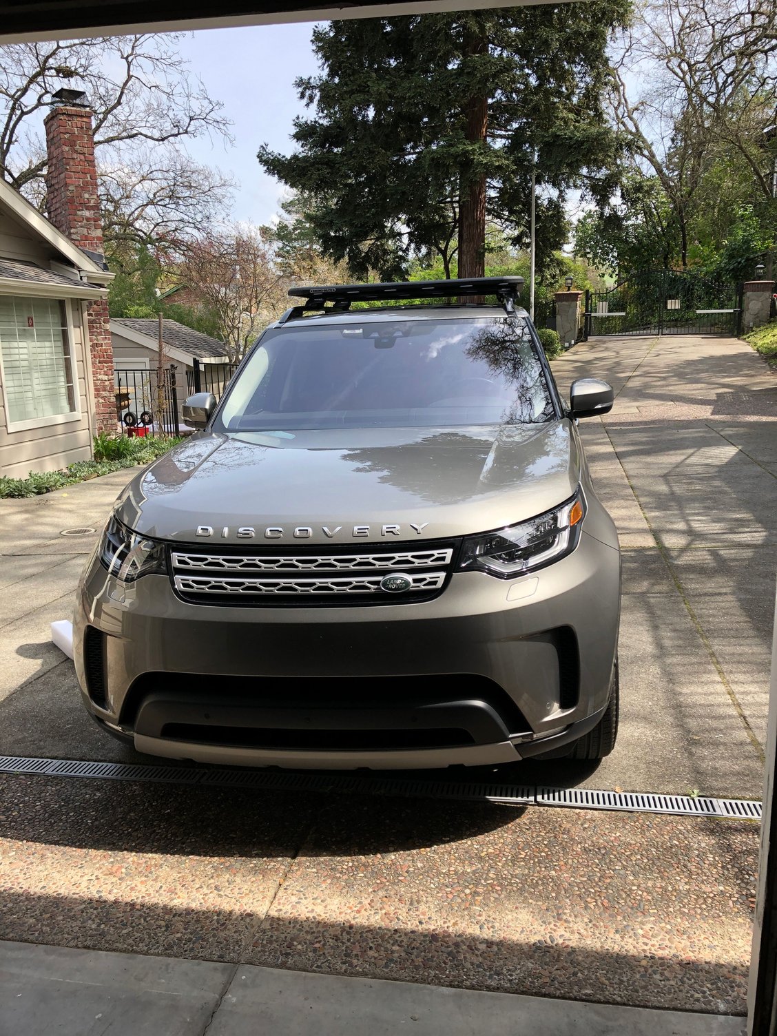

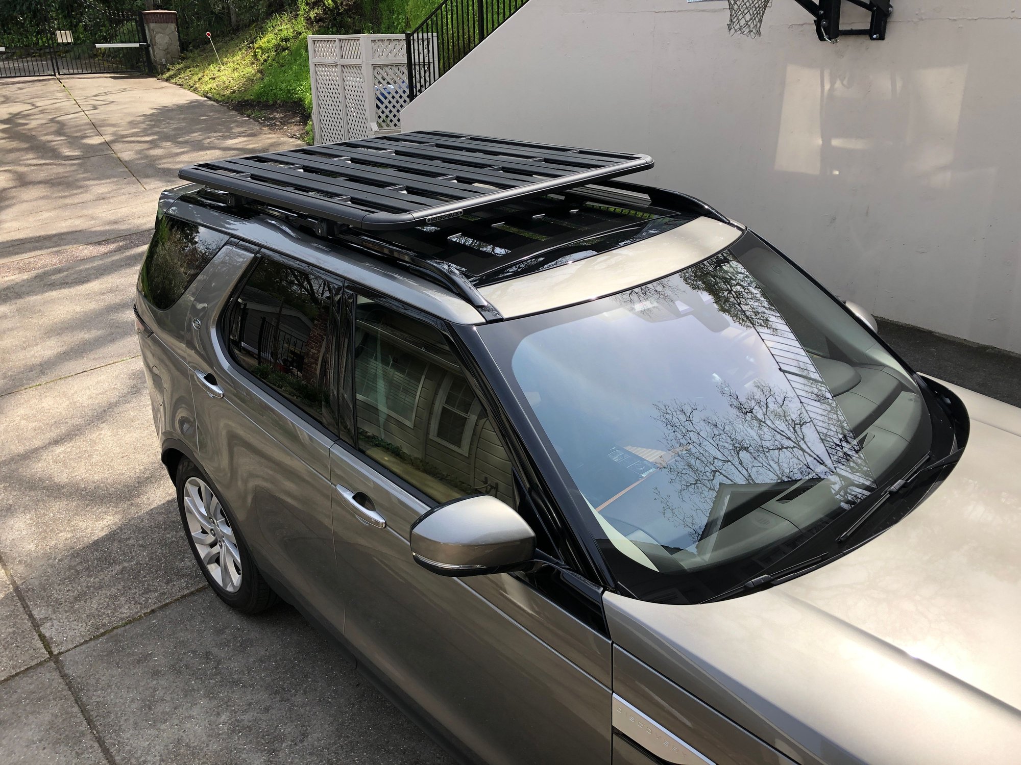

Finally got my Rhino Roof Rack after a few logistical issues, but Rhino USA stepped up and got things sorted. Pretty good customer service, although it took a few calls.
I ordered the Pioneer SX Platform kit for the 2018 Discovery (since they don't list 2019 yet) - Part #JA8979
This includes the Pioneer SX platform 60"x 54" roof rack with mount rails - #44101B
and the Vortex SX Leg kit - #SX026
I also go the double horizontal jerry can holder (#43152) and 2 sets of 4 eye bolt kits for the Pioneer platform (#43178), still need to fit these.
Below are some pictures.
It took me about 2 hours to install the roof rack on the Disco. The instructions are pretty good, but I found a few things that may help others and save some time.
- I found it easier to put a ladder on each side of the D5, saved a lot of time and reaching over the roof to get to things.
- First unscrew the legs quite a bit to give lots of wiggle room.
- Instead of trying to fit the legs first, I slid the cross bar of the roof rack into one leg and then hooked that on the Disco factory rail. Resting the bar on the opposite rail.
- I then slid the bar into the second leg and hooked the leg on the Disco roof rail on the this side.
- Then used the supplied wind strips (which has nice metric measurements on them) to center the cross bars on the legs while tightening the legs. See pic below.
- I found it easier to slip in the T bolts before putting on the end caps of the cross bars. In actual fact I couldn't get the T bolts in with the caps on like they stated in the instructions.
- I placed the legs by the side holes where the factory crossbars mount, and the measured to center the roof rack's center bar between the cross bars (about 11" each side). This left plenty of room in front of the shark fin antenna and also when the hatch is opened to the rear spoiler. (Note: I will probably move it forward by an inch or so next time I fit it to give more clearance for the moonroof to open, as it is pretty close to the center crossbar that is part fo the rack platform assembly).
A couple of other notes:
It takes a few minutes to take off again with my wife helping to lift one side and walking off to the back. Just unscrew all 4 legs using the handy incorporated twist levers, then wiggle them loose till you can unclip them form the roof rails, lift and walk back till clear of the Disco.
Installing again won't take too long either, will test, but doubt it will take more than 10 minutes. However make sure to mark the front legs/side as the front is wider than the rear on the roof rails. I also took pictures of where it mounts on the roof rails as the exact position (or close to) will be important.
The moonroof does open, but with the way I mounted the rack it just clears the center bar on it by a few millimeters (a bit close). Mounting the roof rack and rails an inch forward will create more space for the moonroof to open. This may be the way to go and I may adjust it a little when I mount it again, as I surely don't want to scratch the moonroof, not that I will use it much with the roof rack on.
At any rate, ready for camping offroad season this coming summer
