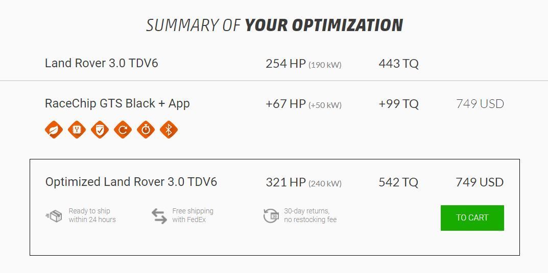

Race Chip does have a Bluetooth App but you have to pay extra to use it. I'm researching the advantages of using a chip box for towing purposes and to improve gas mileage. With the Race Chip in my Audi Q5 I get better gas mileage using the highest setting (42 MPG on an 80-mile highway round trip at the maximum setting vs 40 MPG at the lowest setting, at similar outside temperatures and traffic congestion, testing it multiple times). I also get the best performance so I see no point in using anything but the highest setting, especially since I try not to push the car to the maximum performance "very often".
The TDI-Tuning chip says the lowest setting gets you the maximum mileage improvements. I wonder if that's true. I do like it that it has a Bluetooth app, unlike Chip Express.

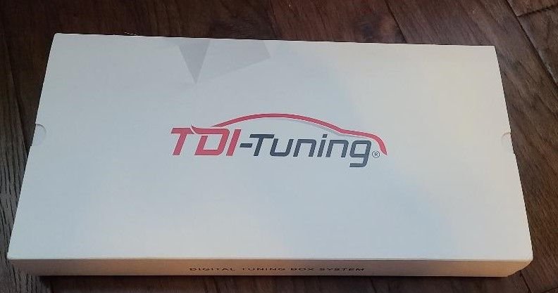

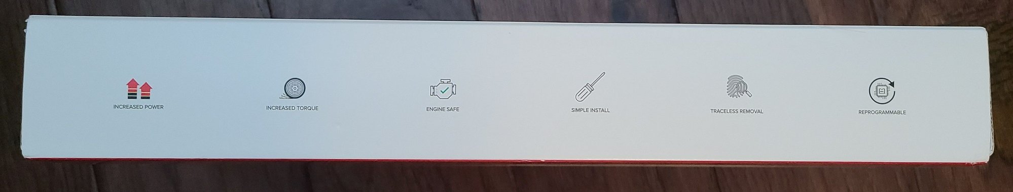

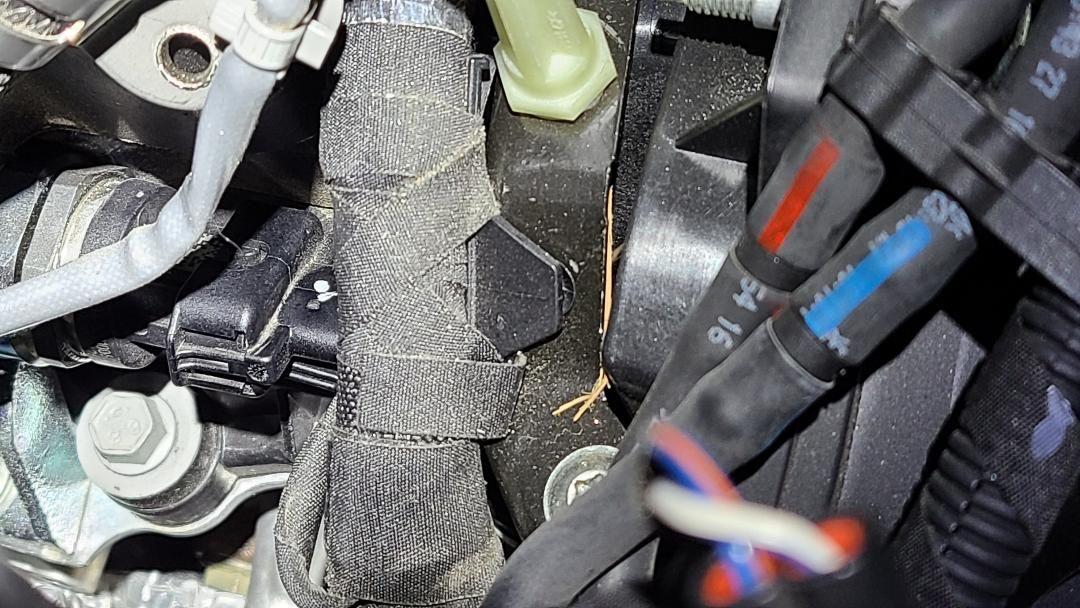

DHL came through like a champ and delivered my new tuner box yesterday! Ordered it Tuesday afternoon and received it Friday. DHL flew it out of East Middlelands (EGNX) and connected through Cincinnatti (KCVG). The packaging is very good and looks quite professional. I like the little Made in Britain logo on the back of the box, as well. The enclosed literature was printed in color and lays out everything you need to know very well.

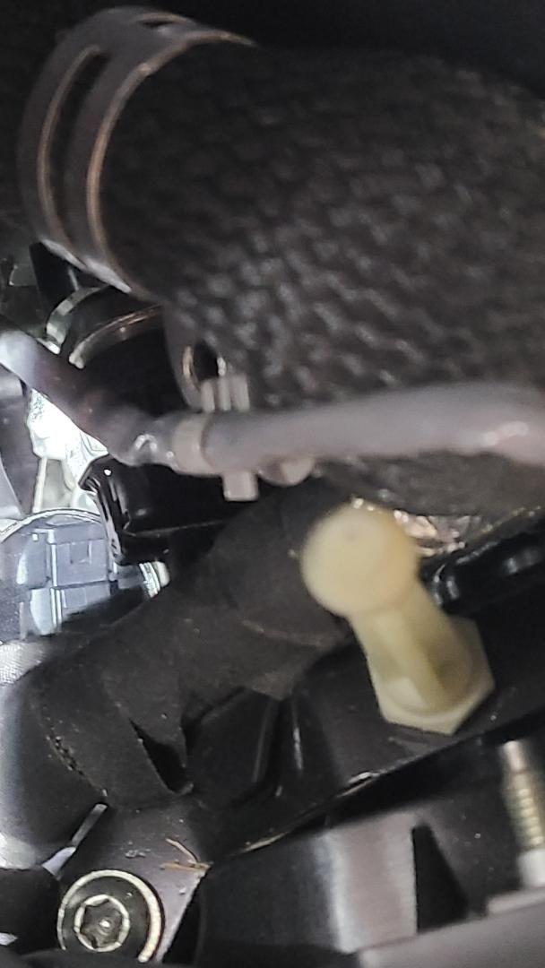

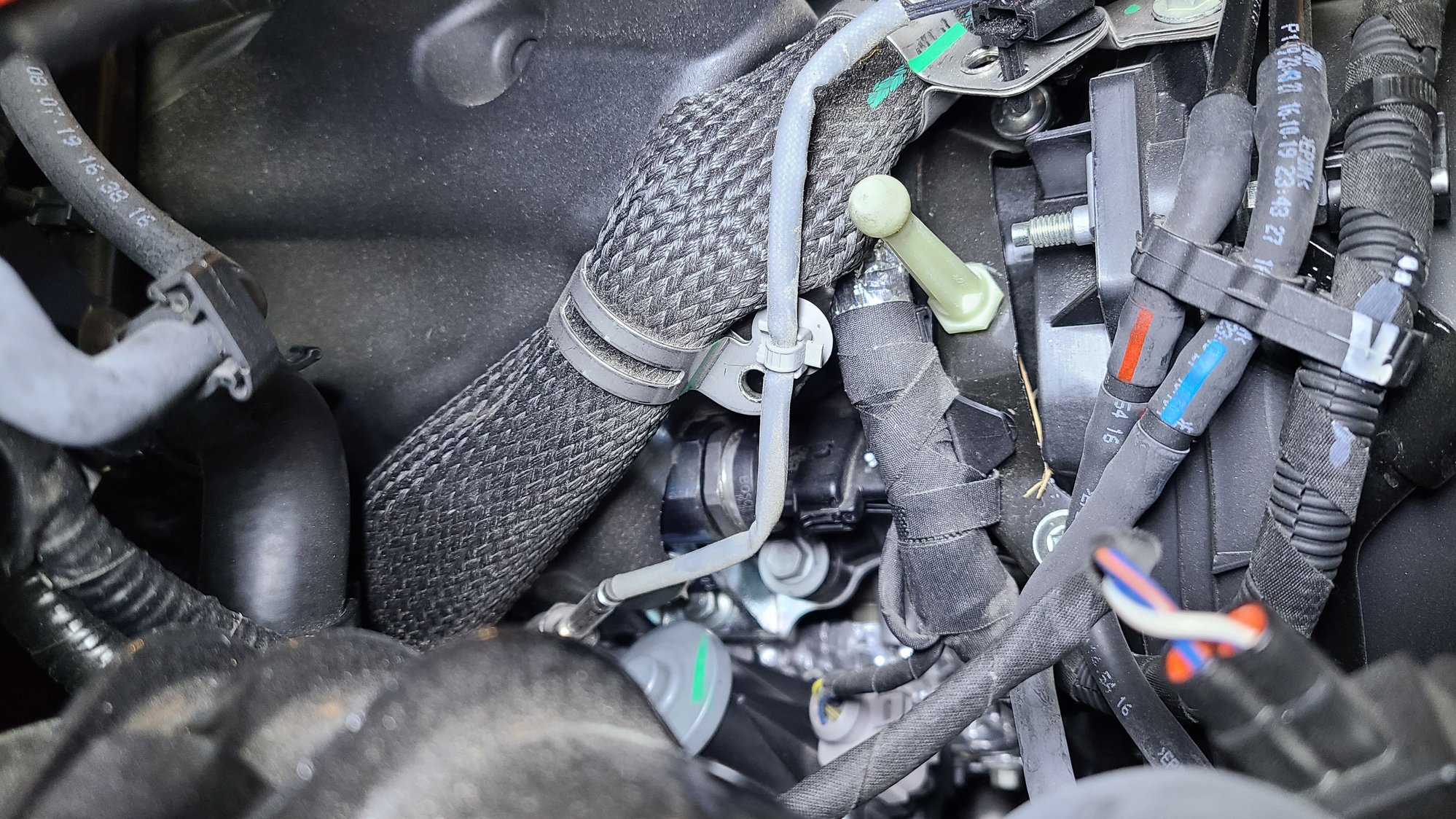

Installation: The boost sensor was easy to get off but the fuel pressure sensor required a tad more effort. I ended up putting on a mechanics glove and after verifying with a mirror and comparing with the connector on the wiring harness from TDI-Tuning (they are identical,) I knew what I had to do in order to get the plug off. I squeezed real hard until I heard the click, and then it slid off relatively easily. Not a lot of room to work with down there but in the end, it's really not that bad. After that, I took an extra couple of minutes to think about where I was going to route my new harness and box. Before I secured it all down with the cable-ties, I turned on the ignition to verify it was working correctly and programmed the Bluetooth connection. The install video from TDI-Tuning on YouTube does a great job, well.
How does it drive? Upon my first driving impressions, I was limited to a 35mph speed limit on my neighborhood roads but you could tell the throttle response was vastly improved. Later in the night, when I was able to get out and open it up a little more, the next thing I noticed right away is that the turbo lag was all but gone. I never even had to put my foot all the way down because the power and torque are immediate and immense. Going up an incline and wanting to get away from the traffic, it just scooted up the hill like I had a big tailwind. The tachometer needle rising clockwise almost reminded me of my DCT in my old F10 BMW M5 where it just goes through the RPM band so fast. It's a whole new vehicle and thus far I'm extremely satisfied. 300+hp and 500+ lb/ft tq in this D5 is a beast.
Summary: All in all, this is a relatively easy thing to do and you can always go back to stock. Even with the Td6 and one turbocharger, (always wished I had the Sd6) these Lion V6 diesels have a lot more power to give than the V6 EcoDiesel that I had in my MY15 Jeep Grand Cherokee, (and that was even with the Green Diesel Engineering (GDE) tune, by the way.) The Bluetooth module works well and although it's convenient to be able to use it to change the setting, I'll probably keep mine on 7 all of the time. One cool thing about the Bluetooth module is that you can theoretically upgrade the tune on your module remotely via Bluetooth. I put in my email address and module serial number and it said of course, not surprisingly, that my tune was the most current. The tuner-box or in-line tuning technology is well proven (look up how Banks has invested into the new in-line tuners as opposed to ECU flashes,) and this particular product is from a company that is very reputable and is known for making good but safe tunes in all of their products. The price is actually an excellent value to begin with but with a 25% Black Holiday Sale, it's an absolute bargain! Look on YouTube for more videos of their products, I don't think you will be disappointed.
