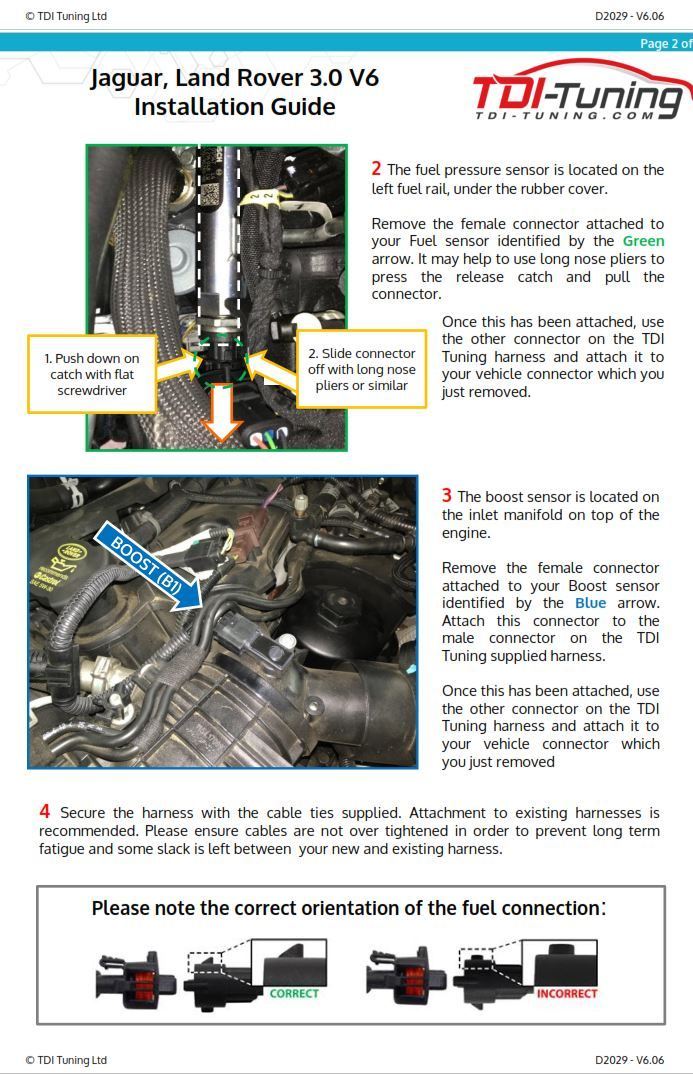

Do you get the light to come on in the tuner box under the hood? Before you even start the vehicle, regardless of the Bluetooth? O course, the first thing you would want to do is make sure you have all the connectors seated correctly, but I can't imagine you'd get the light to come on on the Tuner box and no CEL if you didn't have the two connectors installed correctly. Make sure they are seated in the correct, upright position.
The pics in the install guide are of an Sd6 but they otherwise work for our Td6's just as well. The boost sensor is easy to swap bu the fuel pressure sensor did take a bit of clamping force to pop put and unseat. I think it was at level 4 by default. Even stage 1 you should be able to notice. The turbo lag should be easy to discern and the torque is just immediate and immense from there. I know TDI Tuning has good customer support, I'm sure you can reach out to them and they could brainstorm with you on the first places to check.

as far as I know everything registered. The box responded to the different settings in my phone. The phone didn’t give any errors. I thought I was just gullible. Or that maybe there was a software issue. I’ll have to give it another shot I’ve hung onto everything. Glad you’re seeing success I def would love to see your results. My only comfort in this was knowing it had to be connected right or the disco itself wouldn’t work.
