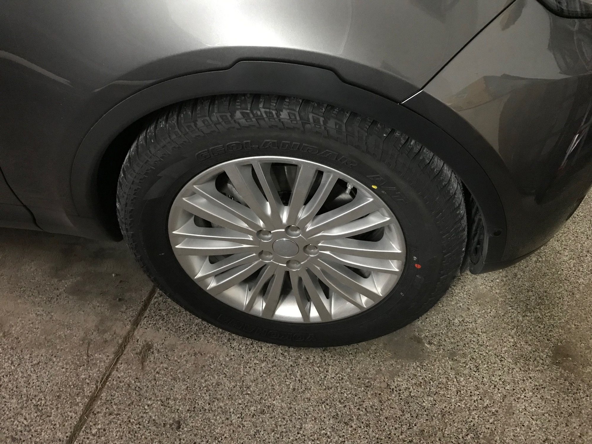

I have heard goof things about the M Defender, I use the "20'" Bizzack tires for snow. I have to admit...I wouldn't mind leaving them on, the seem to handle as well as the stock tires and ride very nice as well. They are soft tread so they will wear quicker otherwise I would leave them on all year
