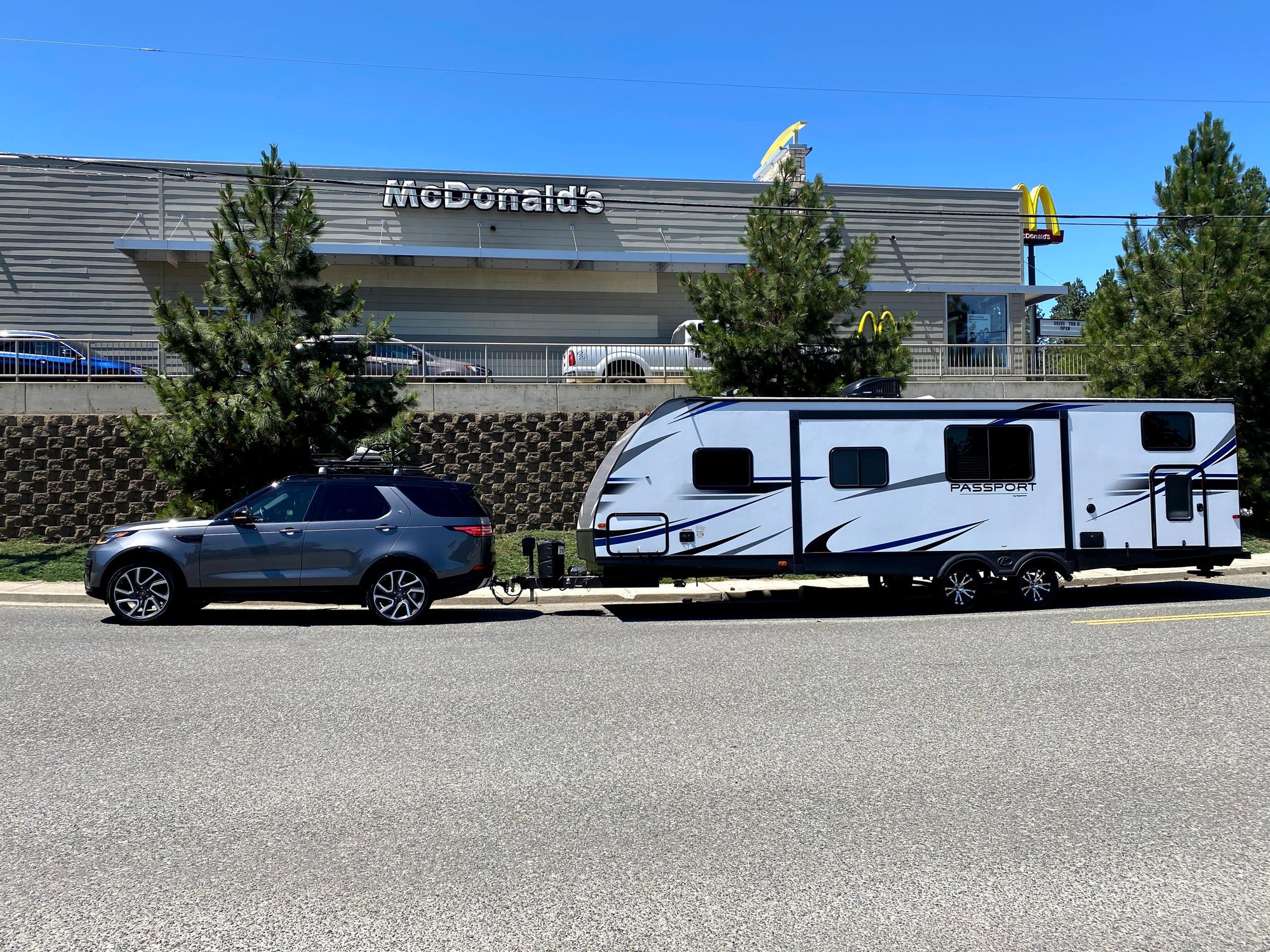

These are towing champs. Did 1k miles over the holiday weekend, and it never put a foot wrong the entire time. Lot of high elevation mountain passes. Good power, amazing stability, terrific suspension. They punch well above their weight.

Wow - love the photo! Looks impressive

Can I get the specs on that trailer?????

What is the total weight of the camper you are pulling? Be good for others here to know as a guide. Thanks.

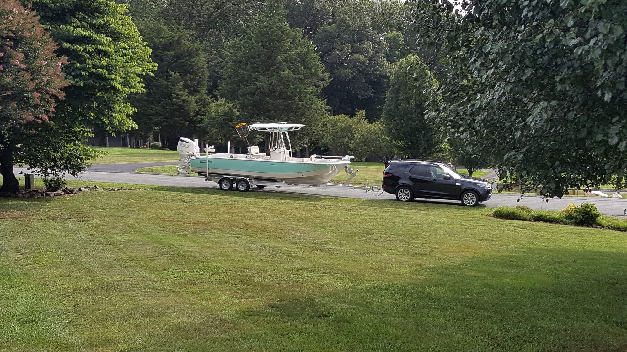

I pull this with regularity up to 300 miles in a day. Boat with trailer around 6500 pounds.

Total length 33ft. Weight empty 5,800lbs loaded just over 7,000lbs. Tongue weight 630lbs.
Averaged 18MPG while towing as well, even with the elevation climbs.
I cannot describe how good of a tow vehicle it really is. You get plenty of weird looks from the 1/2 and 3/4 ton pickup truck crowd though 🙂
