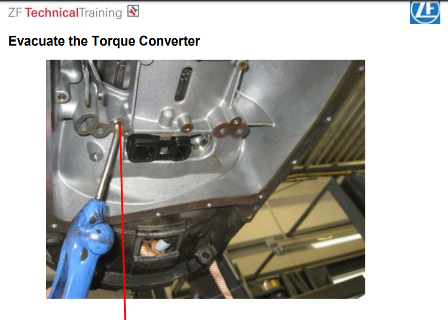

There's a page in the ZF workbook that describes "flushing" the trans with an air compressor gun:
Workbook link:https://www.bimmerfest.com/forums/at...5&d=1460520414
CTA tools makes a tool specifically for ZF trans - it appears to remove an additional 2 - 2.5qts of the old fluid. https://www.fcpeuro.com/products/tra...h-kit-cta-7650
