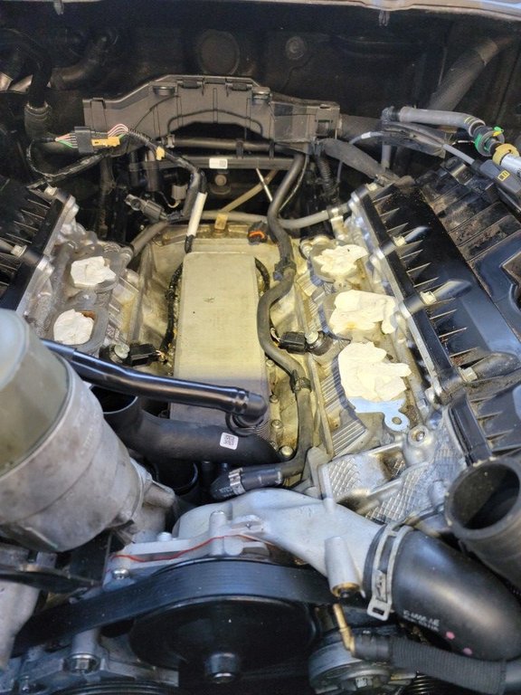

I'm trying to get my supercharger back in to my discovery. I have one electrical connection I can't find a place to play in. See picture.
The offending connector
The connector in center

No mate! it's sealed by the "light grey" mockup

So it plugs into nothing?
Exactly, see pic below
It is probably for other uses/configurations.
They use a connector hawk to close it and protect it from the environment.

You can see it here on mine but it has a little christmas tree clip that if i remember correctly just popped into a hole at the back of the SC to keep it out of the way.

Thank you! Now I can continue the rebuild
