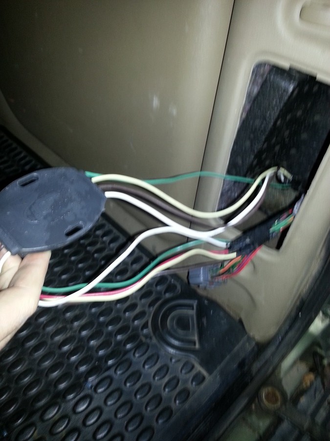

I went to Autozone, bought some standard 4-pin plug and adapter thingy for ~$10, and just cut/connected the wires to the new plug. Took 30 minutes, works great.
You can see the stock plug near the bottom/right, where I spliced in the wires to the new one.
