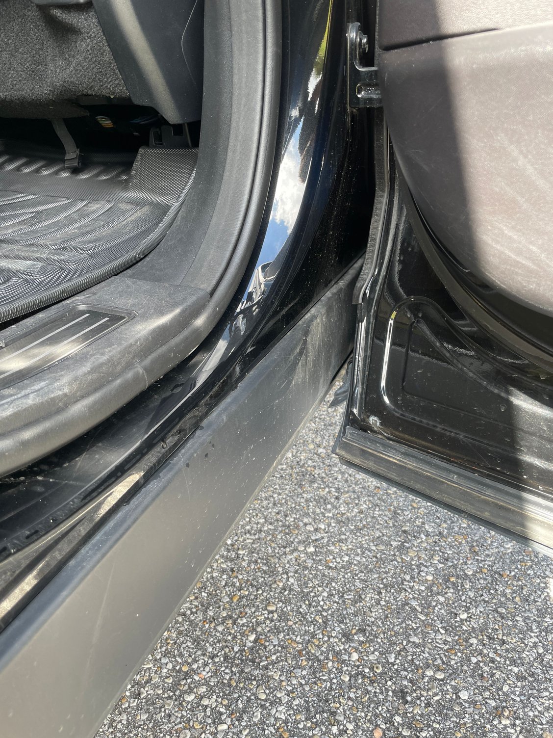

Has anyone else noticed water pooling in between the rear passenger door and the body in theirs, or am I a fluke? I forget to open this door for a while and notice a decent amount pooling from rain. You can see in the image where it typically collects.

Mine is getting water INSIDE the door, messing with the window motor etc. Wondering if others have this issue. Driving with the interior door panel removed now and I see water coming in while its raining.

Hello, have you been able to solve the problem with the water inlet? I have the same problem, today when opening the right rear door a large amount of water has fallen and I think it has also passed inside because the floor of the right rear passenger is wet . Excuse my language, I use the translator, Greetings from Spain.
