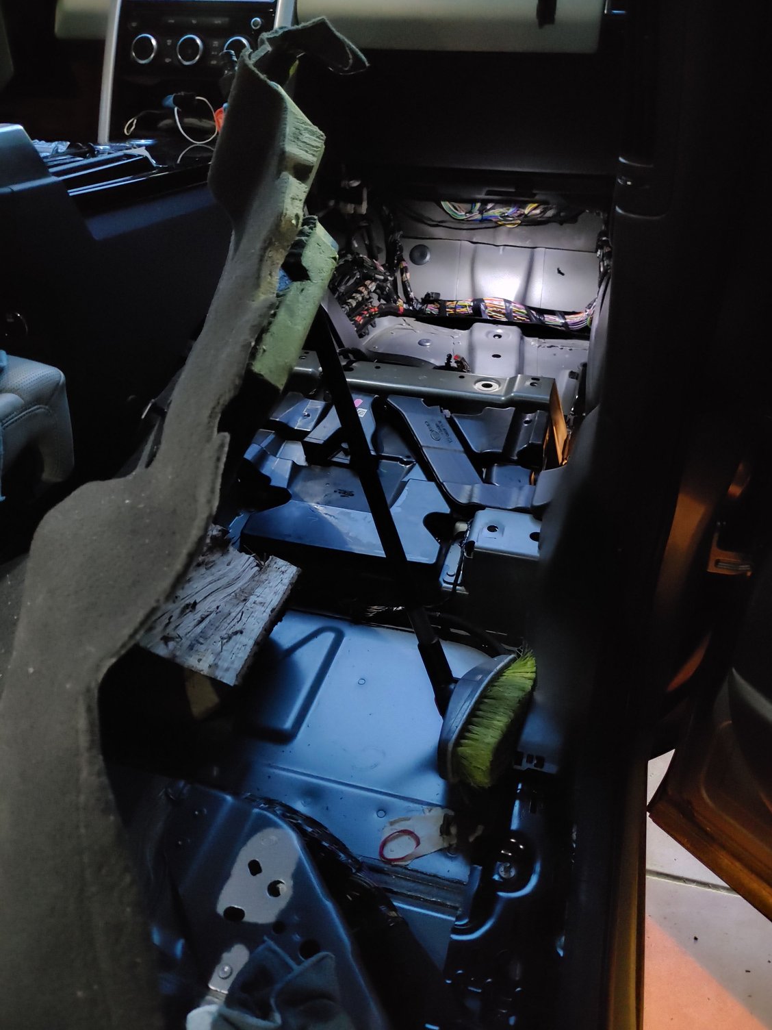

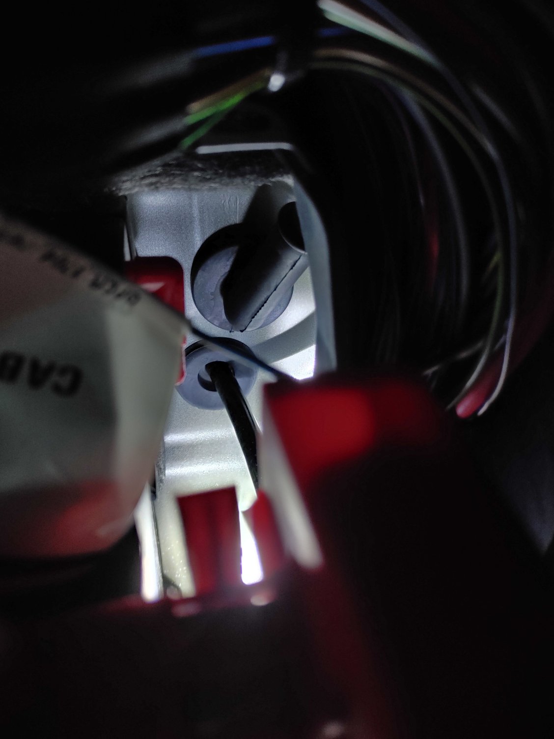

I hope I do not bore you with so many questions, I have removed the passenger seat and the right of the second row, I have drawn water to irrigate a part of the desert ...... I have located the connector through which the water should come out of the vehicle and it is apparently well placed, to access it, you should at least release the positive of the battery, it may be a rookie question but if I release the positive then it does not give alarms in the box? Greetings and thank you very much.

Hi Pernison,
Removing the battery will be fine. You have to disconnect it anyhow when you change a battery. I didn't have to remove mine to get to the tube.

Hello again, I'm still looking for the water to enter and I think it's coming in through the windshield and also through one of the roof drains, right now I'm trying to dry the carpet and the interior.

Hello again, I just removed the carpet from the third row of seats because I can't find where the water comes out, the roof drain pipe is well inserted in its housing, the one that was loose was the battery breather (which it's right under the roof drain) and I've already hooked it up. Any other idea to be able to search more? The windshield is going to be dismantled to seal it again. Cheers and thank you again.

Hello, I have checked that tube and it is not from there either, so I am running out of options, I have found under the third row seats a badly placed plug through which water does enter but only when the vehicle is running. The good thing is that having disassembled all the seats and removed the carpet, I have been able to dry it in front of the hearth fire, I have reassembled everything because in a week they will disassemble my windshield to seal it again and I hope that this will solve everything , I will inform you. Thanks and greetings to all.
