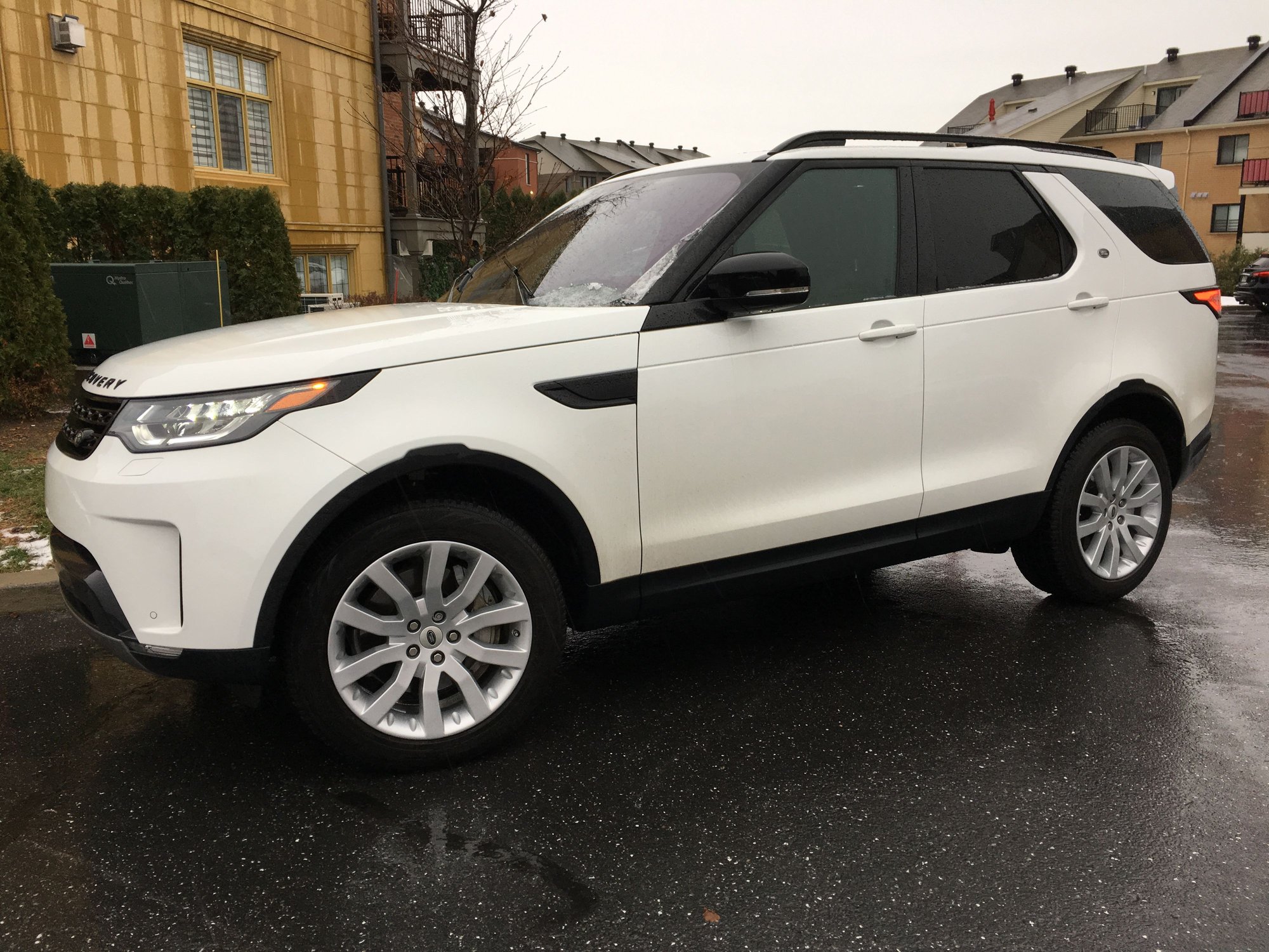

I'm running these (during winter) from the 06-09RRS:

20 x 9.5:
