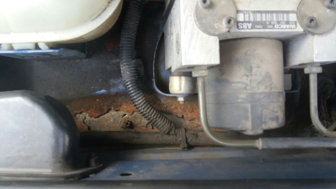

Hi all I am taking the plunge into a discovery 2 finally going over to the llandrover side. I am on I'm spanners etc so prepared for messing about and doing my own fixes aslong as nothing major or engine wise touch wood. Basically I have seen a well priced 02 discovery chassis is solid as a rock from what can see boot floor great no welding done on mots etc. Only ****le is slight oil leak but I can sort that my main thing is this slight bit of corrosion I'm not sure if it's a bad mot fail or if it's an easy cut and weld plate job. Any ideas or help as it's the only thing that's holding me back. I like everything else about it. Passenger side directly above the wheel arch.
Same again from differant angle

looks like a easy cut and weld to me. Nothing structural there that I can think of.

Thank you ever so much I didn't think but it was the only thing I was unsure of. I know has slight oil leaks and I am prepared fix them as hopefully just seals. Got some underneath on the box and some one the right side where the acs was but could be oil return I'm going investigate more n start the journey of spending money lol. Love landrovers tho
