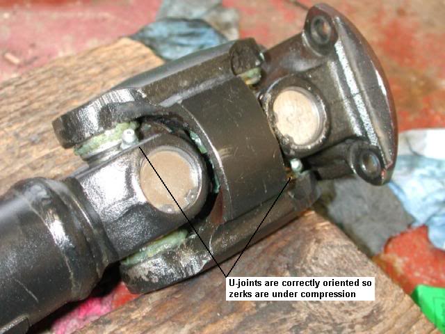

Drive shaft is a must, off road or not. It is not "switched off". See write up in our tech area about rebuilding front prop shaft. This part does not come stock with grease fittings, so when they dry out bad things happen with little warning.
