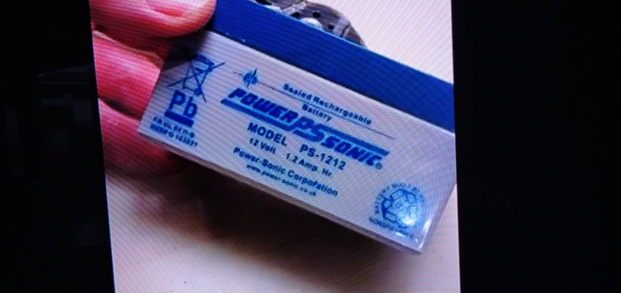

Under the glove box there's a cover for the fuse box, remove the cover and you will find a backup battery as per pix.
If it goes faulty and wont charge all sorts of errors appear, one of them is a gear box fault error. Good Luck
