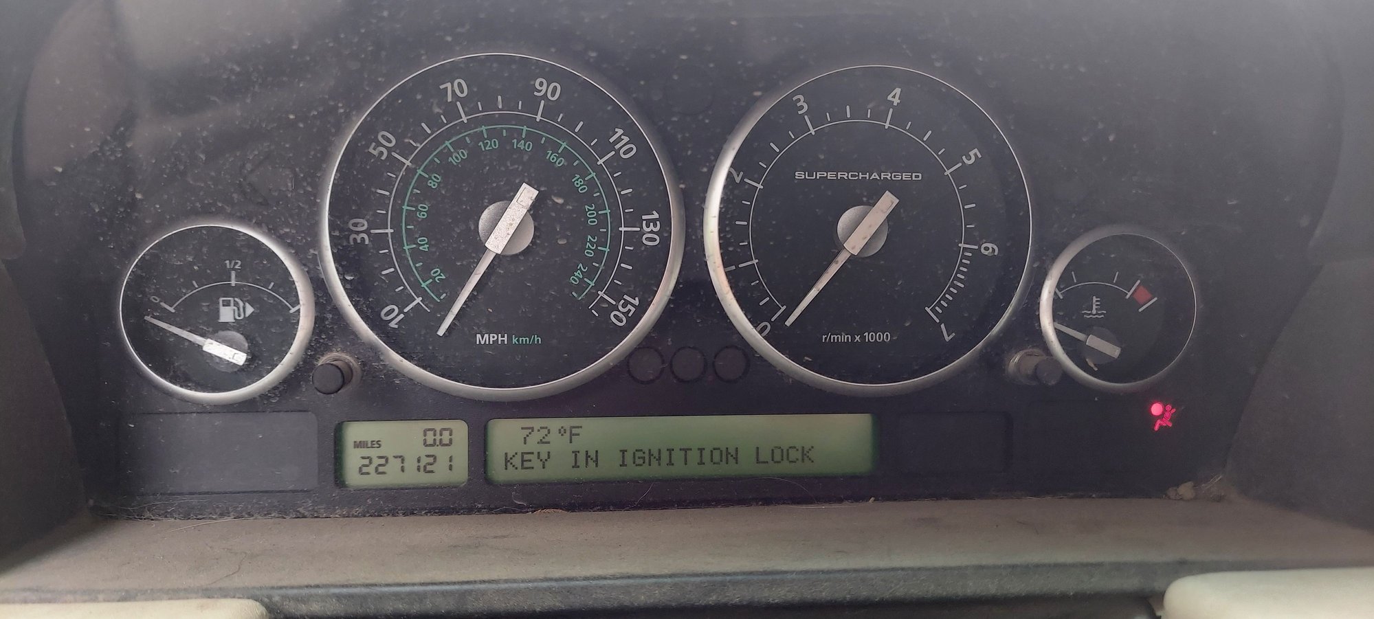

18- I had been so busy with all this so far that I didn't realize that when I turn the key to the first position, the radio comes on, all lights are on, BUT the only light on the dash that comes on is the red air bag light, not the fuel gauge, no other lights.

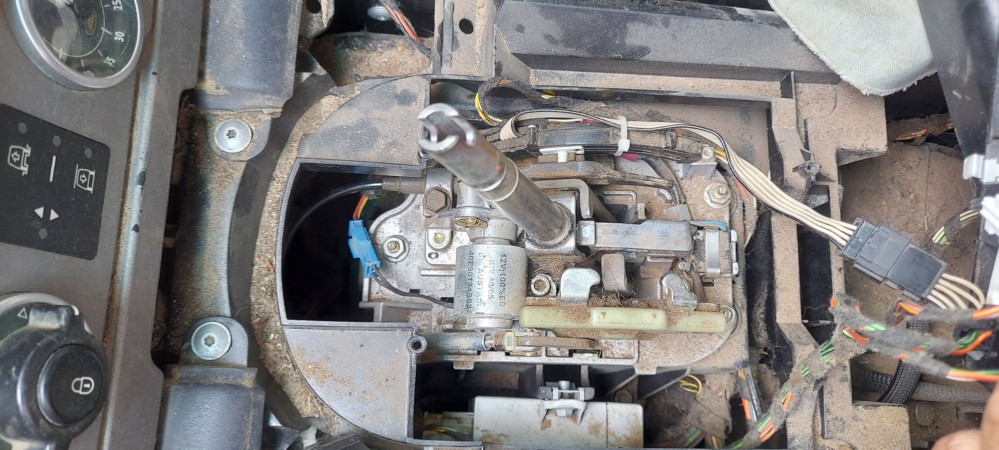

Of course I've rechecked all fuses, I went back and exposed the ignition switch to see if the connection to it is wet, dirty, cut, but it's so hard to get under the ignition switch that all I can do is stick my fingers down there and try to wiggle it, but it's hard to imagine it would be the key switch since some of the dash comes on.

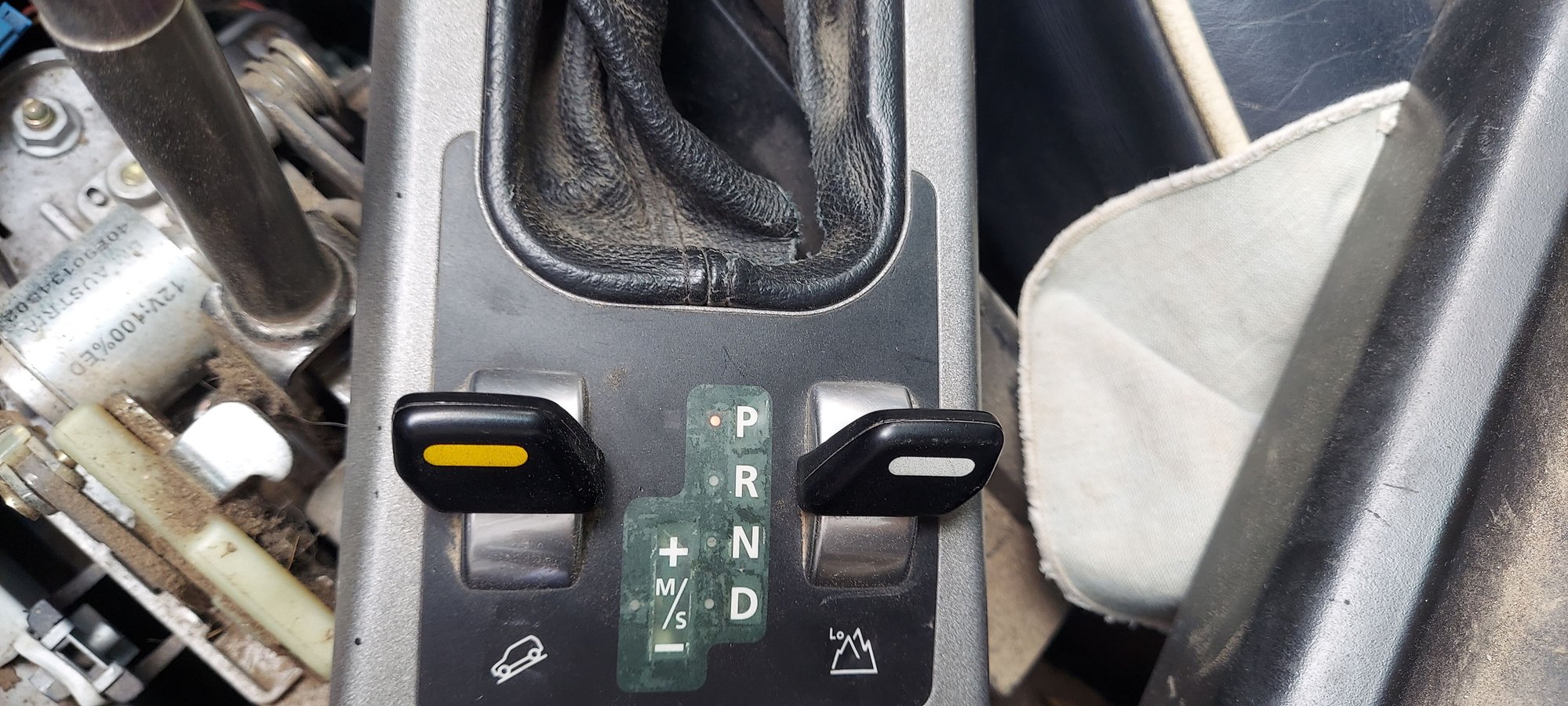

Only working indicators

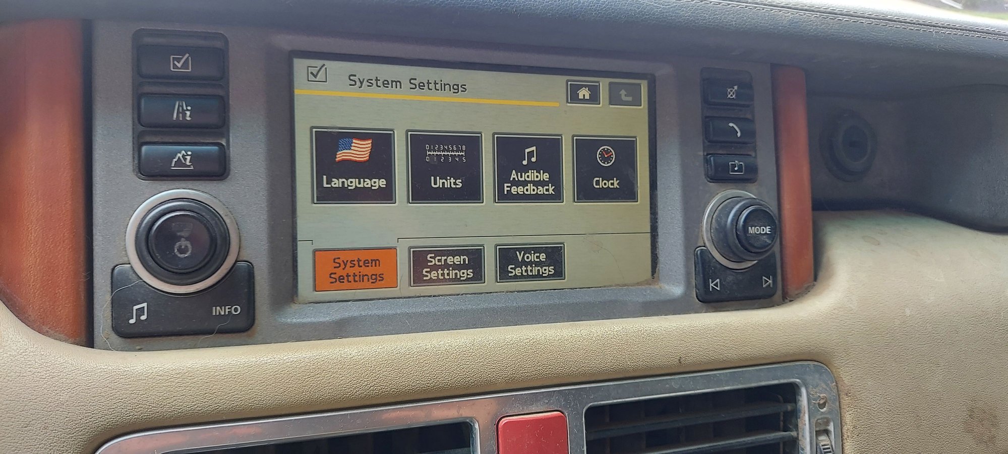

It appears nothing works in this picture
Gear selection light is on
About as far as i could get to the ignition switch

The ignition switch is rarely a problem. The stuck key problem is caused by not working solenoid on top side of the steering wheel column.
The solution is to drill a hole to put some solvent (I suggest IPA) it and get it unstuck. Grease thickens over time and clogs up the steering lock mechanism.
