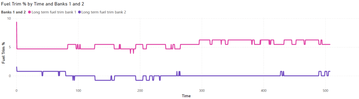

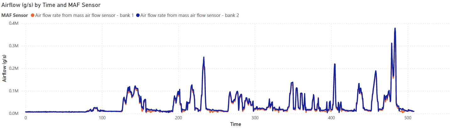

Today, I logged the #1 O2 sensors, #2 O2 sensors, LTFT values, and MAF sensor values during a short drive around town. (The IIDTool wouldn't let me add the #3 O2 sensors. I guess it has a limit of 8 sensors for logging. I'm assuming the #1 sensors are the pre-cat lambdas, the #2 are the mid-cats, and the #3 are the post-cats).
Here's some things I've noticed, but I'm not sure whether they're relevant...
  • The LTFT for bank 1 is always between 4% and 8%, while bank 2 is around 0%.
  • I had to replace the mid-cat O2 sensor on the driver's side (LHD) because it broke during removal. But the driver's side on a LHD is bank 2, right?
  • While watching the mid-cat O2 sensors on the IIDTool, bank 1 remains pretty steady around 0.750V, while bank 2 will often dip down to around 0.300V. Is this normal?
  • The MAF reading for bank 1 always reads about 2-4kg/h lower than bank 2. They both go into the supercharger, so this shouldn't make a difference in the air/fuel calculation, right?
This problem is starting to drive me crazy, so any help would be greatly appreciated!
I've attached some graphs of the sensor values from a drive around town today...
