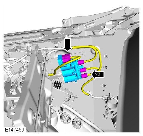

On my 2016 RR L405 TD6, the front suspension drops overnight. I bought a new front solenoid valve block because in most cases that seems to be the problem. However, I can't find it on my Rover. On my LR3 it's under the passenger front headlight but on this car, I can't seem to find it. Some help would be great.

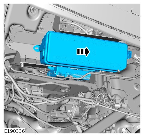

1) Depressurize the front springs
2) Remove the battery ground
3) Remove plenum chamber panel under the hood
Good luck!
