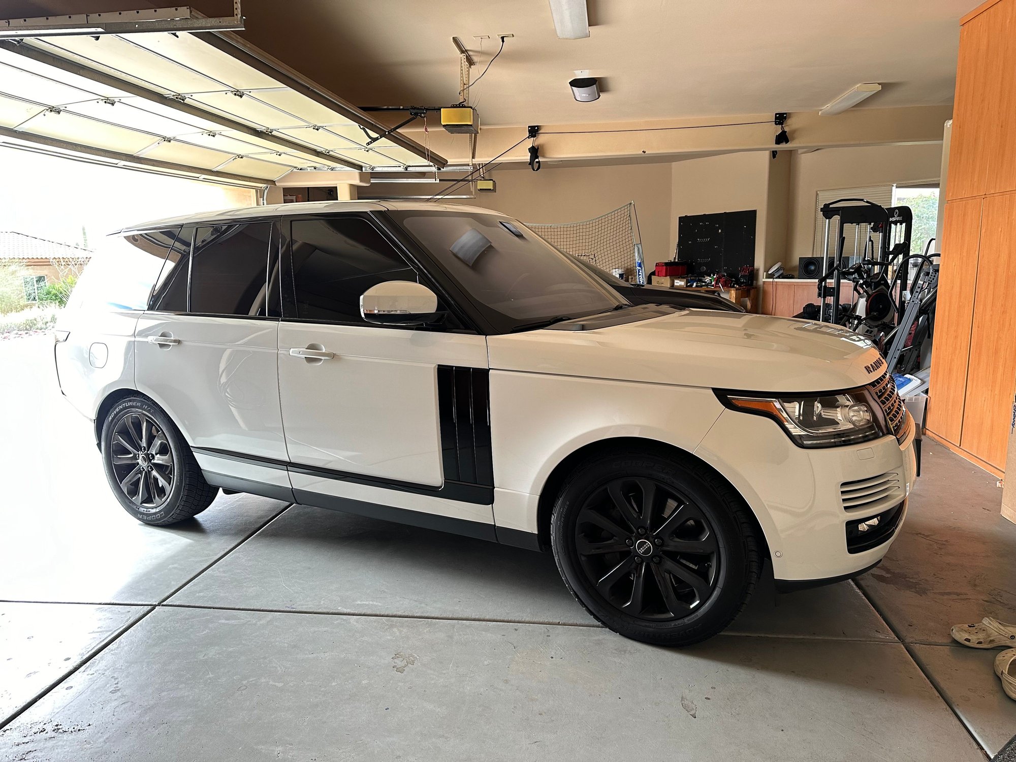

Hello! I have owned a few rovers in the past, most recently a 17 RRS Dynamic which was trouble free from 20k-75k miles!
I had the itch for a full size as a play truck and found a high gem that has a persistent 0170 code. I just changed plugs, pvc, oil and cleaned MAFs. Needed all of it anyway.
There is 0 performance issues, as a matter of fact it’s running stronger then when I bought it. But after 3-5 starts and 50ish miles, I get the code.
Next I would presume is the O2 sensors. Are they covered under warranty? Should I just replace them myself or deal with the dealer? Thanks!
