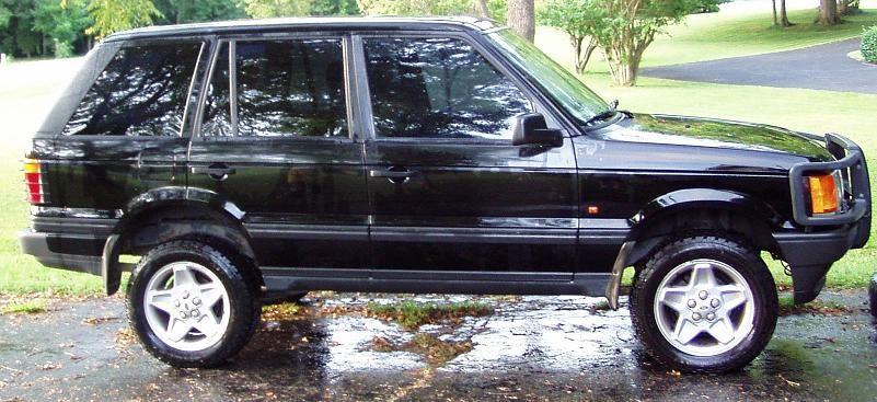

I had stock airbags leaking and replaced with Arnott Gen 3. I kept them through a pump replacement, then multiple height sensors, then air lines... I finally went to coils when I knew I was going to sell it to a less mechanically inclined acquaintance and he was concerned about the suspension. I went med duty OME springs which raised it about 2". I know I have pictures with the Arnott springs on it, and I'm sure I have pictures with the coils (but will have to find). I will try to post pictures over the next few days if you're interested.

Well, I found a picture after the coils were replaced, but before the new tires were mounted. I believe the tires were 29" at the time of the picture and were being replaced with a 31.5" or so tire. The gap in the wheel arches was huge before the new tires, but after it looked a lot better. FYI, it is sitting on a slight hill, so it isn't actually sitting high in the front. I think I took the picture to show the customer that it wouldn't look right without new tires, but he was happy knowing he would be running a significantly taller tire than what was in the picture. All I can tell you is that he thought the Rover was great and was still running it years later when I lost track of him. The only pictures I can find with the Arnott springs is when it was turned off and in the lowest position, so there isn't any comparison to be made. I thought I had before and after pictures for the customer, but it's been so long I can't find them.

That’s a beautiful looking P38
