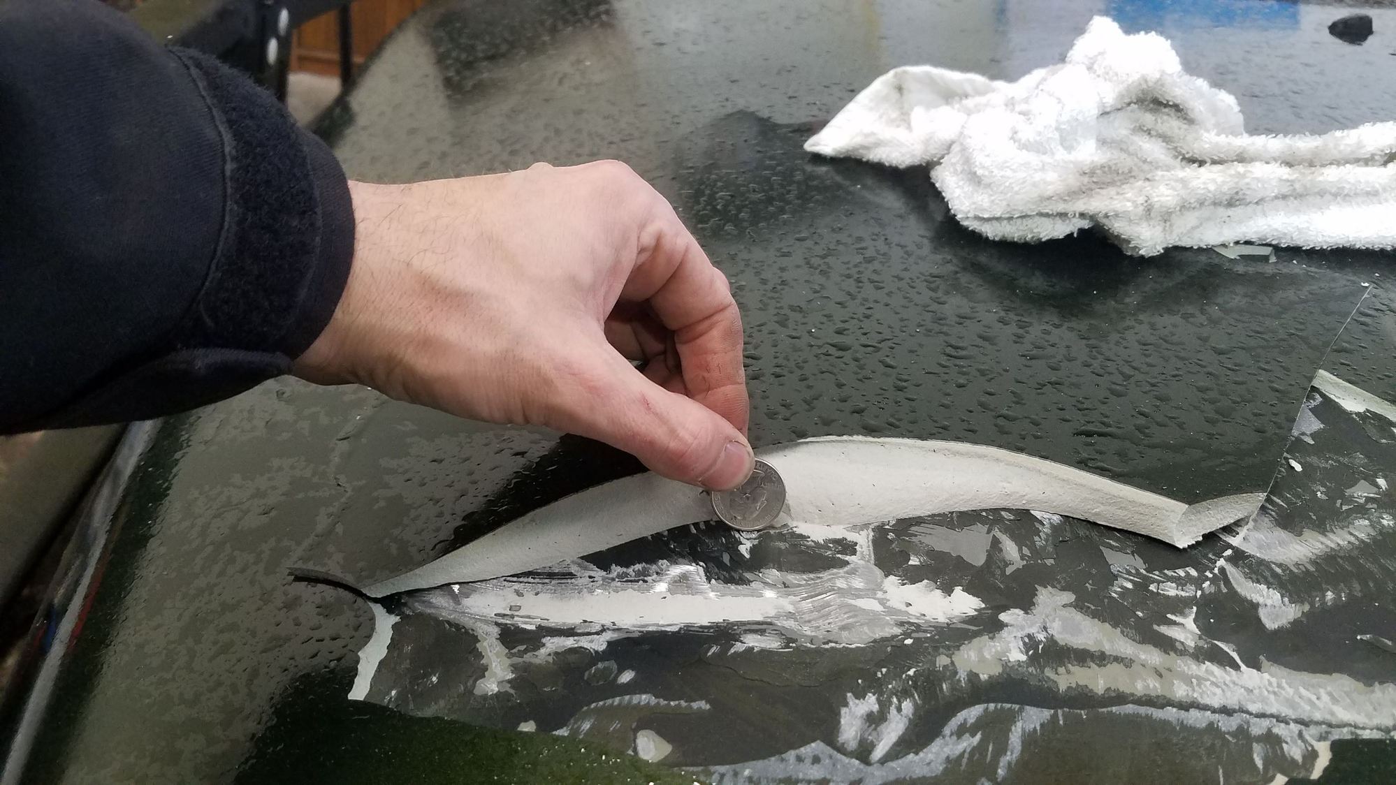

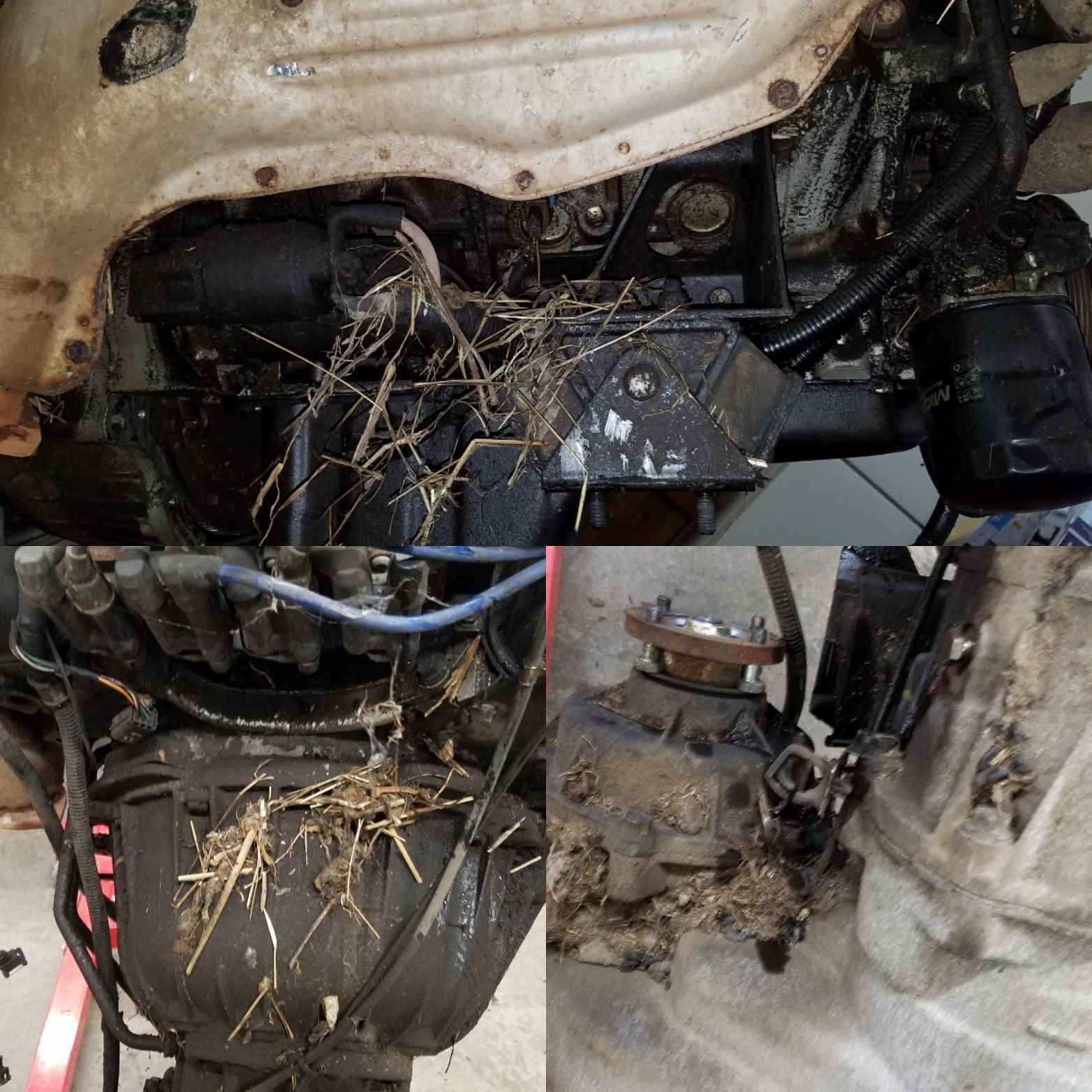

Now for the bad: The EAS isn't functioning correctly, the rear is stuck up and the front is all the way down. It sat for over a year and there was something living in the engine bay and the entire thing stinks like rodent urine. Aside from the seats the interior is pretty beat up; lots of broken and missing plastics and a cheap aftermarket head unit. And best of all, under over a inch of body filler the hood was completely ruined. That leads me to go on a full inspection of the entire body looking for more damage. I was noticing today that I think a lot of the glass is aftermarket replacement. The truth is that if the body is thrashed, I'm just going to destroy it all the way and I'll plan to salvage the motor into the red.
That's a quarter in my hand.
Hidden under over an inch of body filler.

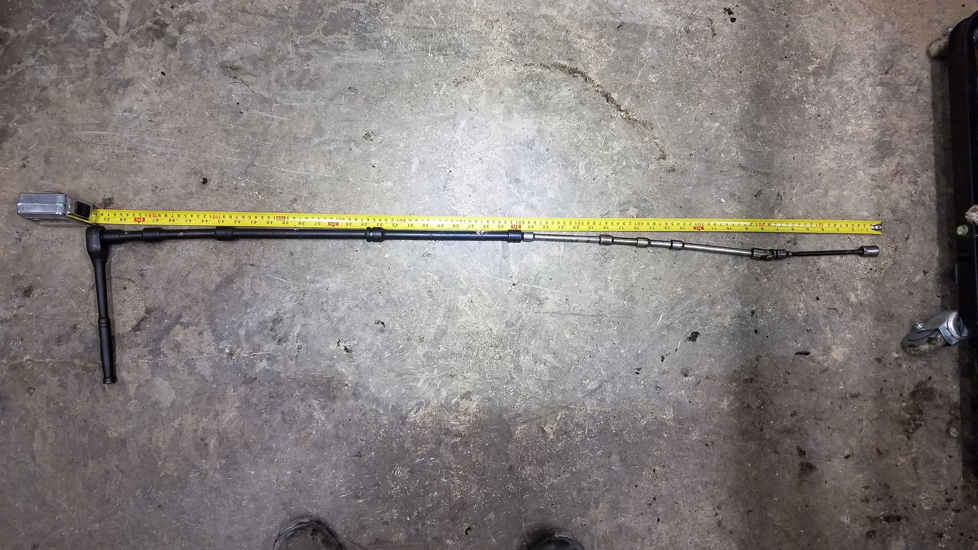

I'm swapping the motor. Getting to the TC bolts without removing the oil pan was nearly impossible.

How I removed the torque converter bolts. Talk about tight clearance.

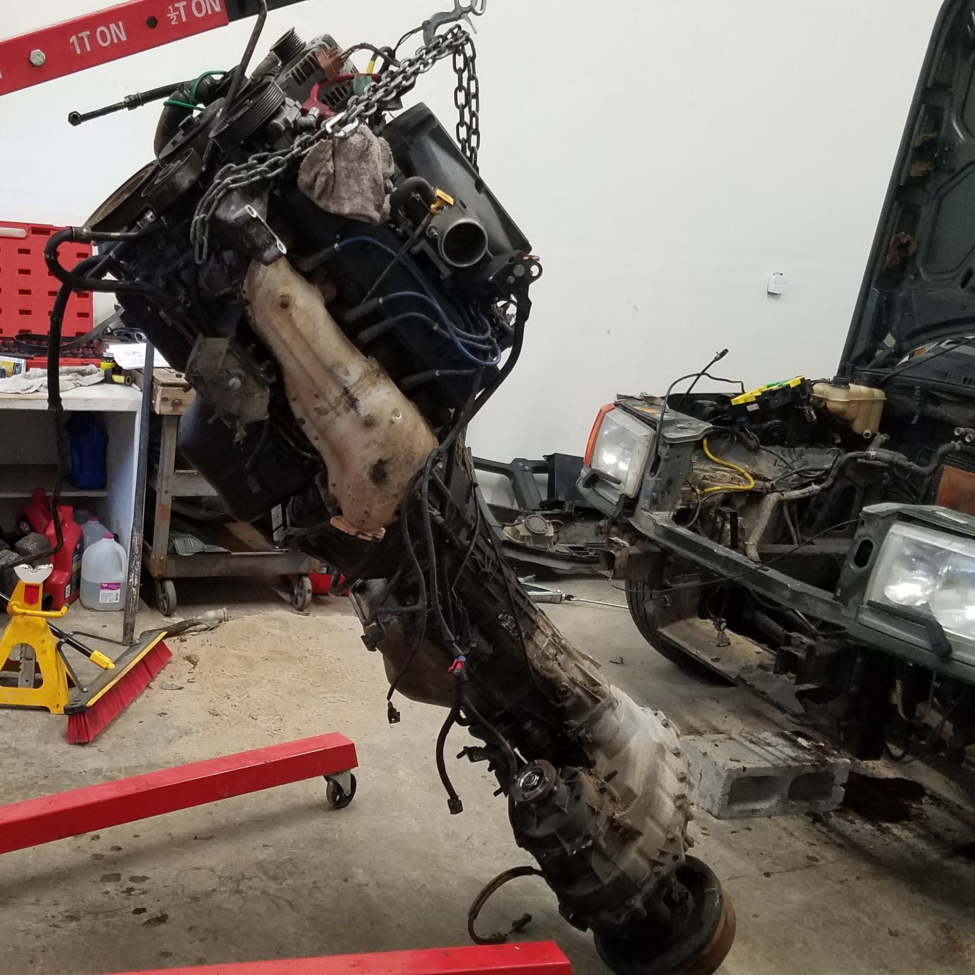

I don't know how people do it. How in the hell does one pull the motor without the transmission? The torque converter bolts were nearly impossible and now I can't get any leverage on the bell housing bolts. Screw it - I'm taking out the whole assembly.
I'll separate the trans after I get them both out because I'm 99% sure I need a rear main seal. Not only is the entire motor caked with old oil, the bell housing access plate was also soaked, and some of the oil looked fresh.

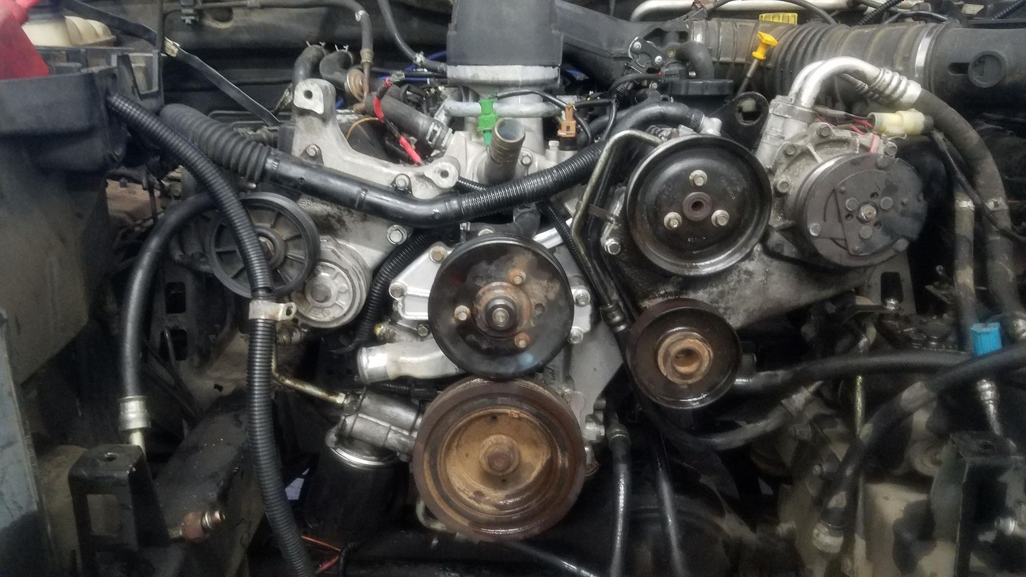

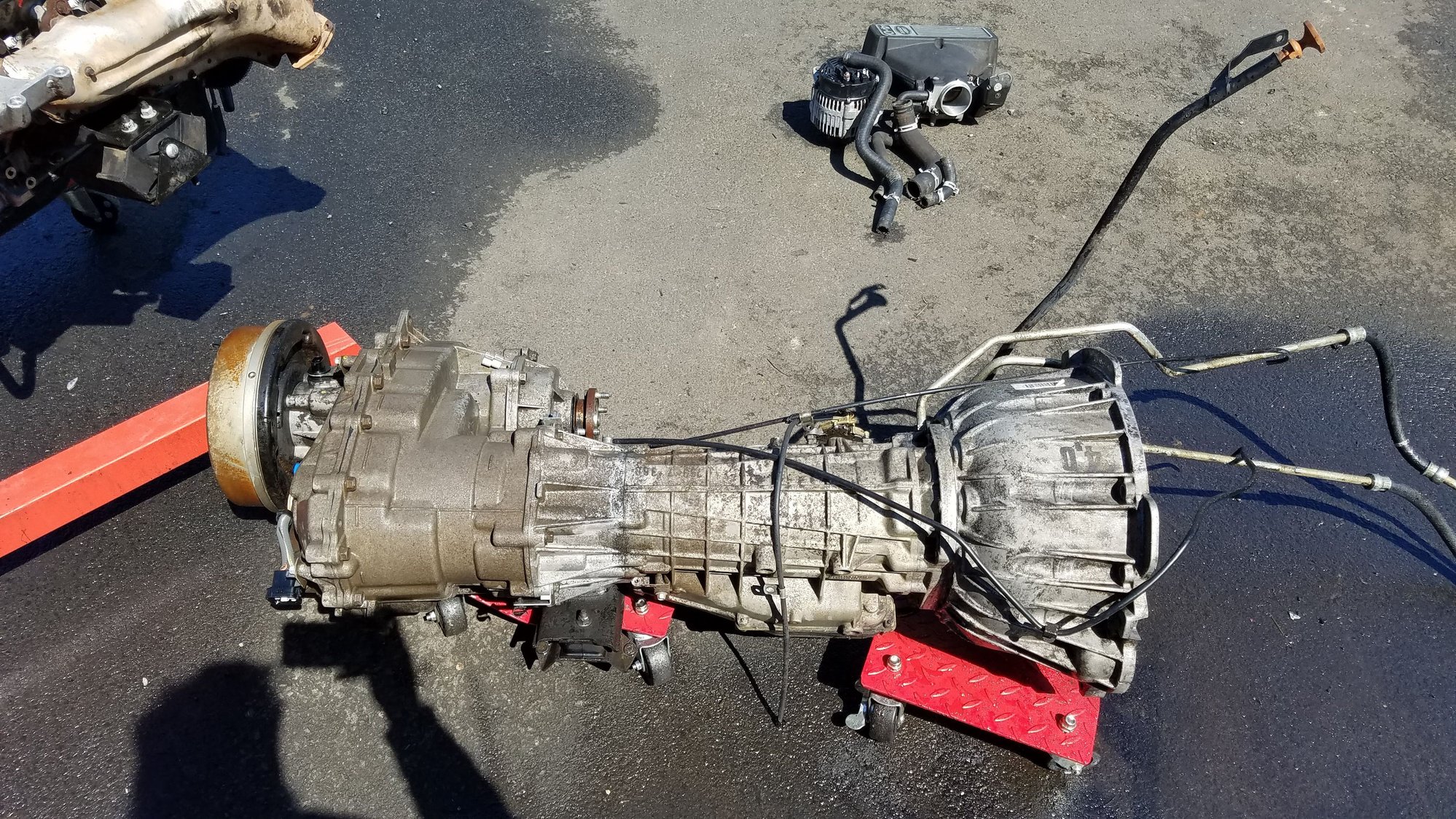

And it's out! In the process I can see how it's pulled separately. Drop the trans and MAYBE get enough room to detach those top 8 bolts in the bell. No thanks. I think I prefer pulling and installing as a single unit.
I really need a leveler tho.
This monster.
Dirty rodents!
Separated and ready for service.
Now that part's done and it's time to clean and service this!

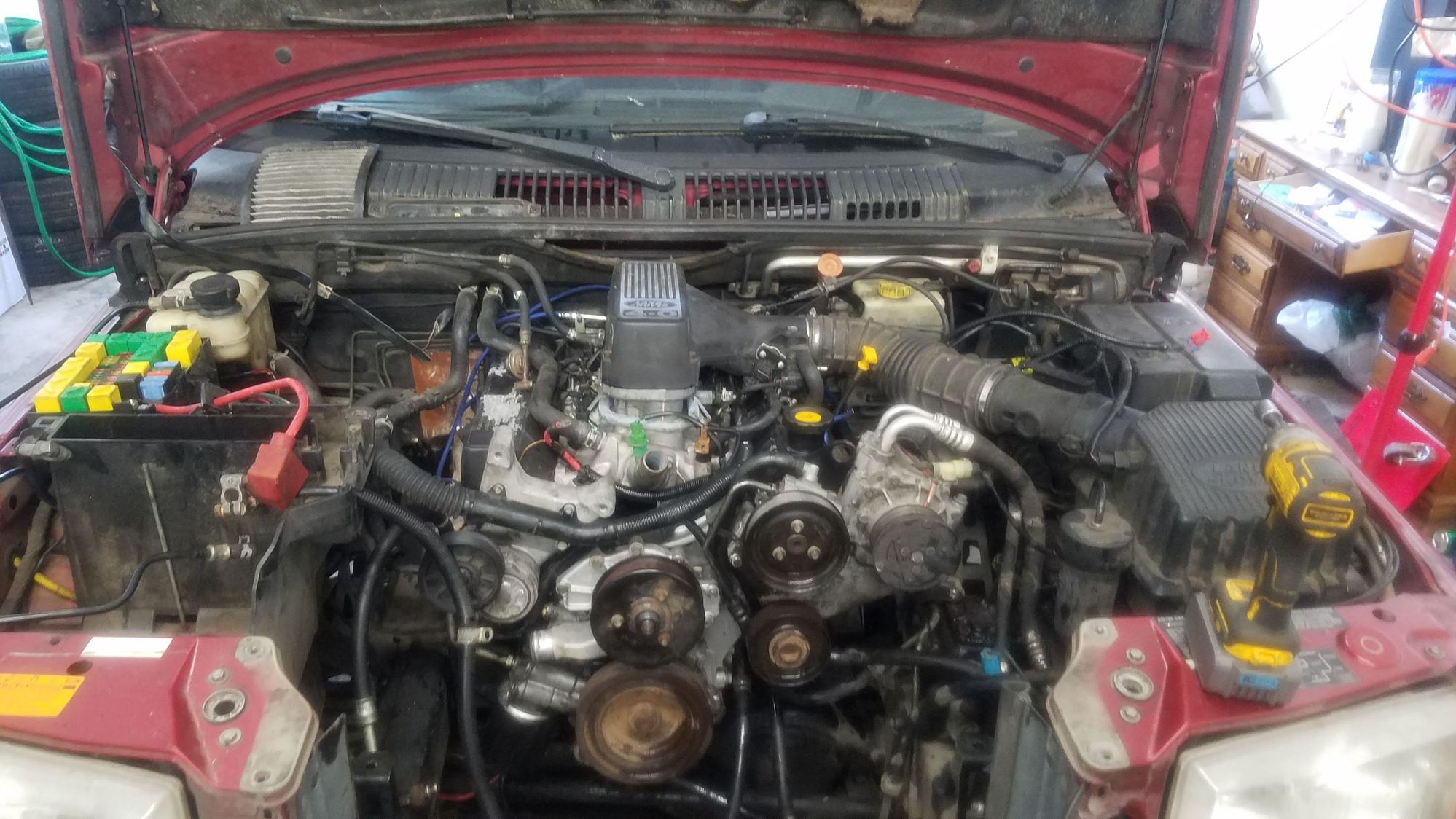

Old May 5, 2019 | 01:11 PM
JonnyObnoxious's Avatar
Joined: Apr 2019
Posts: 16
CLEANED UP AND INSTALLED!

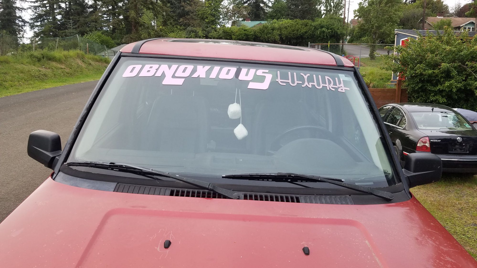

Turned out my alternator was just not fully attached. I need to put a lug on it; it's just bare wire right now. But I'm driving her daily and have begun fixing up nuisance problems. I've got 2 windows not working, bad side mirrors, and an aftermarket stereo that's not working correctly. I found a bunch of things unplugged insde the door, but that's not an answer to the problems yet.
Here's a few current pics!
Probably the highest point in Toledo, Oregon. Pacific ocean in the distance.
On the way up the trail.
Windshield banner
Always Be Gambling!
Hood logo
Rear gate logo
Rear windshield
