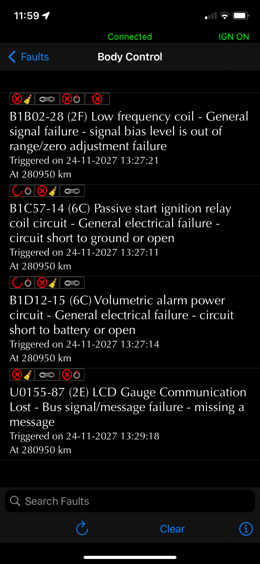

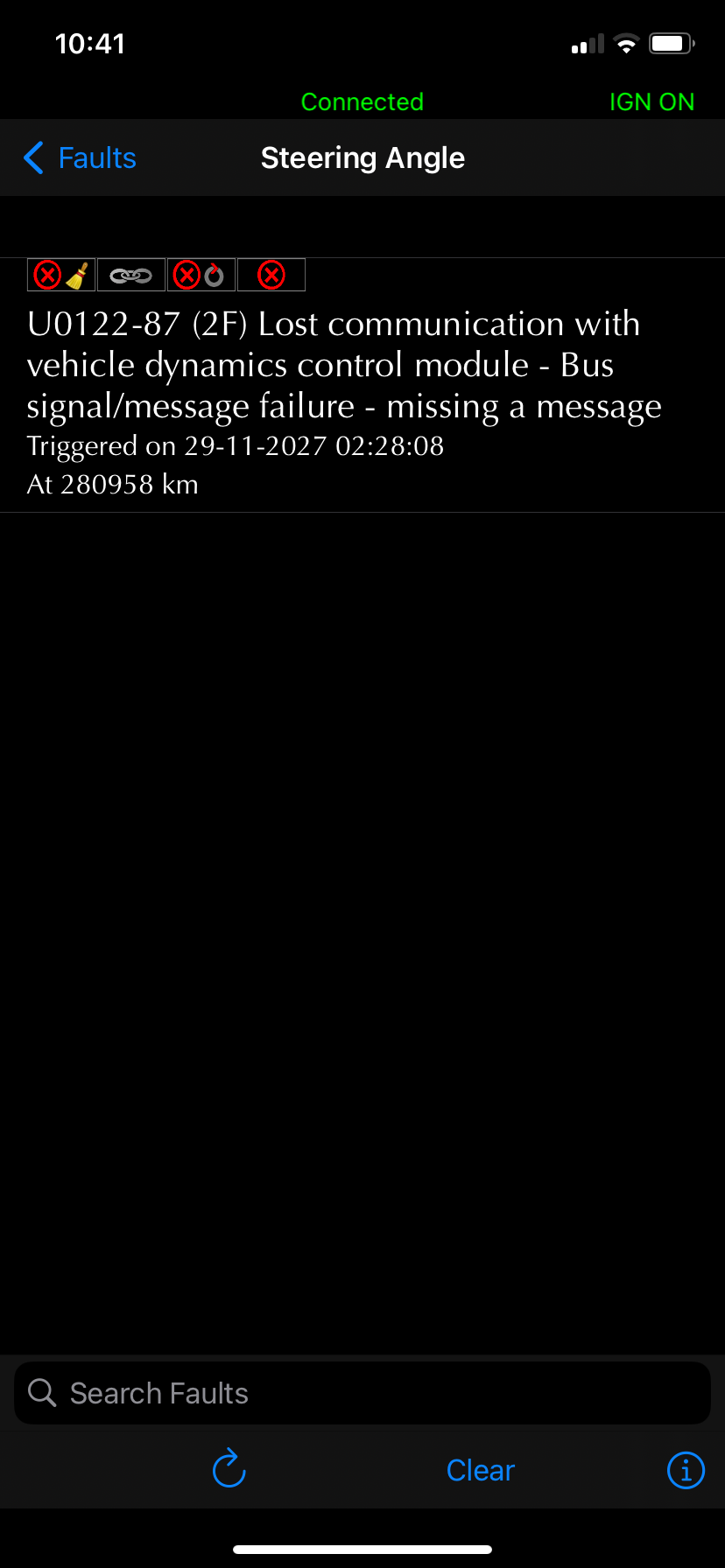

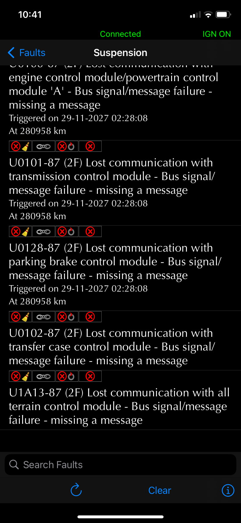

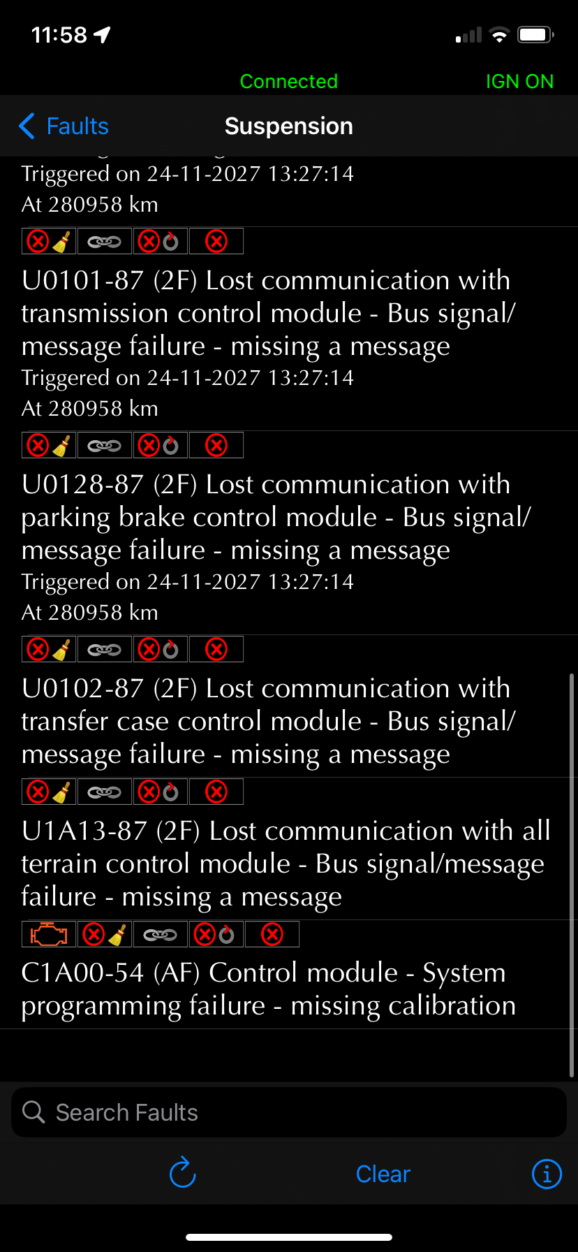

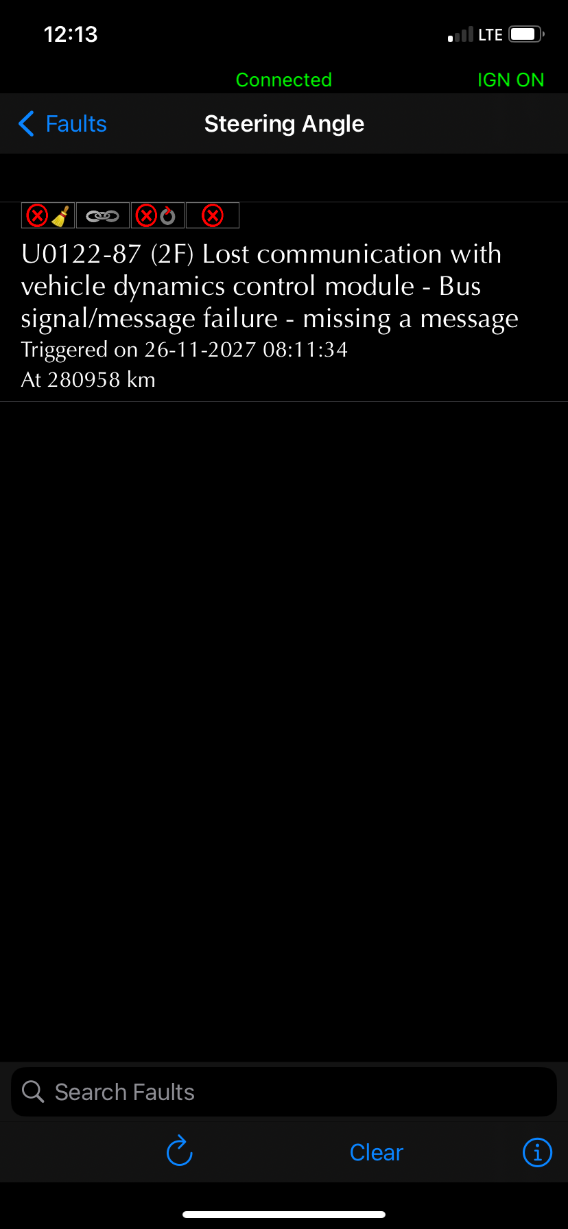

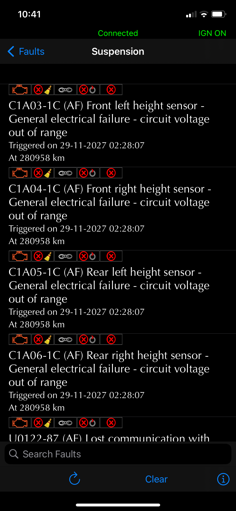

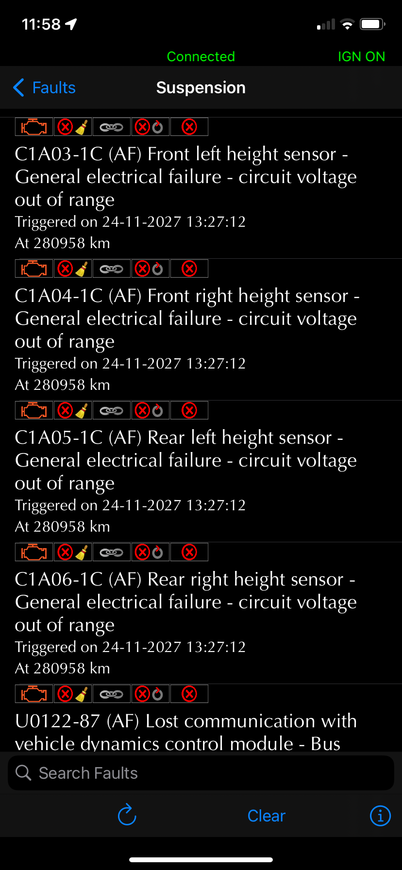

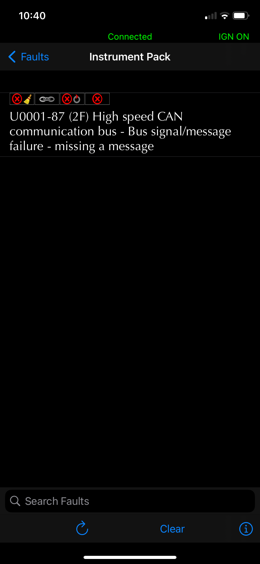

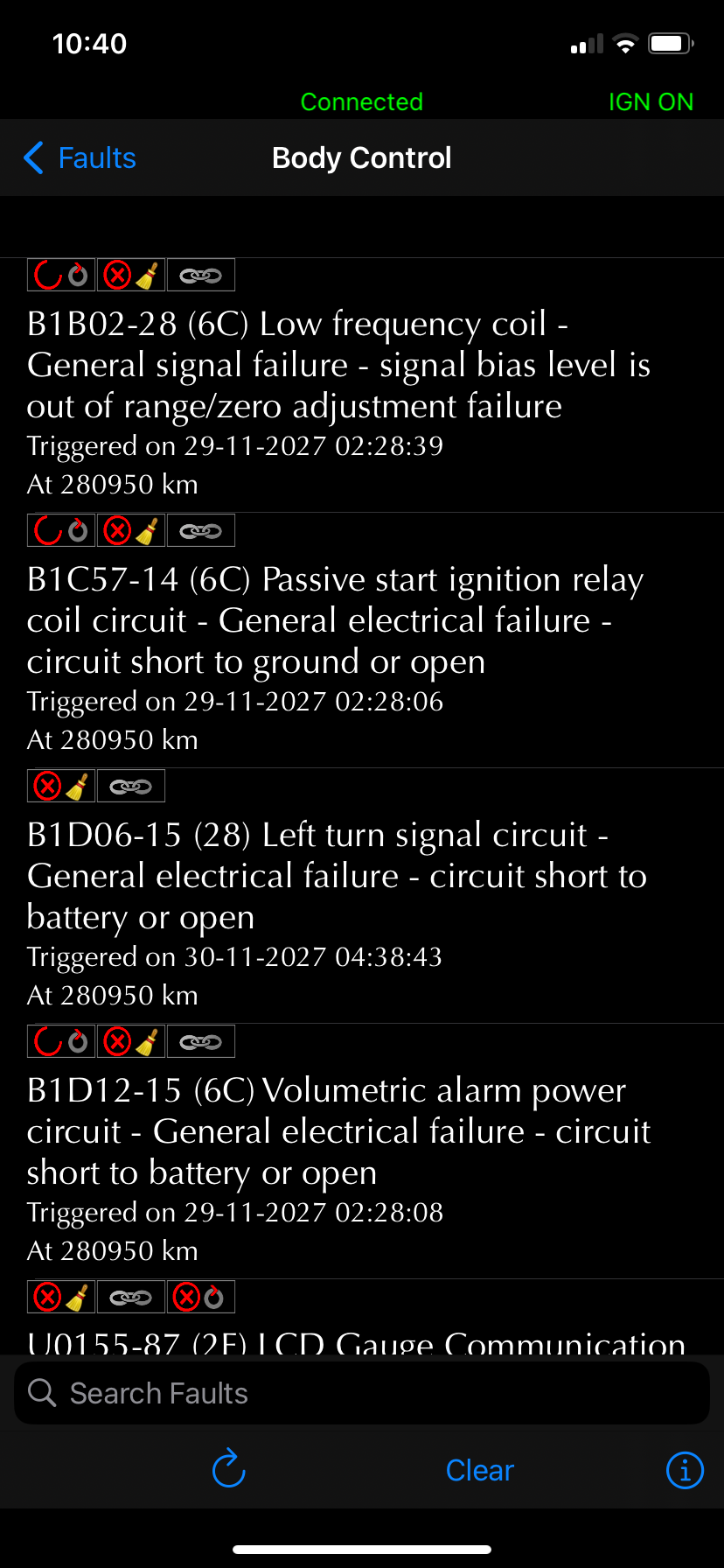

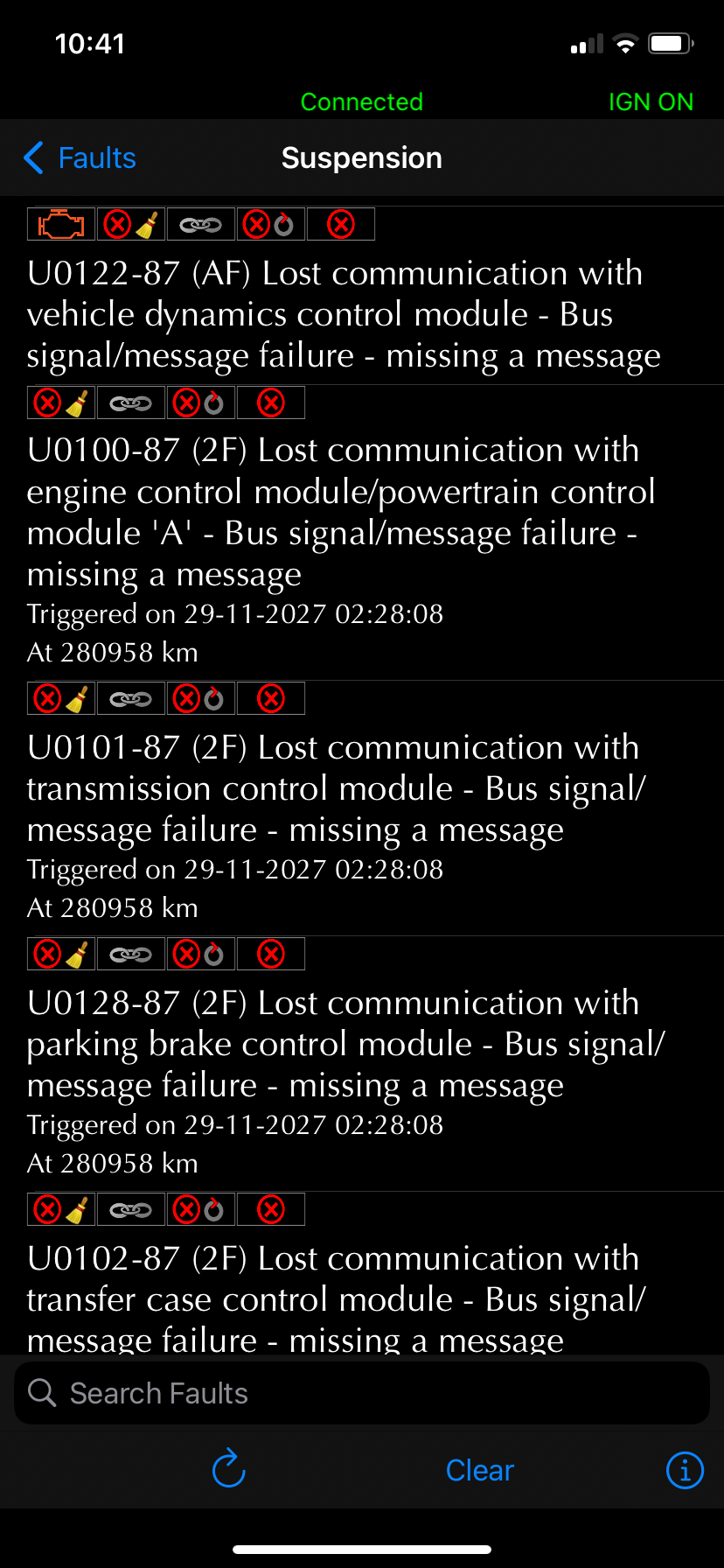

Ok. Scanned again today with the GAP tool
and the instrument cluster was back. I was not able to communicate directly with the ABS. Every function I tried to perform ( even a mock brake bleed) came back with an error. I disconnected the battery and pinned 6&14 and I got 41.1 which seems odd. I checked several times and it was always between 42-41.2. Here are pics of the most recent scan.
