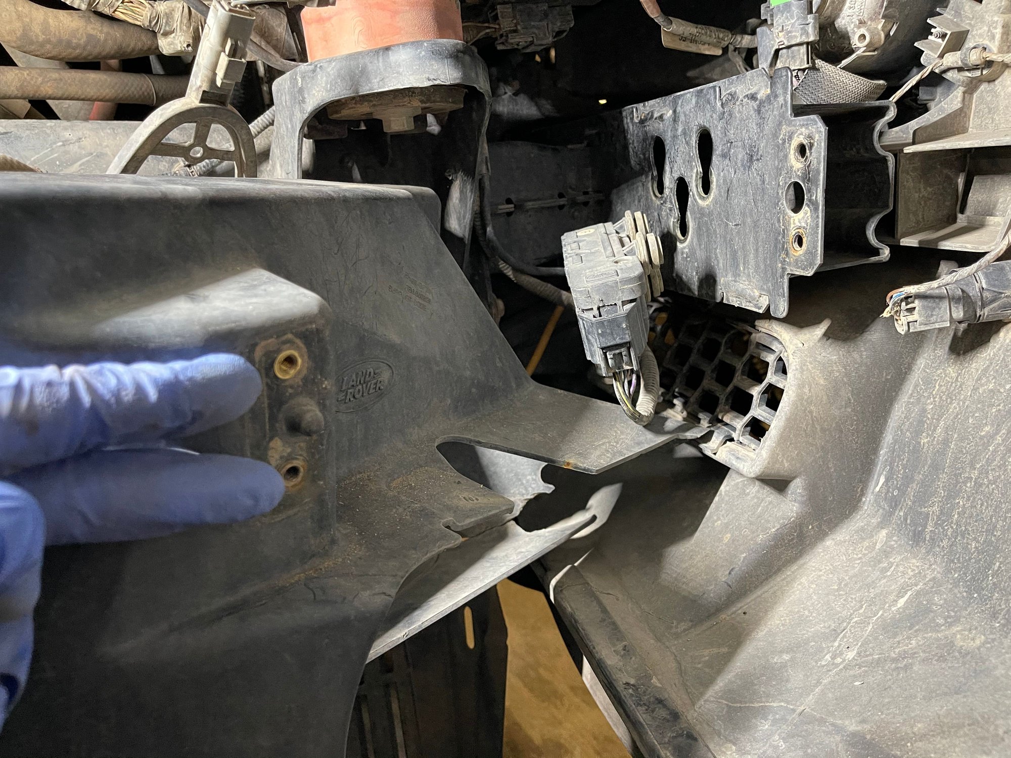

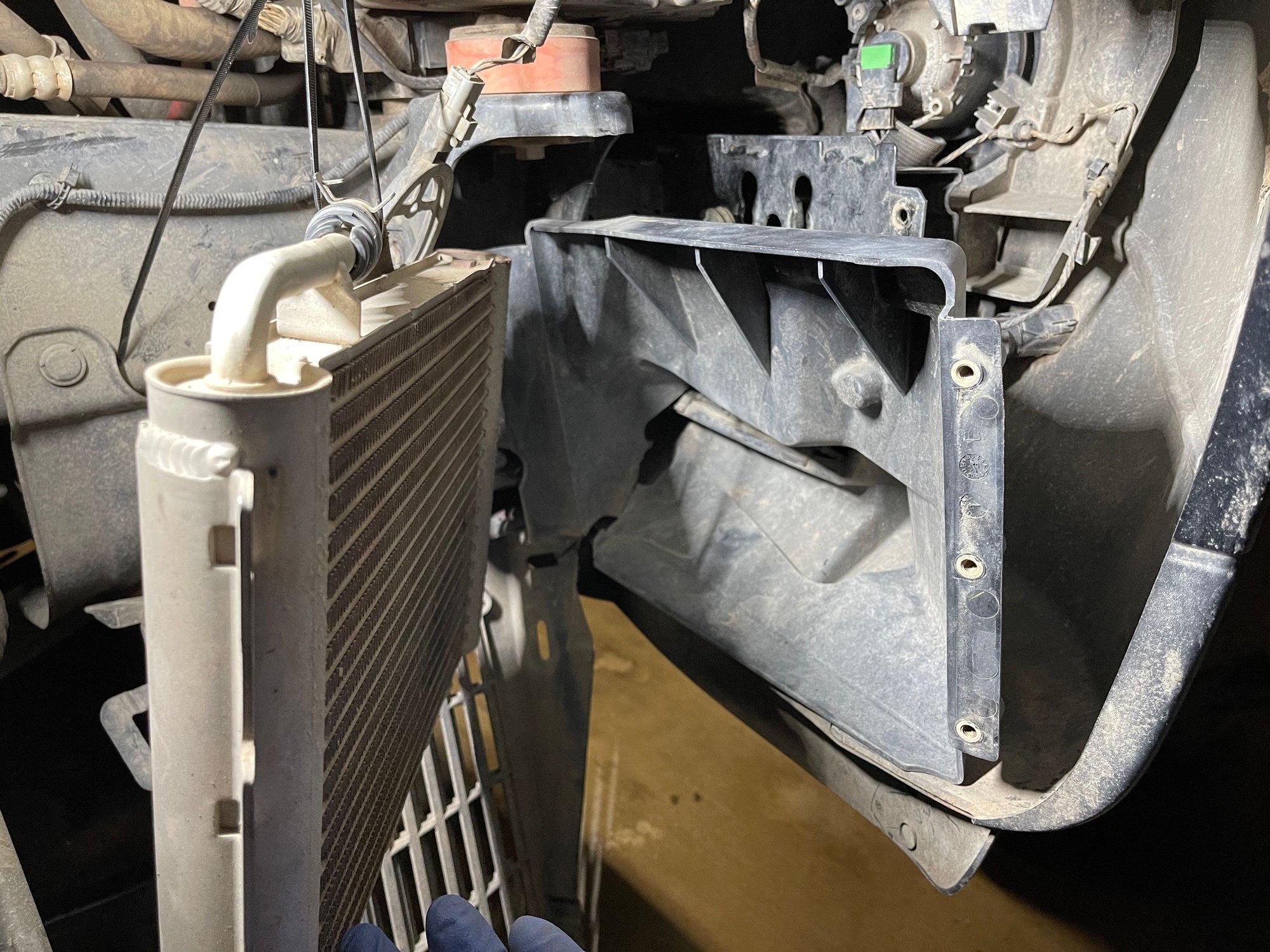

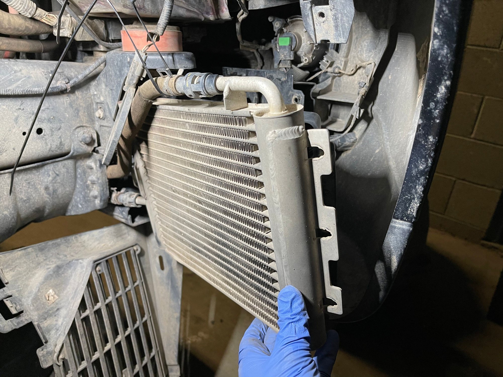

All,
Just chiming in here. There was no way I was going to remove the front bumper. There are 5 aux radiator bolts (2 on the left, 3 on the right). From there hang the aux radiator. Next there are x2 8MM bolts that you can see from the back. Reach round on the right side and you can feel the two bolts.
Now you're golden.
