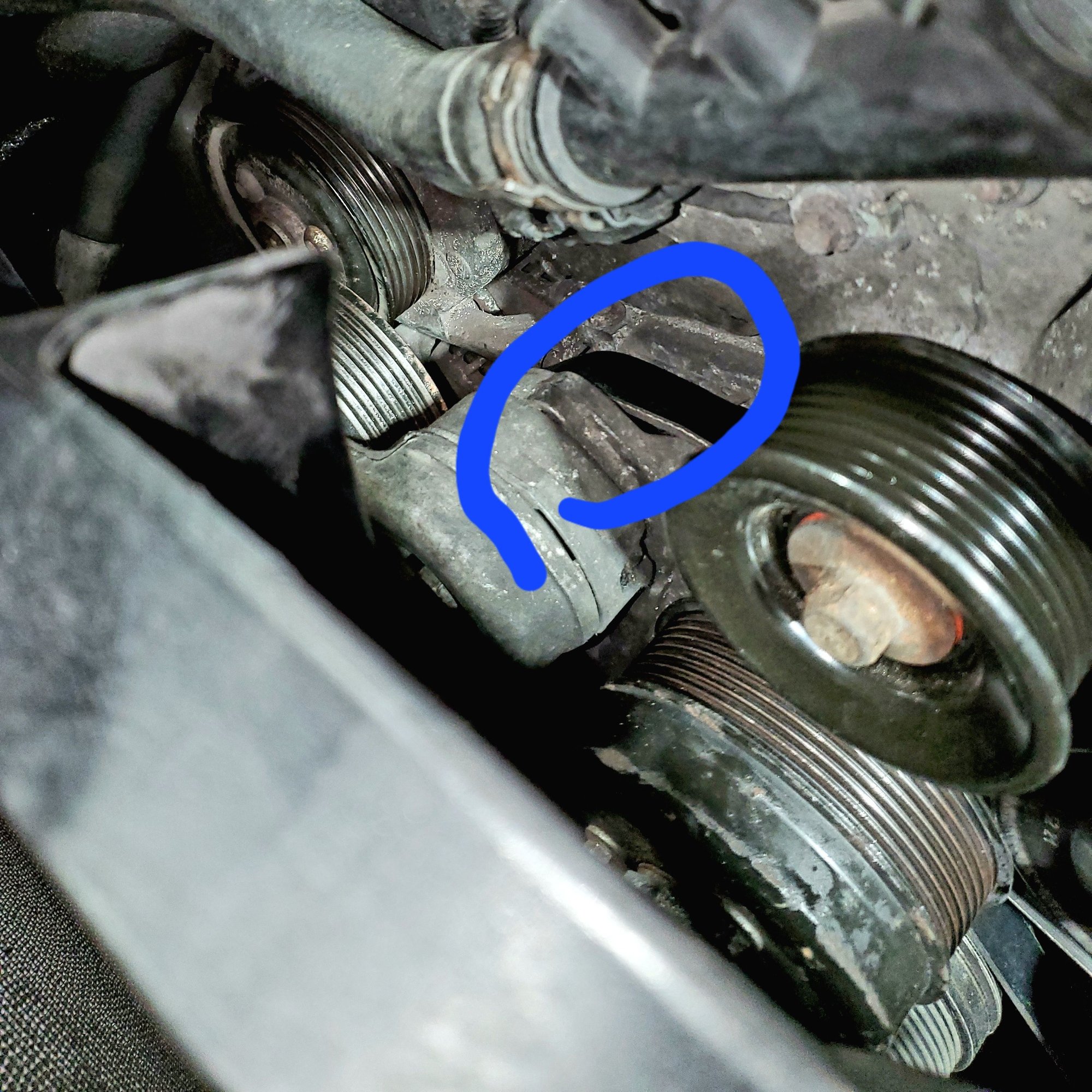

Hello guys,
I have a RR SC 2010 5.0L that I need to bypass the ACE pump for the moment could you guys help and guide me through the replacement I tried to follow what in the thread but my mechanic keep bumping with the belt tensioner. (Photo attached )
Any help would be greatly appreciated !
