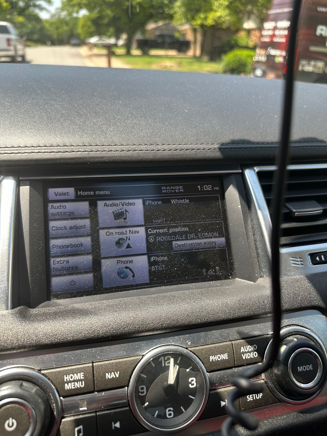

Just want to make sure, these are the factory screens correct? If so there should be controls on the screen in the front. Can you post a pic of the rear screens and the home screen of the front center screen

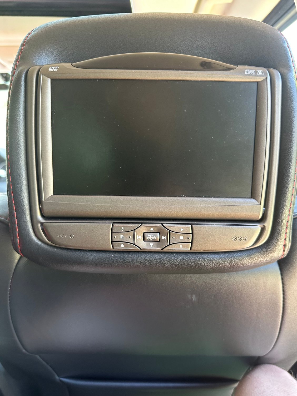

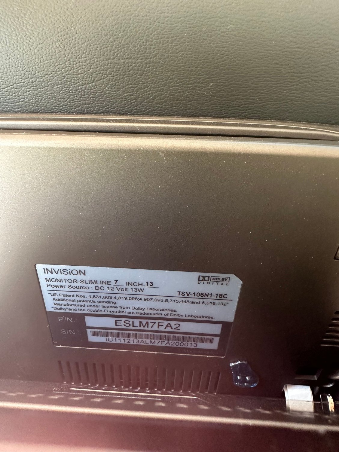

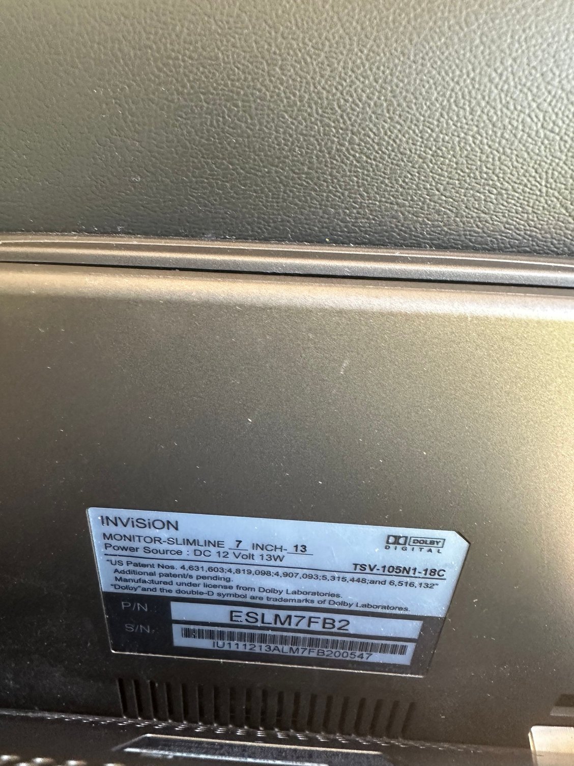

Default Pictures of the dvd players in my rover
Drivers side cereal number
Drivers side screen
Passenger side screen
Passengers side cereal number

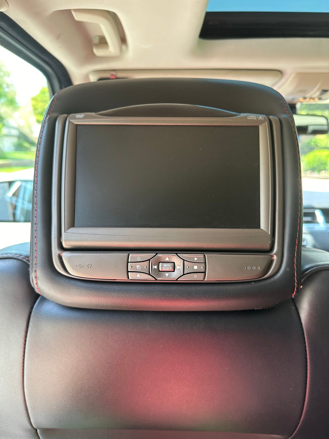

Default Screens in rover
Sorry took so long to post but thank you for your help!

That is not the factory rear entertainment system. That is a dealer installed aftermarket system. Here is the link to the company, maybe you can reach out to them and get the remotes and headphones.
https://www.invisiondirect.com/
