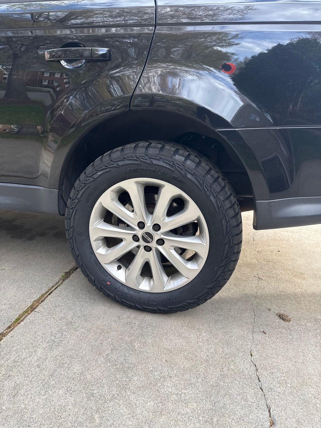

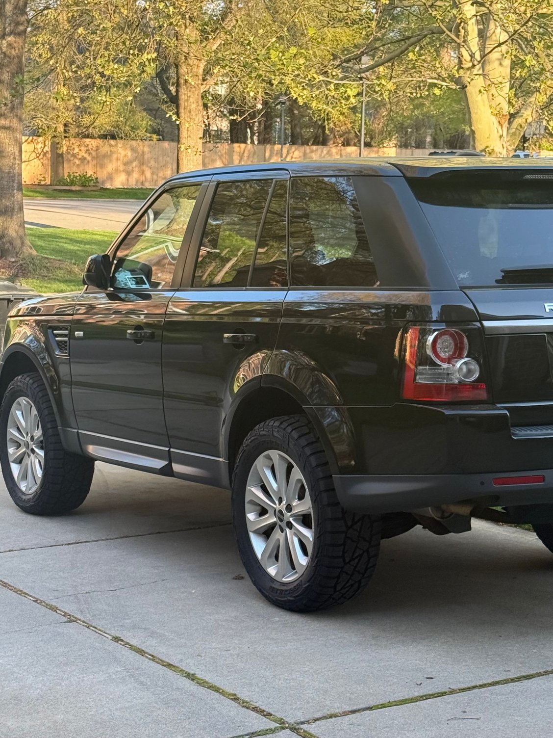

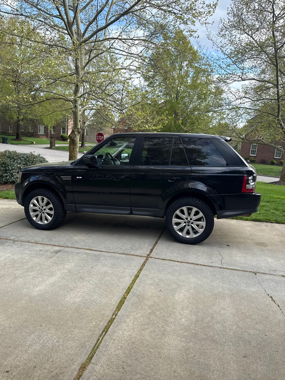

Have a 2012 LR Sport and had suspension conversion done to avoid replacing the original air suspension system. The current set of tires look odd (small) and wondering if there is a set of tires with larger side walls. thanks.

I just did air to coil Atlantic British that adds 2” over normal ride height. Just had 275 55 20 installed. No rubbing.
