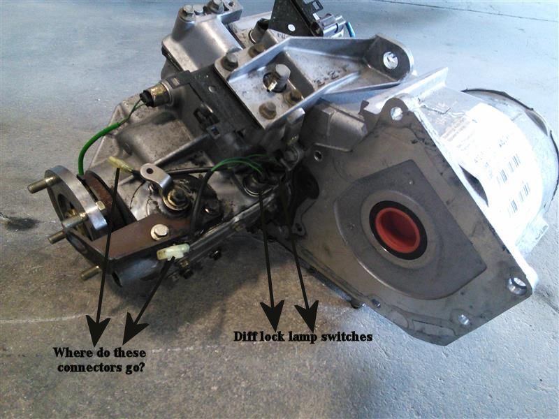

Alex,
I was wondering if you can help.
I had a shop replace the transfer case on my 2003 Disco to a 2004 transfer case. Unfortunately, they did not install the two diff lock switches as shown in the pics. I was wondering if it would be possible for you to tell where the two wire harness for these two diff lock swtiches get plugged into.
Would you have any idea or be able to take pics of the routing of these two harness?
Thanks!

Originally Posted by acg
Alex,
Thanks!
Hey there! I can try to get you some pictures when I install the CDL in my truck, but it will probably be a few weeks. Might be better off checking with someone like Paul Grant, maybe Erik from Lucky 8, or Dusty. They should know.
