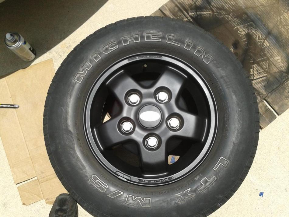

Here is the spare tire cover after 2 light coats:
Here is the spare tire I am about to paint:
Here is the center cap after masking and painting:
The paint is covering great - of course I am starting with a very clean base. PREP!
Old Aug 14, 2012 | 01:13 PM
JC Speiser's Avatar
Joined: Apr 2012
Posts: 103
From: Jacksonville, Florida
I forgot the pic of the whole tire!
I hate it when my job gets in the way!
