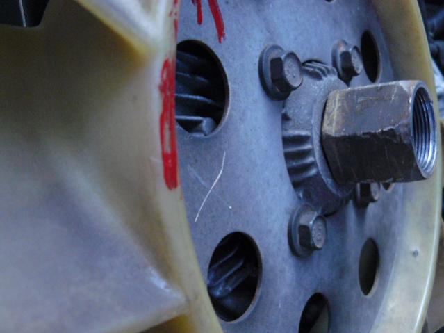

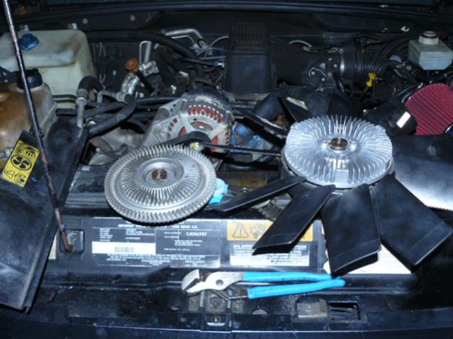

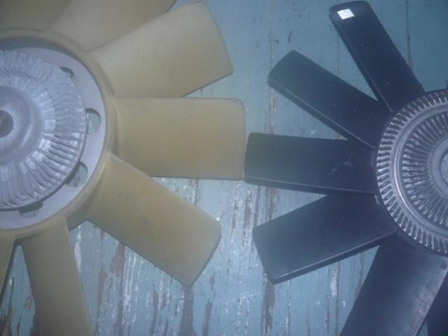

If you were driving at 40 mph or better, it is not just the fan clutch that was making you overheat. Fan only makes a difference stopped or very slow. So check out radiator as well. As stated, the Chevy / GMC clutches are also 6 inch, reverse rotation, and the same thread as our water pump. You will have to modify size of bolt holes on stock Rover fan. If you want to experiment, junkyard has cheap ones (more Chevys than Rovers in junk yards around me). Also good for low dollar emergency no-Rover parts available type repairs (get me home to my shade tree).
Attached Thumbnails Engine running hot-p1120218.jpg   Engine running hot-p1120262.jpg   Engine running hot-p1120258.jpg   Engine running hot-p1120268.jpg
