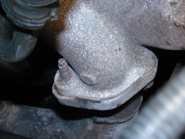

Many exhaust leaks take place at this junction between the manifold and the rest of the system, gasket goes out. Also bolts usually frozen, so it is not a good road side repair. See the small black smudge.
Plenty of people drive around with exhaust leaks. Now you'ld want to be concerned about the fresh air intake sucking it into the HVAC system, and you getting it in the sealed up passenger compartment. Crack open a window.

what am i looking at in that pic, its obviously the exhaust manifold but?

Yep just the joint between manifold and down pipe, silly three bolt gasket, you know the drill (or maybe PB Blaster the night before and no drill)... take a scanner so you can watch the coolant temp, the gauge is widely average. Expect temps 195 - 200 range. Noise like water rushing in pipes is bubbles in coolant going thru heater core. Lots of these have HG issues, could take a exhaust gas in coolant test for pre-sale check. New bolts and gasket set is about $300.
