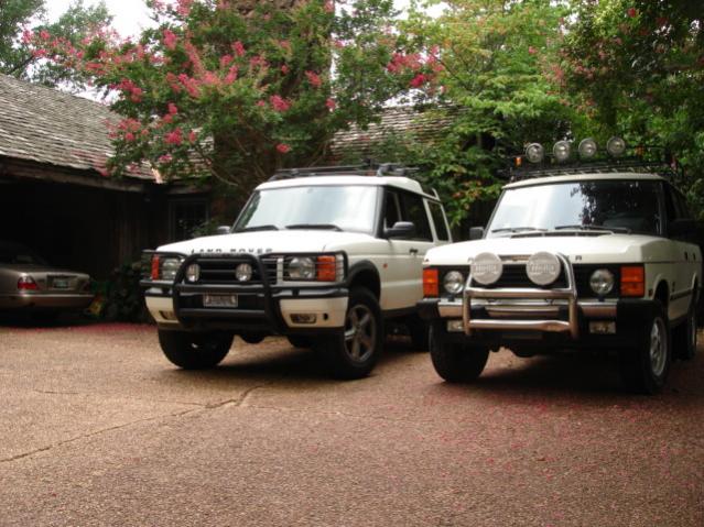

Hey, I think I bought the truck you are taking about!! is this it?
Attached Thumbnails Need help! Unfreezing brake system in 89 Range Rover.-dsc03259.jpg

His profile says he is in NH and you are in TN. Thats a pretty long distance to go for a '89 Rover that needs work.

Uh yeah... I had it shipped. Thanks for your 2 cents.
