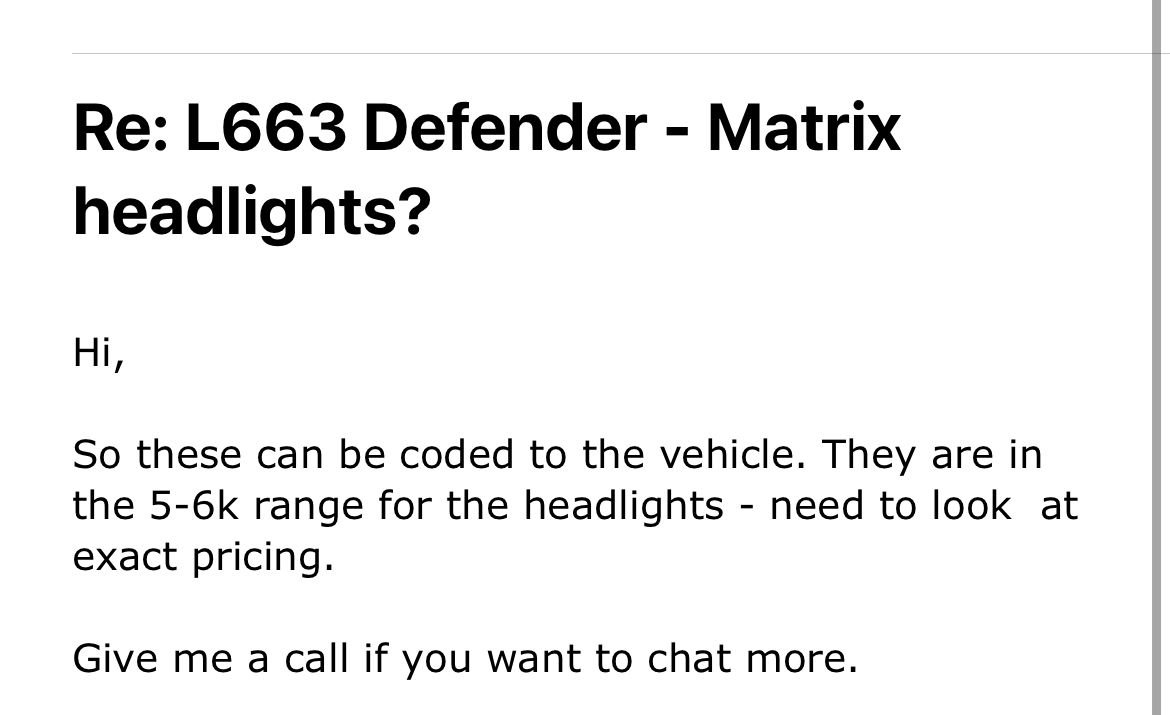

I am also interested in the Eurospec ballast/ matrix light upgrade.
I emailed @markjlr from his website. Haven’t heard back yet but will update everyone if he can do the programming.

… kinda want to do it…
from mark JLR…
