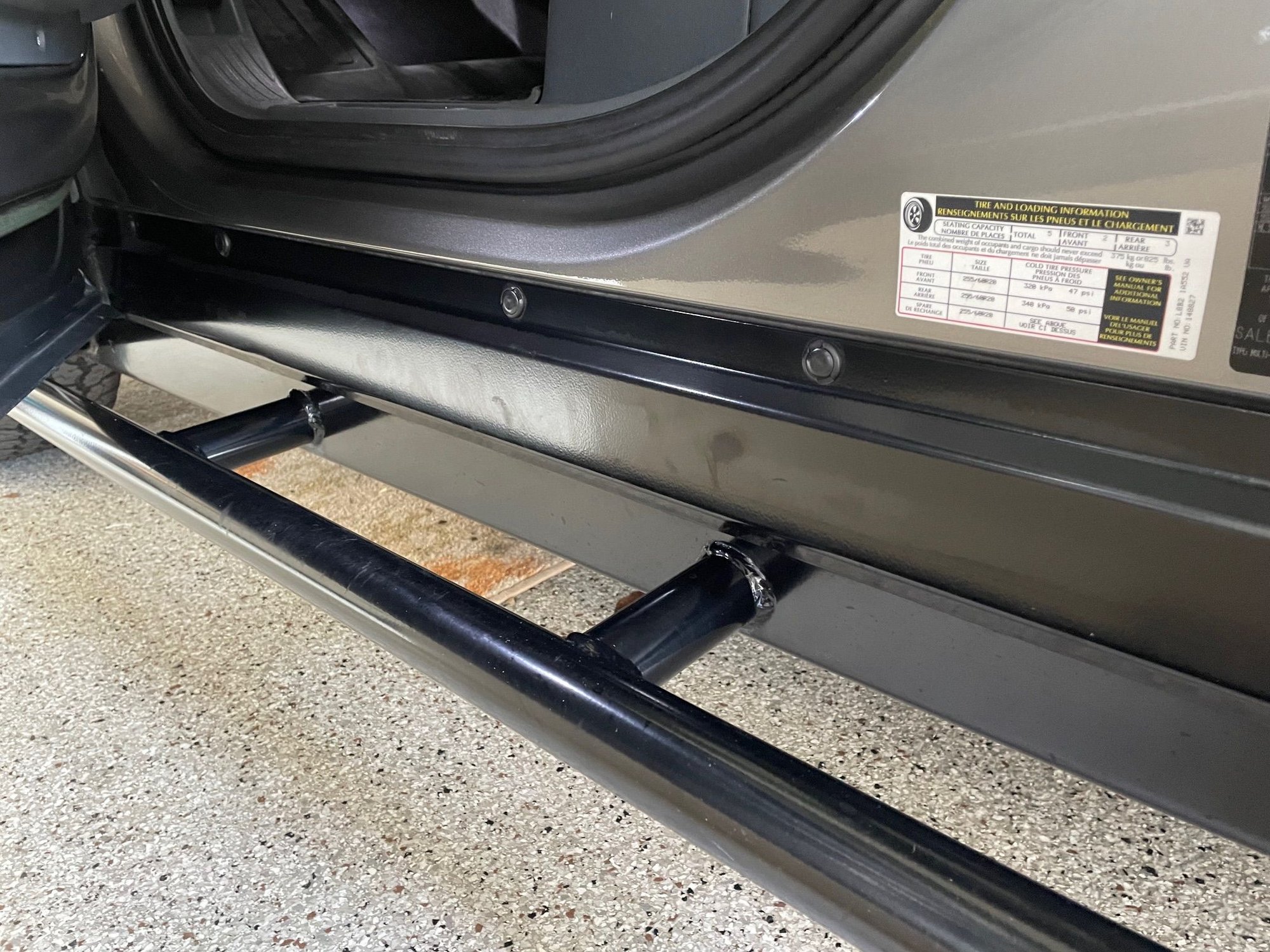

Resurrecting this thread for my new to me 2023 Defender. Had a 2020 model previously. The 2023 came with the Lucky8 sliders installed, including the flat metal sill plates.
Has anyone been successful in modifying the factory sill plates to work with the Lucky8 sliders? The Lucky8 sill plates were installed with plastic push in clips (I assume locally) instead of the supplies rivnuts. They rattle when you close the doors. I checked with Lucky8 and they are very helpful and sent me the necessary hardware to install the sills correctly even though these were installed by the prior owner. That will most likely solve the rattle issue. But I was wondering if anyone has reinstalled the original sill plates and how that worked out.

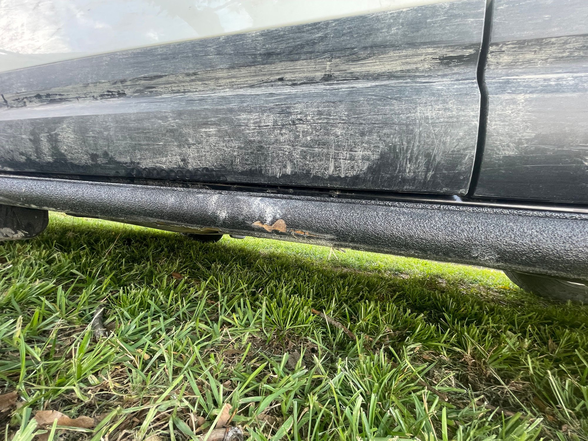

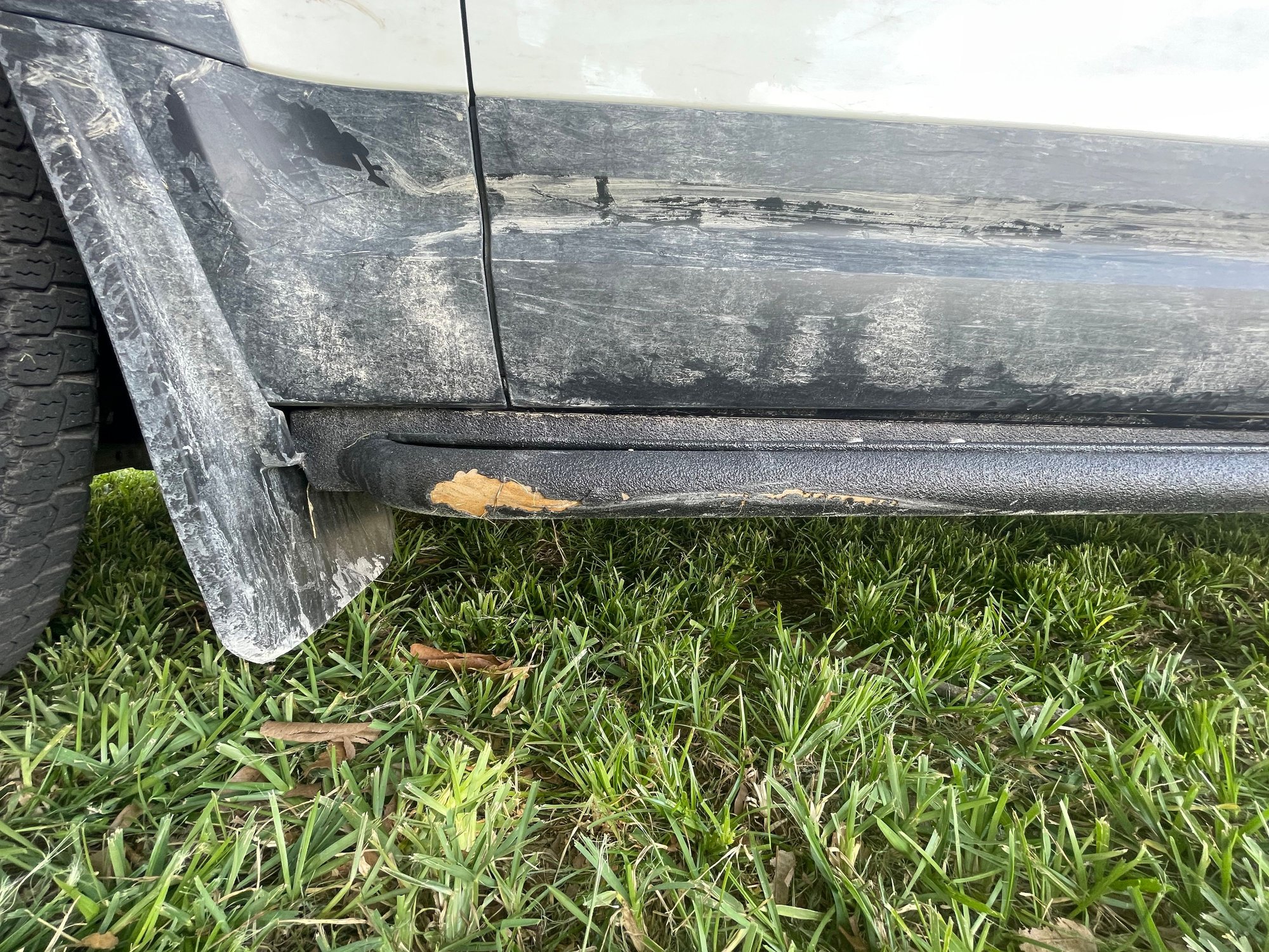

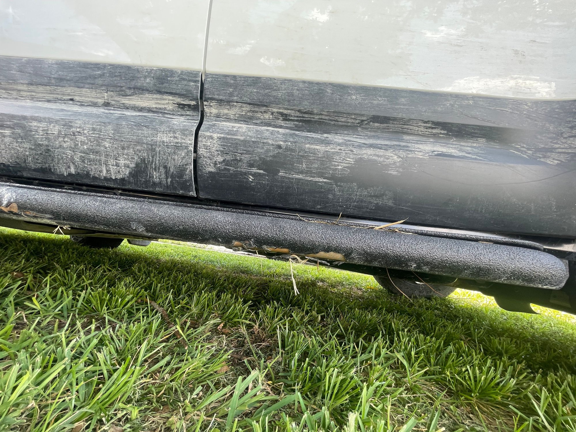

I used rivnuts for the sill plate. I would leave the sliders with the power coat and just line-X the inserts. If you line-X the sliders when you hit something it will come off, it is just too gripping to slide without ripping off the line-X .
