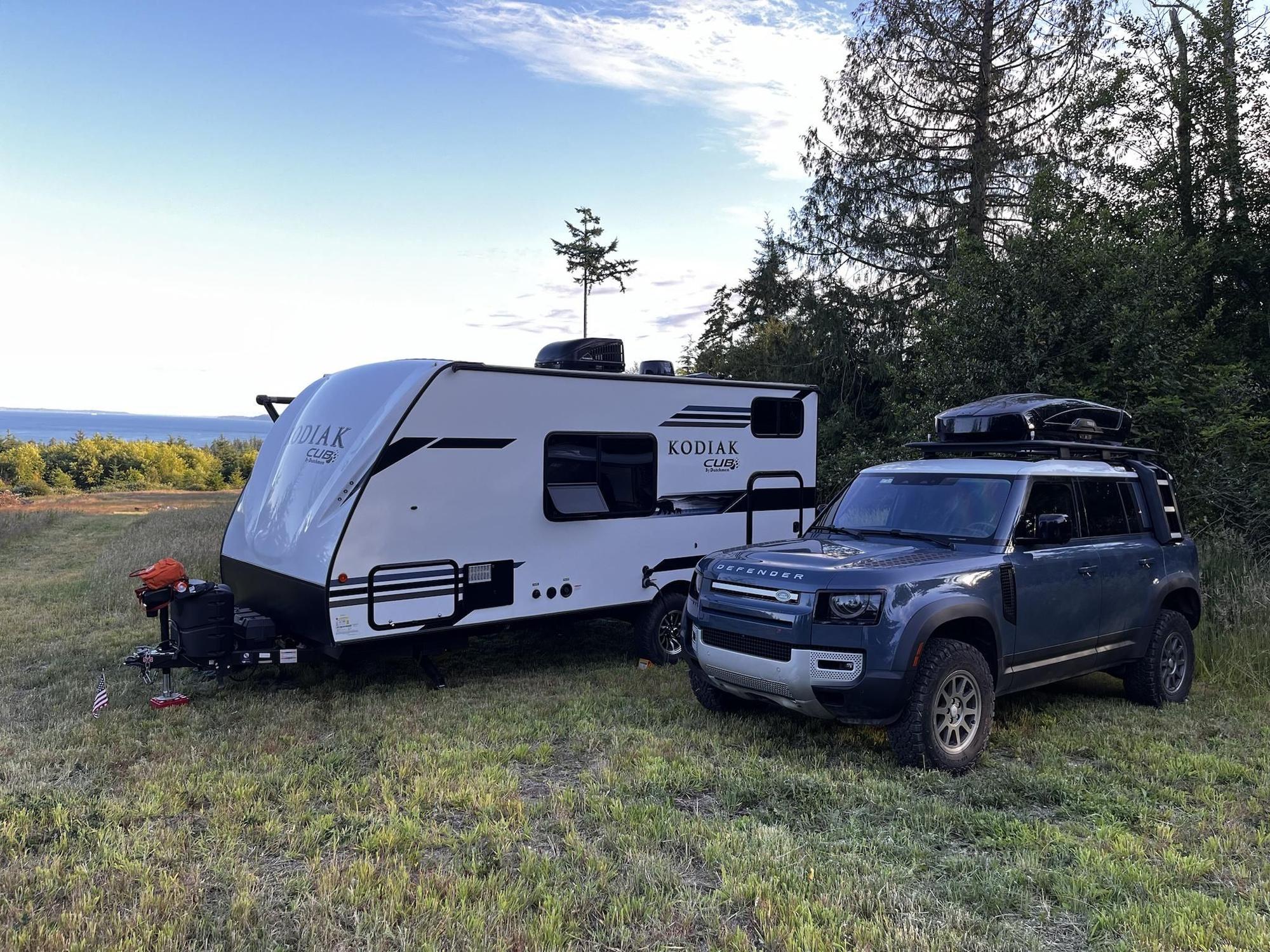

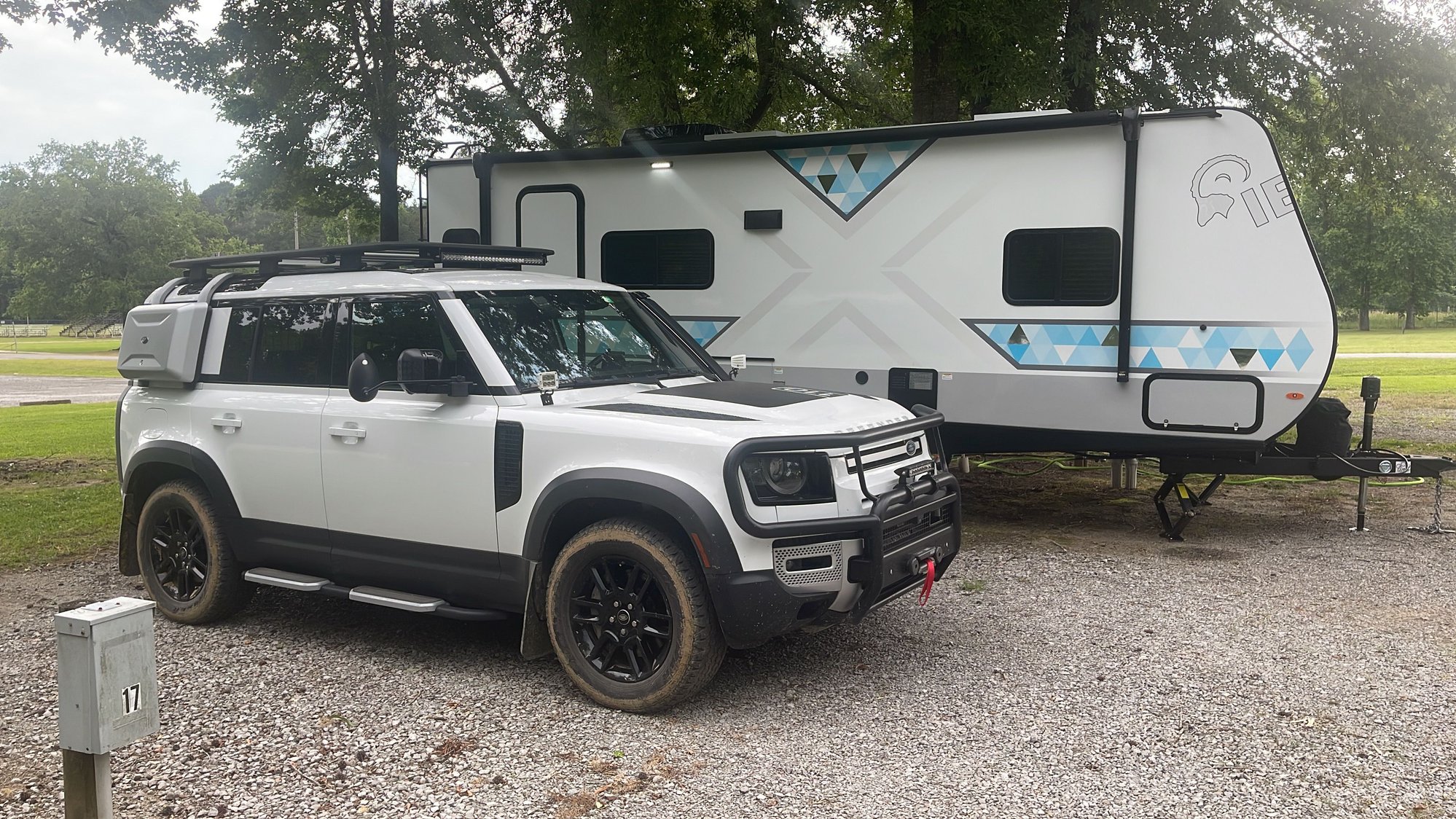

I use nothing and have not experienced any sway.
~5500lbs with this trailer
~6400lbs with this one

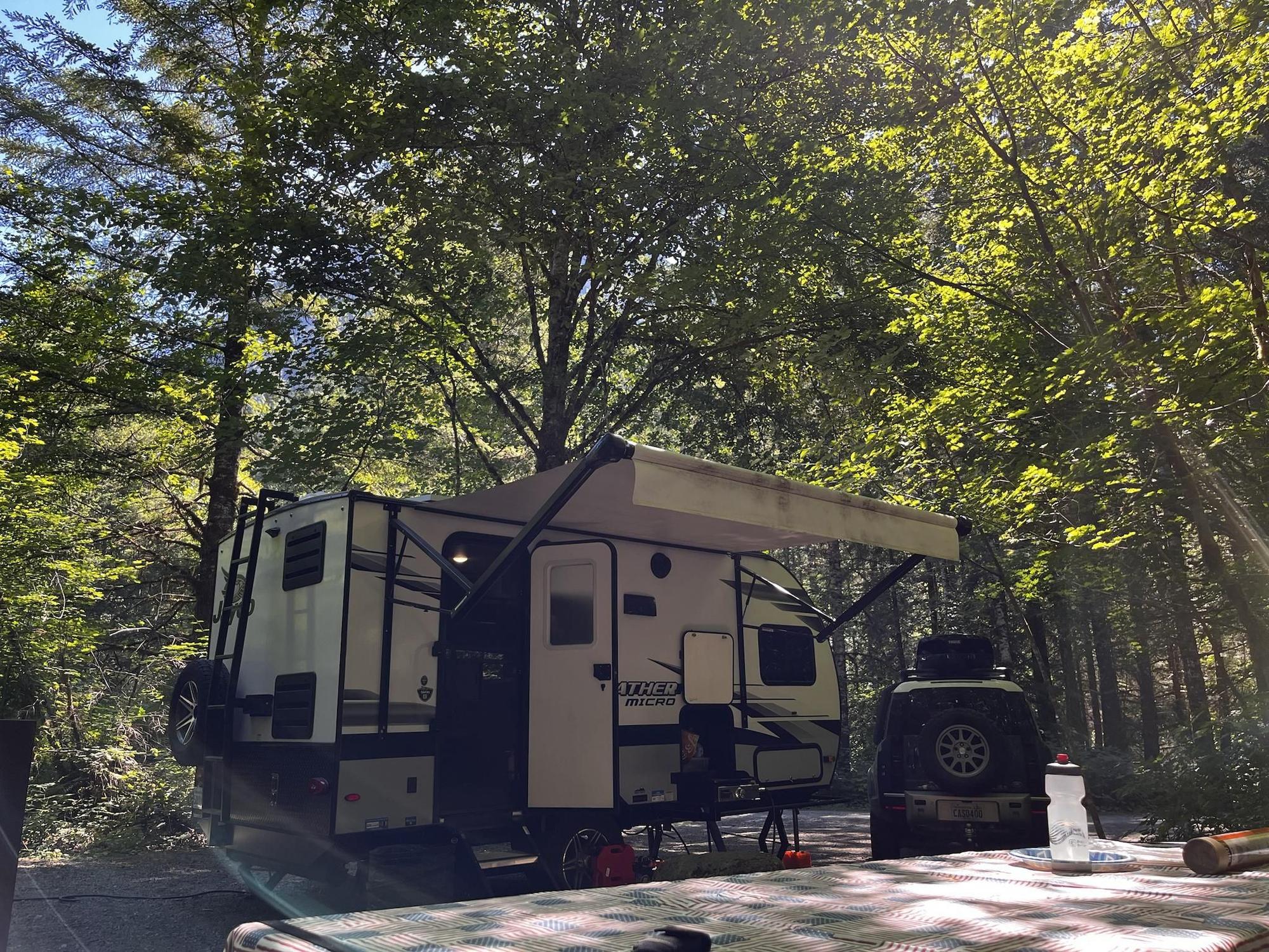

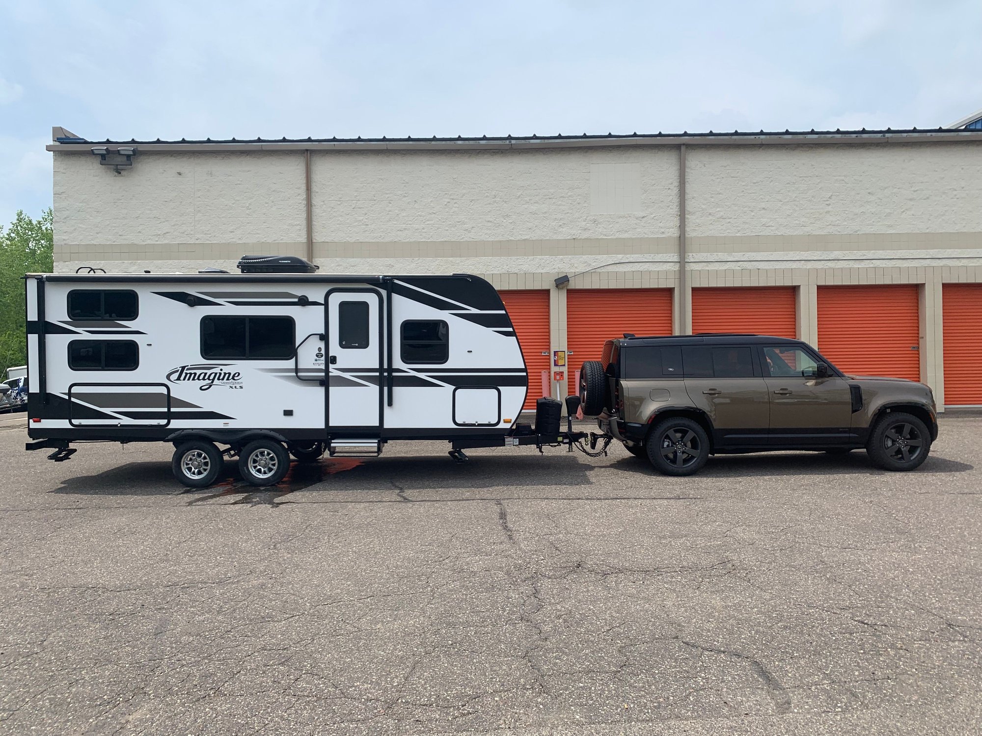

I use my P400 to tow a 6,000 lbs boat and 5,000lbs travel trailer. No towing issues to date. We use the below on the travel trailer, was useful on our MN to CA road trip with 2 kids and 1 dog in the vehicle.
https://www.etrailer.com/tv-Demo-Hay...n-HA81775.aspx
