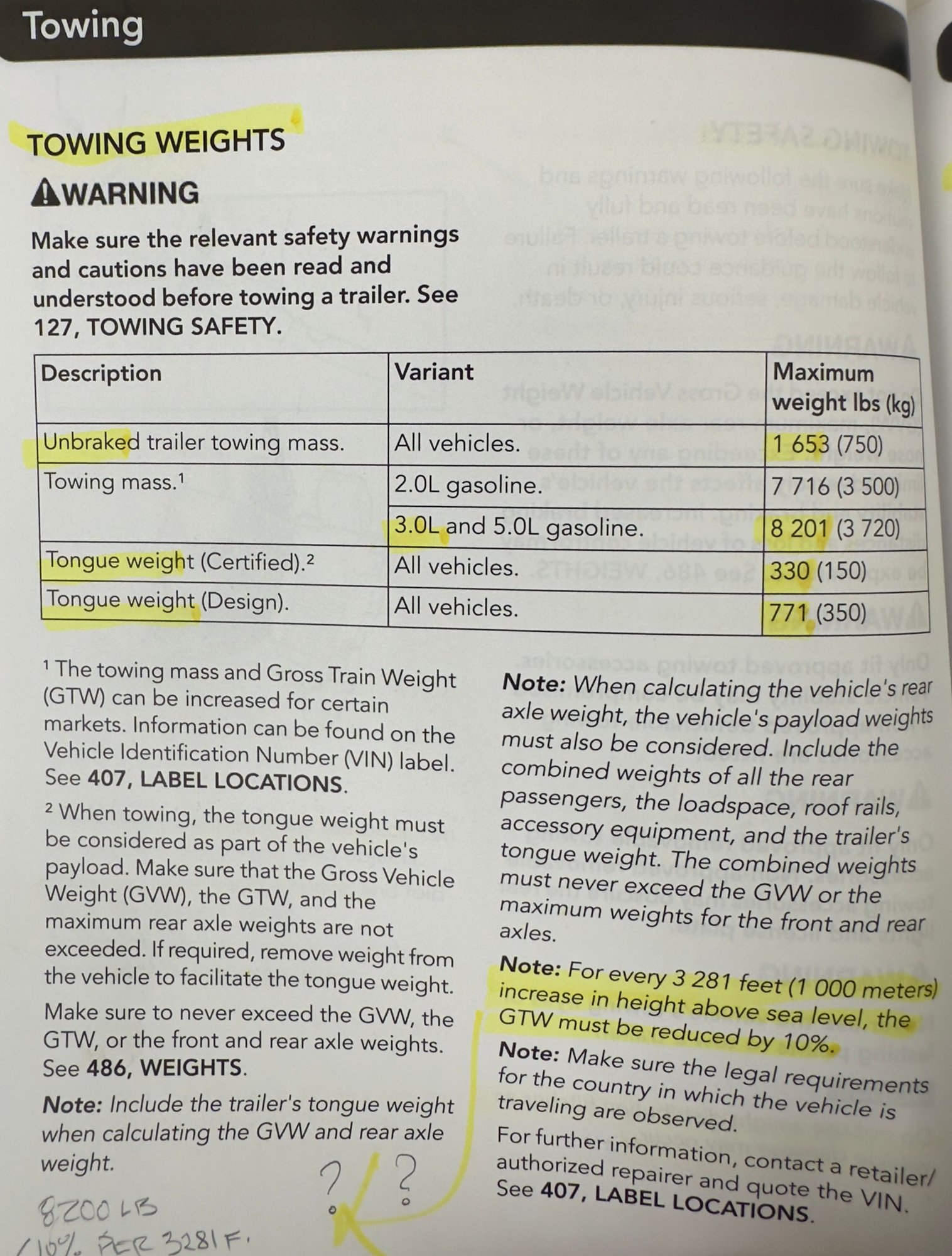

What is your tongue weight? I am looking at a trailer that has a dry weight of about 5500 but the tongue weight is about 900. The 110 has a stated tongue max of 820 but I am wondering if that is a hard number or something to balance with the overall vehicle payload. Will the extra tongue weight compromise the air suspension?
Where did you get that 820 lb number? My book for the 110 says all vehicles 330 lb for a tongue weight. That's the certified weight.

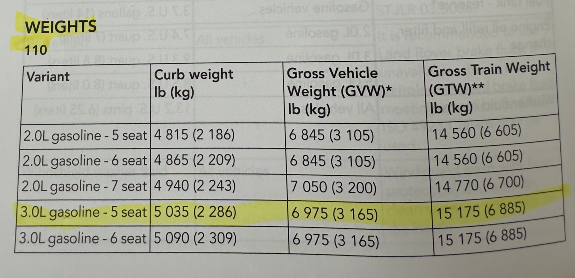

The manual has an excellent breakdown of certified weights as photos attached. There may be some nuances based on model year. With my 110x and air suspension I find a better tow condition with a heavier vs lighter tongue weight - my estimate is around the 400 lb mark or slightly less but I haven't had it formally measure in a certified scale.

Yep, that's where I got the number from. In my line of work, the 771 lbs would be a safety margin that the hitch was designed to, but it is not meant to be used. There is a certified weight and a design weight. Do you know how LR uses those terms? I did run across a blurb on LR's side suggesting that 330lbs is the capacity without overrun brakes. So then it occurred to me that this figure is posted as "certified" because the Defender does not come with a brake controller from the factory. Thoughts?
Your logic seems reasonable and makes a lot of sense to me. I was surprised when ordering my 110x with all the trailer towing options that a brake controller, or choice of a controller, wasn't an option. Even more odd is the tow capacity of the LRD is high enough that some type of brake controller is a requirement (at least in North America). Not a surprise that JLR really missed an obvious opportunity here to provide a more comprehensive solution, albeit I'm glad I was able to specify my preferred brake controller that may well have not been a standard option.
