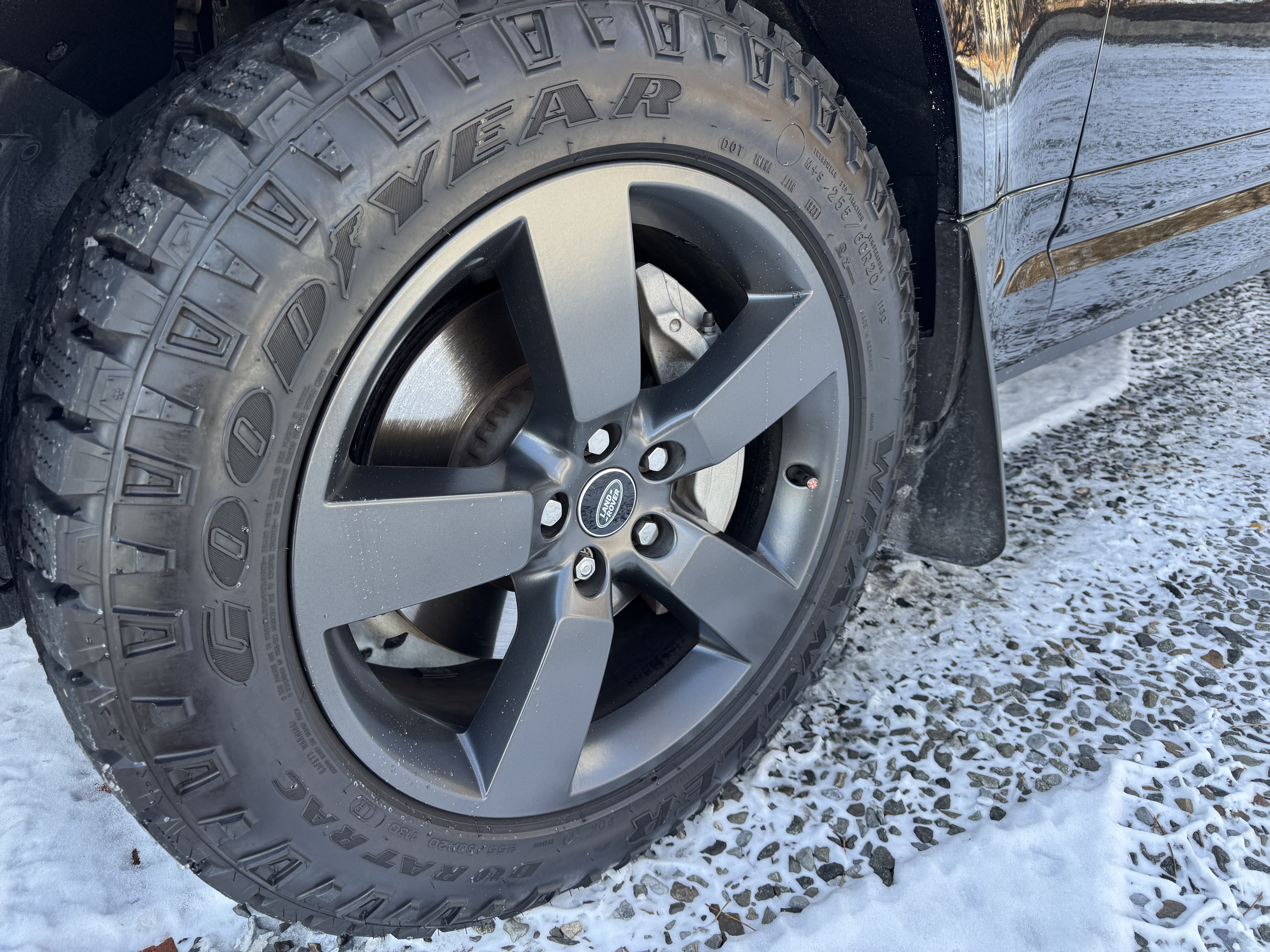

I suffered through the supply-chain issue of not getting the truck tires I ordered for my 2023.5 and kept the "touring tires" until 32k miles. In one foot of snow up in Mad River Glen, VT last season on Palm Sunday 2024, those tires left me stranded in the parking lot! Fortunately, my kids saw the value of good samaritans and we got out, tow straps, shovels, and an old Ford F150!
...but, here's what I did for tires this past Fall 2024:
Wrangler DuraTec DLR 50k (255/60R20) - after a lot of research (and BTW using a local shop, not the dealership)
I have been wildly impressed even driving normally on the highway, as the truck even seems more stable at higher speeds even in windy conditions (>15kts.) They also look really nice too. We got through >12" of snow this past Thanksgiving (2024) up in Killington, VT and never thought about getting stuck again.
PS: snow shovel and tow straps are necessary regardless!!
