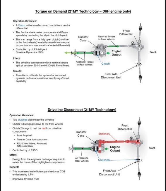

The 2023.5 and up models do have a front axle disconnect and can operate in 2wd mode. It's called iAWD or something in marketing speak? (I could be wrong about what they call it, but someone gave it a name somewhere).
Read Sarek's post #9 in this link, I think of anyone here he has explained it best several times to us plebes --> https://landroverforums.com/forum/20...system-124024/ In summary: the position is that it is an improvement to the vehicle for several reasons, and an overall advantage offroad. For example, on the 2020-2023 system, f you break a front axle, you lose all drive and are stuck. On the 2023.5 system, if you break a front axle, the system goes into rear wheel drive mode and you can carry on -- which makes total sense. Advantage, 2023.5 system.

I have been waiting for this type of scenario to pop up as I think it invites a good discussion about the 23.5 hardware changes.
However, I believe this assumes the software and hardware is operating properly. As in this case, the car has a gremlin/problem // something is NOT operating properly. The Defender has now lost AWD/4WD. Which then makes this front axle disconnect a clear distinct disadvantage... the guy can't even get out of his driveway in light snow or whatever perhaps because he's in 2wd mode for no reason whatsoever ? And thus, the new system when not working properly is a total disadvantage over the mechanically linked system of the earlier models, which would easily figure it out.
Good food for thought?
@sarek would love to hear your thoughts. You know way more than all of us combined surely.
This tech isn't new, its been around for decades, and as I said, it is essentially the Instinctive AWD system developed by LR engineers for the Jaguar brand. I LOVE the tuning in Jaguars. You can still act an *** and slide around, as the system is smart enough to figure out if you're purposely trying to slide, it will send more torque to the rear, let you do a power slide, but still sending a bit to the front to keep everything in check. Last week I was in an F-Pace loaner, and we got some snow. I set Jaguar Drive Control (JDC), Jaguar's version of Terrain Response to Rain/Ice/Snow and the car was rock solid, even on the UHP all-seasons that were fitted. Rain/Ice/Snow honestly felt a bit more stable and linear than Grass/Gravel/Snow because everything was working in the background so quickly and seamlessly, I was shocked. Zero traction issues. I also feel that the Rain/Ice/Snow was tuned more for inclement weather and on-road use compared to Grass/Gravel/Snow, which is tuned for slippery surfaces on hard ground. Plus, when this mode was selected, the front driveshaft was always engaged, as evidenced by the menu on the touchscreen that shows the torque split in real-time.
LR tunes the system differently, as they tune it for off-road capability and traction. LRs also have the option of the two-speed transfer case. As I stated above, AWD is always activated when taking off from a stop, under 21 mph, over 100 mph, when you're off-roading or have TR set to an off-road program. It proactively engages at temperatures below 37°F and if your lights and wipers are on. It also monitors steering/braking/throttle inputs to proactively activate AWD if deemed necessary. As @sarek said, it is beneficial if you snap your front axle, as you always have torque being sent to the rear and theoretically make it home. I don't go on trails extreme enough to where I'm worried about snapping an axle, but I'd rather have the new system in that regard. You also have the benefit of better fuel economy from the Active Driveline, but fuel economy isn't a priority for people buying these cars. The variable torque split also can help when off-roading by sending the right amount of torque to the axle that needs it the most, and theoretically works better with the ABS and TC to always find traction. You do miss out on the center differential, but the electronically-controlled clutch pack acts just like the differential and should be able to react even faster.
I'd like to see a comparison of two identically-equipped Defenders on the same tires, but one with the old permanent 4WD system, and one with the new iAWD. I'm sure the difference off-road is negligible, but still would be interesting to see.
I also wanted to add that on the new system, if there's a fault with the new AWD system, the car will default to RWD until the fault is clears on its own or gets fixed. This in turn could cause the driver assist tech to be inoperable, as the driver assist tech is interlinked with the powertrain/drivetrain.
