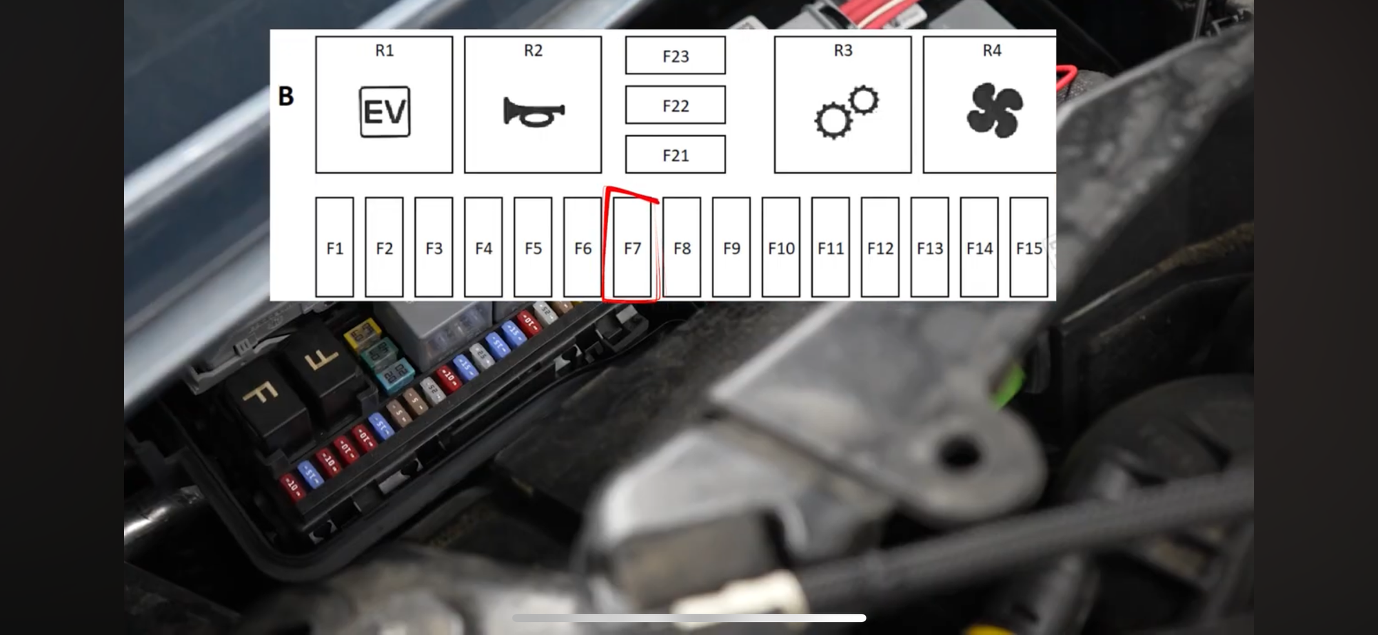

At about 15:30 in the linked video they show the fuse setup. I have also attached a pic.
Hmmm. Just watched the video of the installation provided by Hunter Prestige and the reason given by your dealer makes no sense as to the cause they claimed. First, a simple fuse tap was performed. Their explanation that “a 10 amp fuse was removed and replaced with two 10 amp fuses” is not exactly accurate, as they phrased it. The original fuse was still protecting the source, as it was all along. The fuse tap was merely ‘borrowing’ power from that supply to power the grill light. The grill light, being LED, most likely has such an insignificant power draw so as not to interfere with whatever component the original F7 fuse was protecting. These fuse taps are utilized all the time and should have no bearing on your related problem. Second, I’m sure this is not the first LED grill light that Hunter Prestige has sold, or has been installed in their market saturation. Otherwise this problem would have cropped up in each and every previous installation and we would have heard of this as a recurring problem with their product. Not knowing who did your aftermarket work, is it possible that they used a fuse other than the F7 fuse as specified by Hunter Prestige? If everything was done exactly as it was done in the video, then it would lead me to believe that the dealership executed some software fix/update and is using the ‘aftermarket’ work as being the root cause. And they love to pin the aftermarket work on the owner, thereby releasing them from doing it under warranty and placing the cost on you, the owner. Most warranties cite any aftermarket work as absolving them from responsibility for future problems. Even changing tire or wheel size from the original build gives them the excuse they need to blame engine or transmission problems as being caused by inordinate stress on the drivetrain by going outside of OEM specs. Just my hunch.
