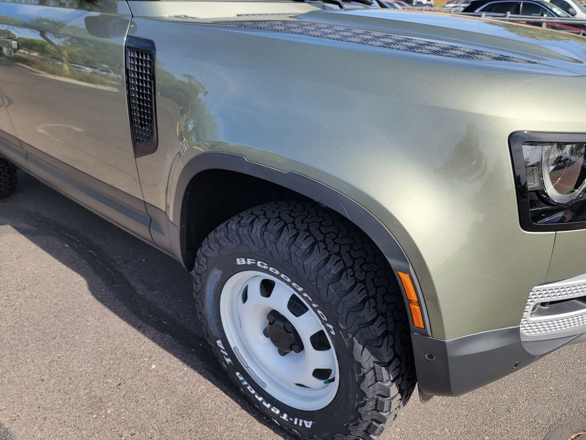

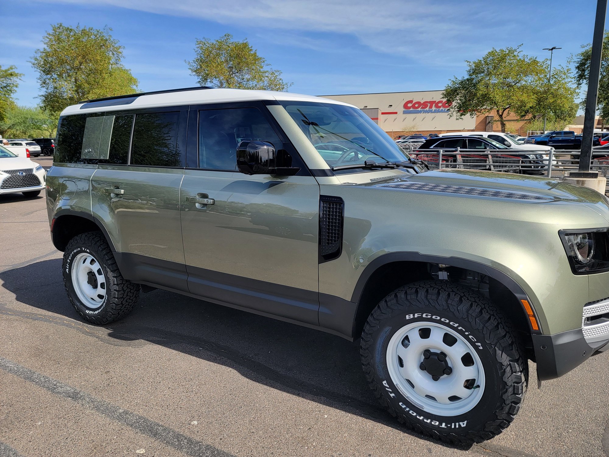

Well Gavin pushed me over the top. Thanks for all the input everyone, it was very helpful. In the end I had the 265/70r18 BFG KO2s put on at Costco. They tried to talk me out of it and said it would rub and that I can't lower it out of off-road height but that's not true. No rubbing at full lock in access mode.

They do look good - especially with the raised white letters and white steelies

White letters, white steelies, white roof.

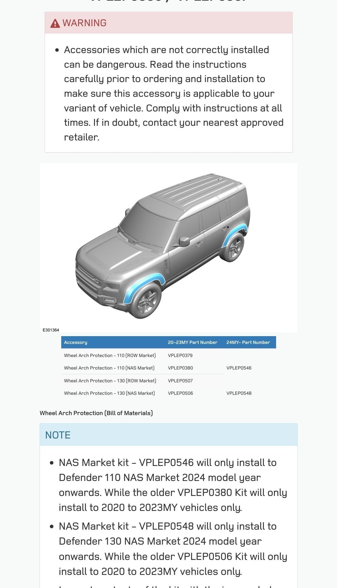

It's currently getting PPFd with Xpel stealth but as soon as it gets back I'll post some better pics. I got the wide wheel arches but apparently they don't fit the 2024 for some reason.

That's very strange they don't fit. I thought there was no change in the 110 for MY2024 and the 110 wheel arches fit all 110's. 130's are a different story and 90's have their own too.

I know! It's strange. I haven't heard back from Rimmer Bros yet, just emailed them today as I already received the wide fenders. If they don't take them back I guess we may see what the difference is.
