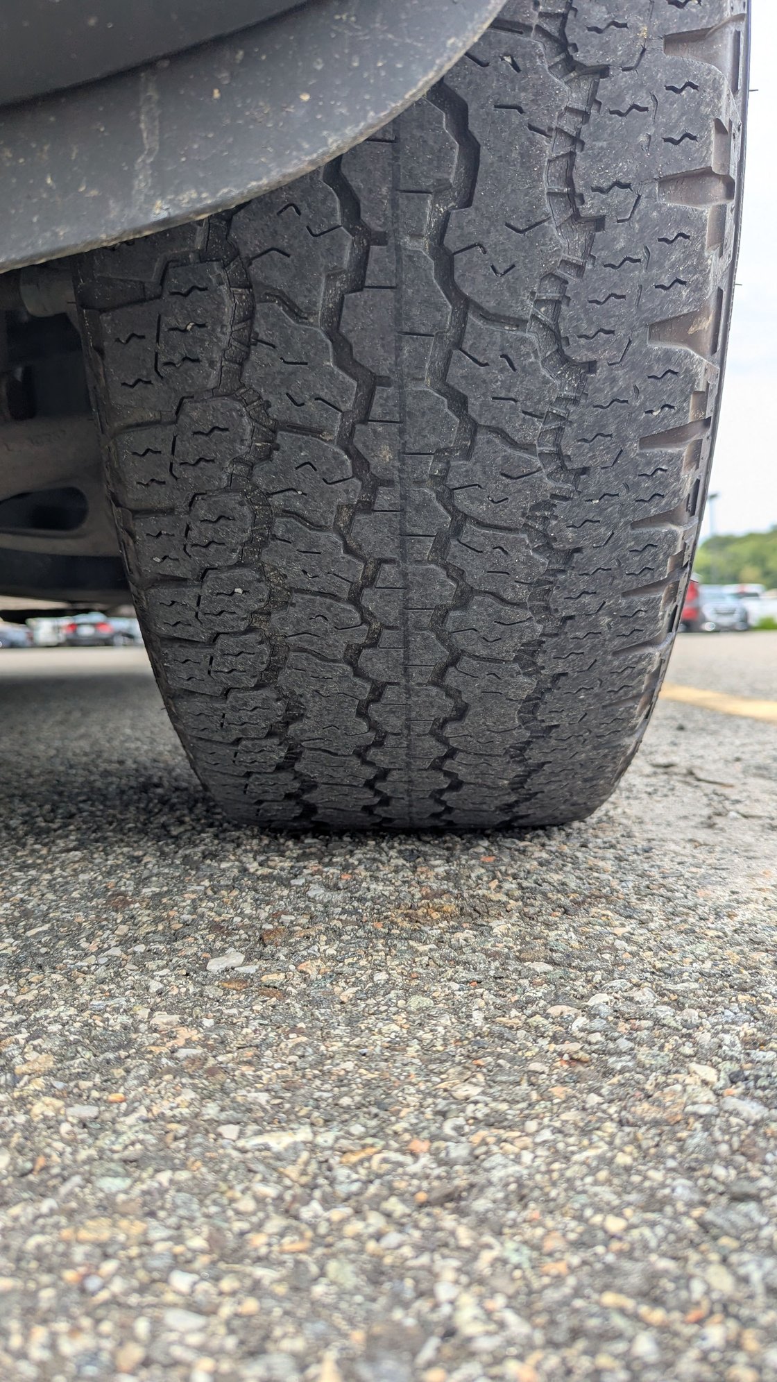

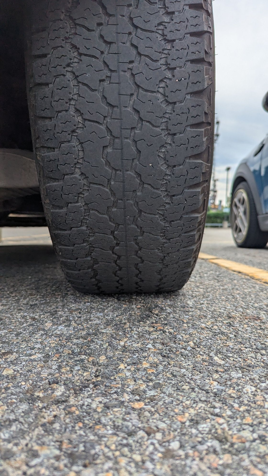

Finally, based on the tires wear attached below, do you think I actually need alignment?

No, you'll have to set the suspension to tight tolerance mode. Locking in access height won't work. Your tires appear to be wearing evenly - is your car pulling to one side or is the steering wheel off center when going straight?

No, the vehicle tracks straight and the tires seem to be wearing evenly to me. Thanks for confirming that. So maybe I don't have to do the alignment after all then.
